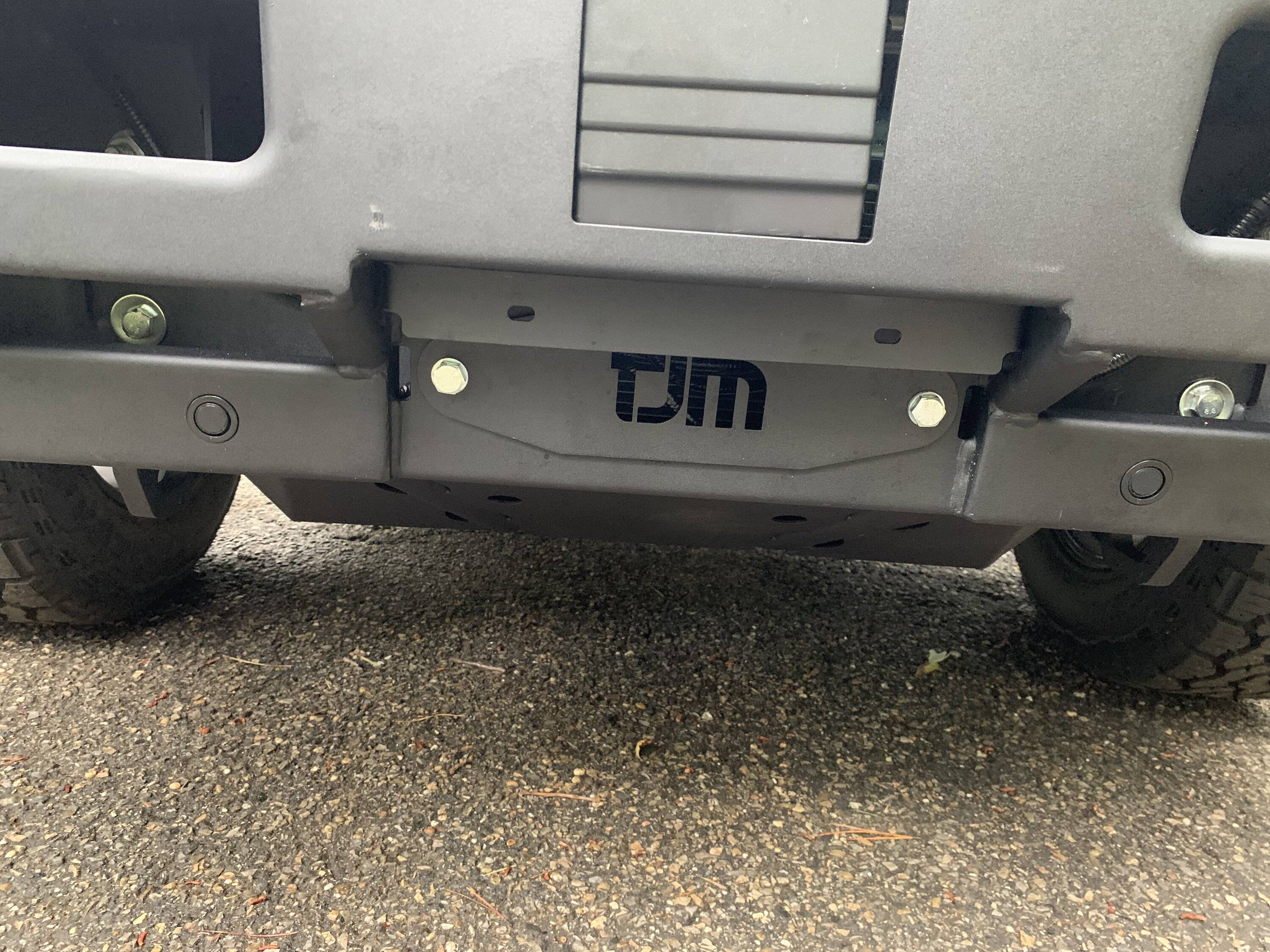

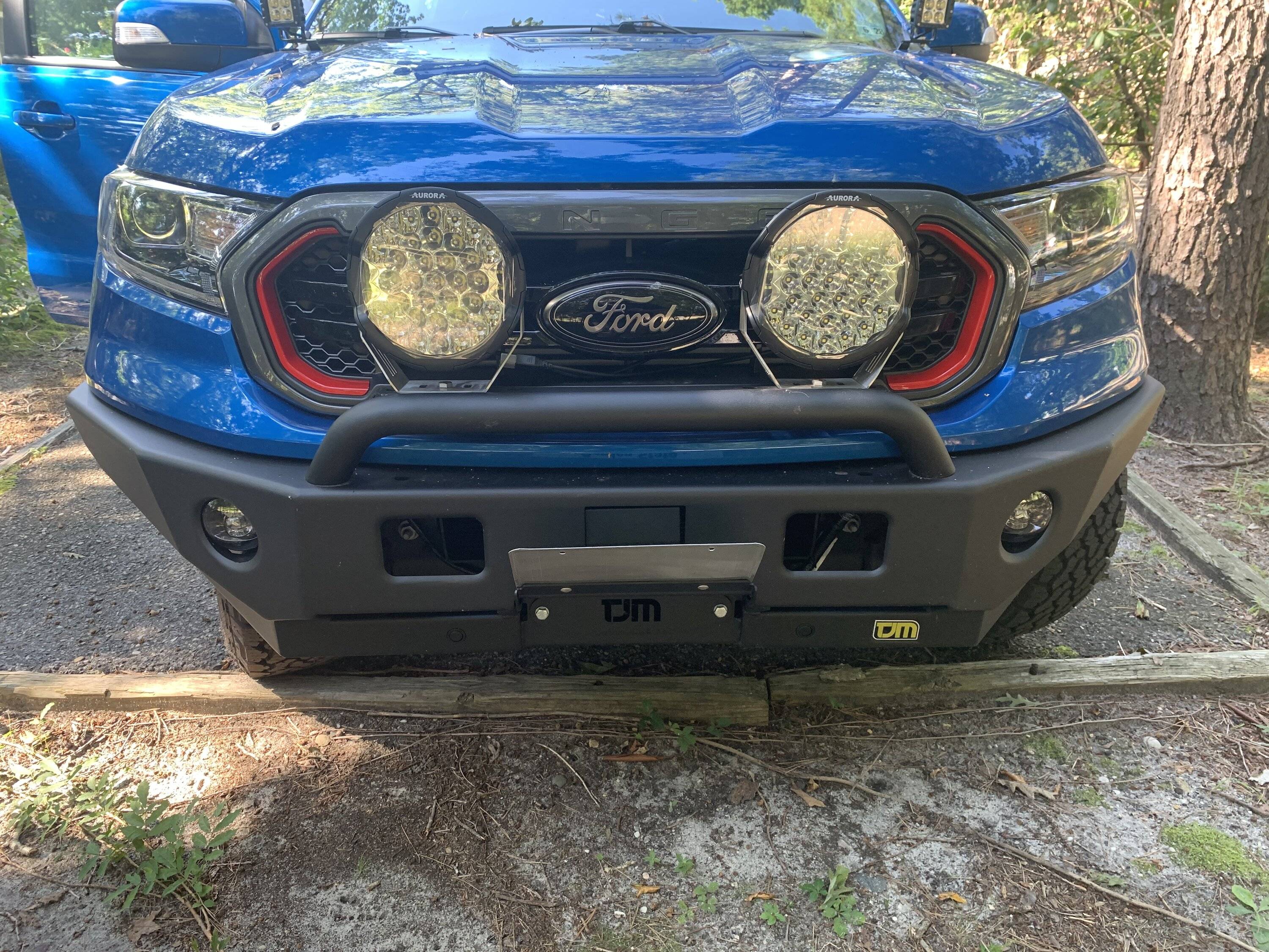

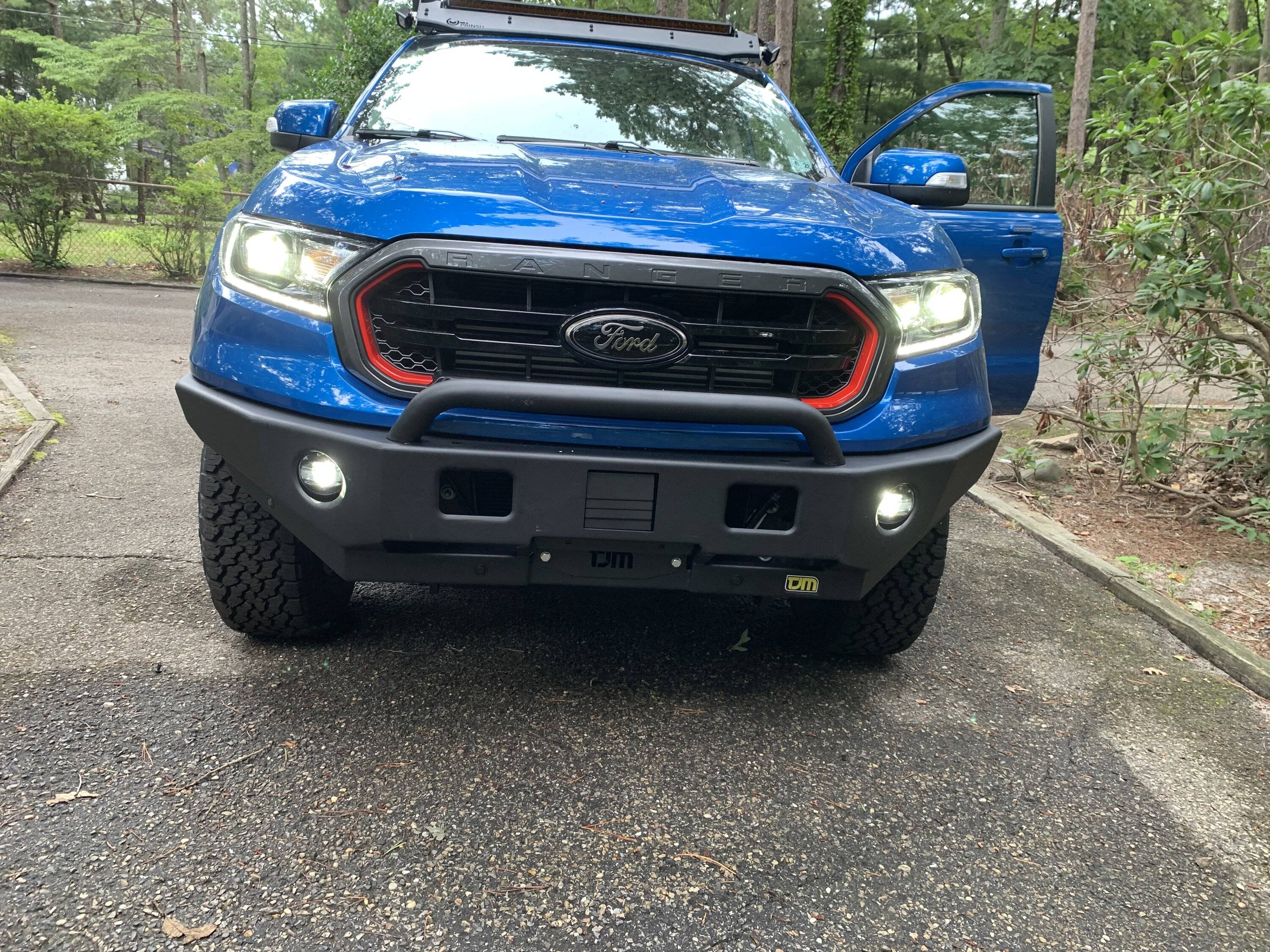

Here’s a pic of the TJM winch bumper on my Tremor.
I feel this is missing the lovely Grille Guard Attachment. Without it I feel it isn't right
