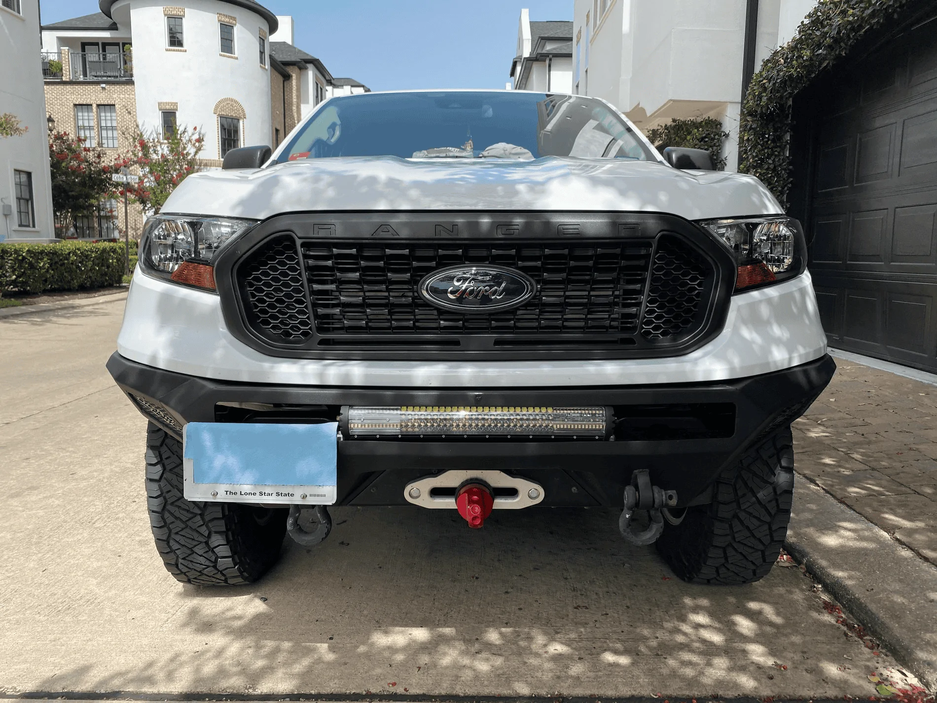

With that mount and without the bar over the top, it looks like the ACC module would be just fine and not even need to be relocated?
I don’t think so. It’s easy to relocate, I’d go that route.

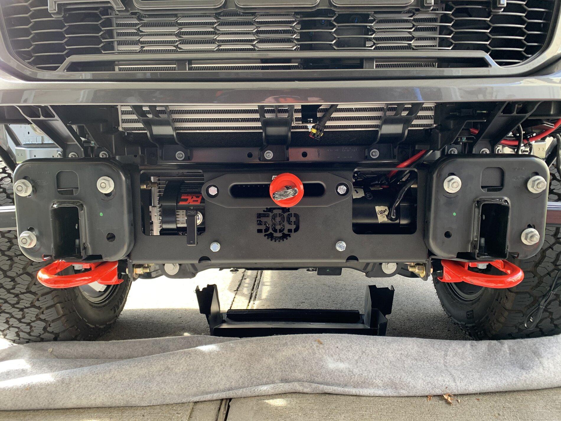

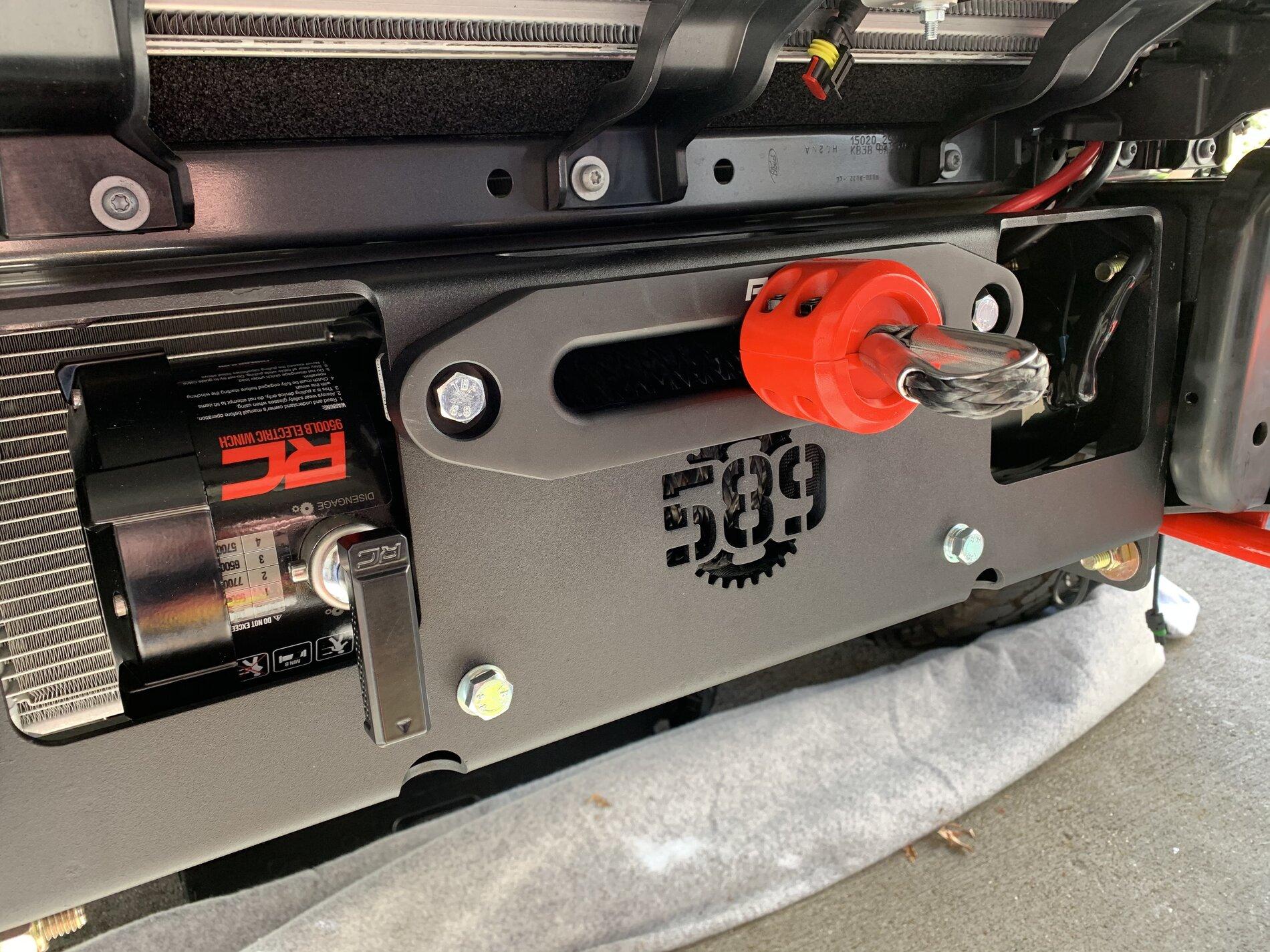

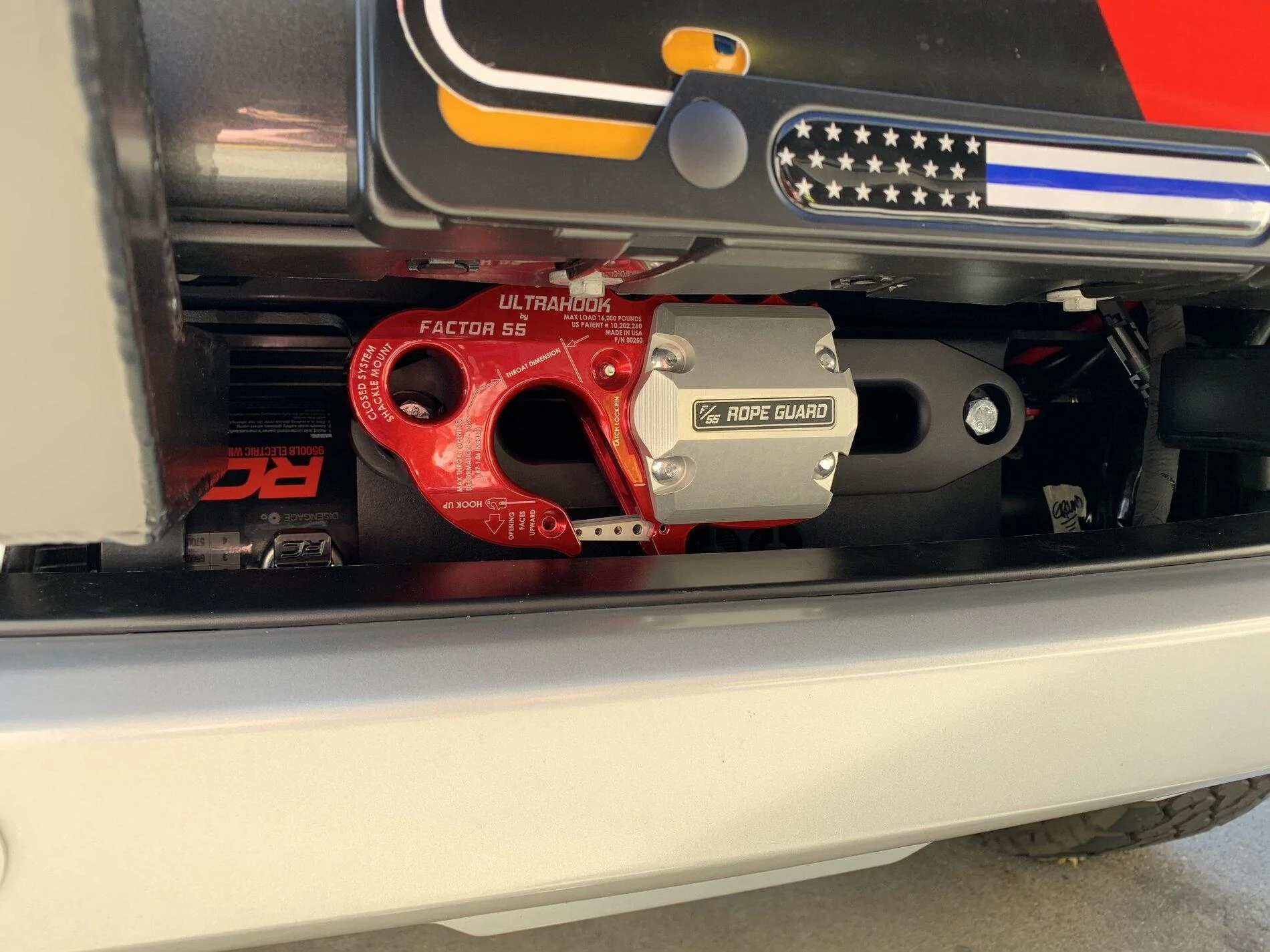

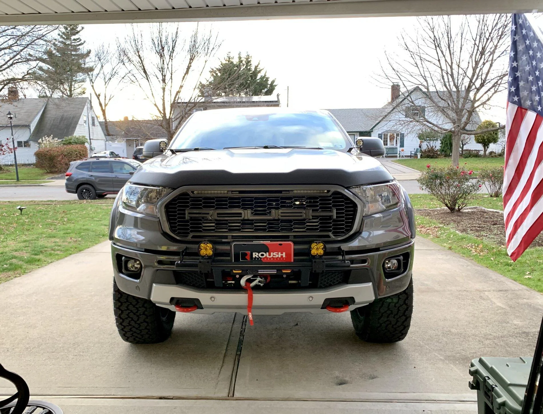

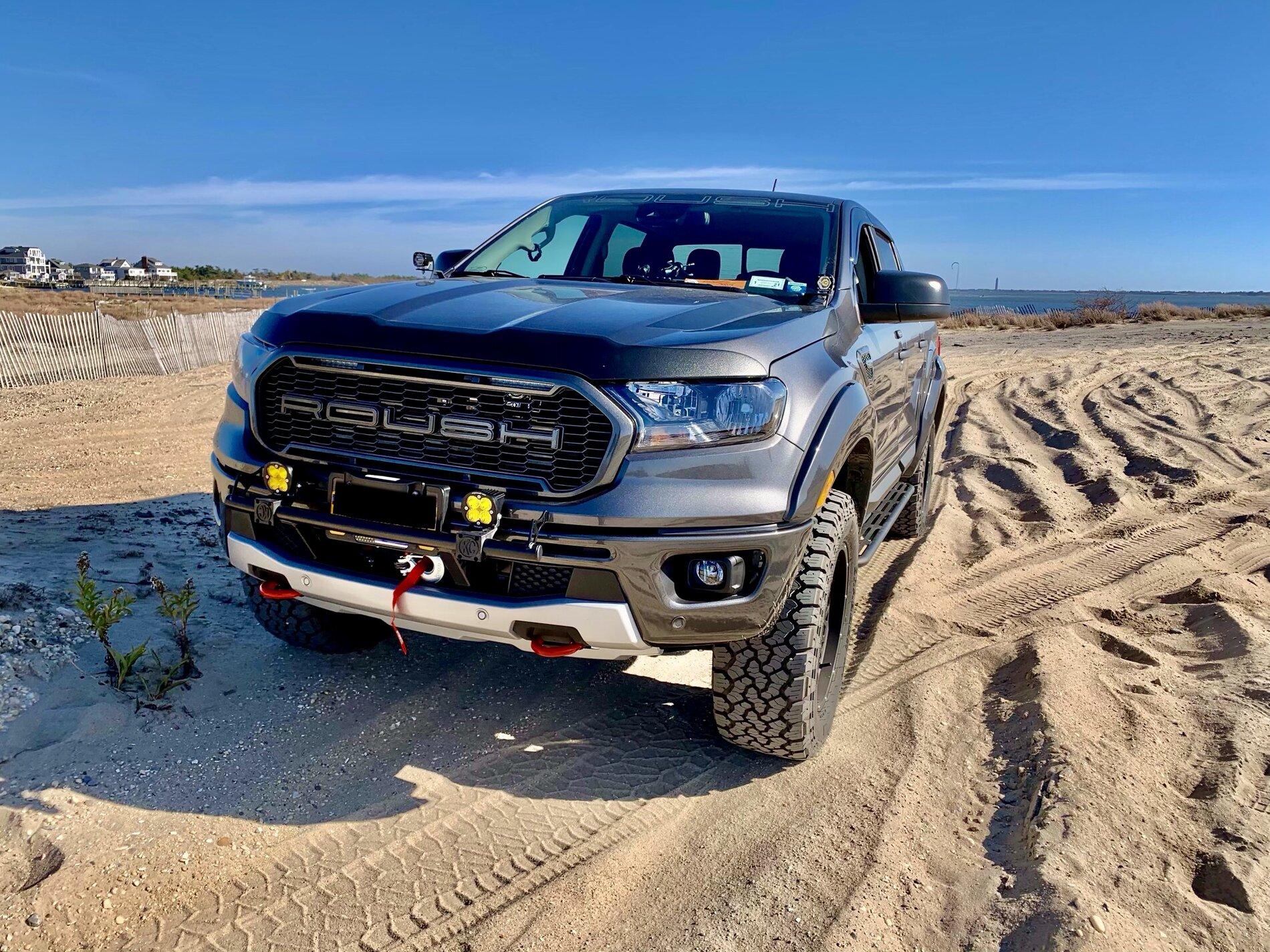

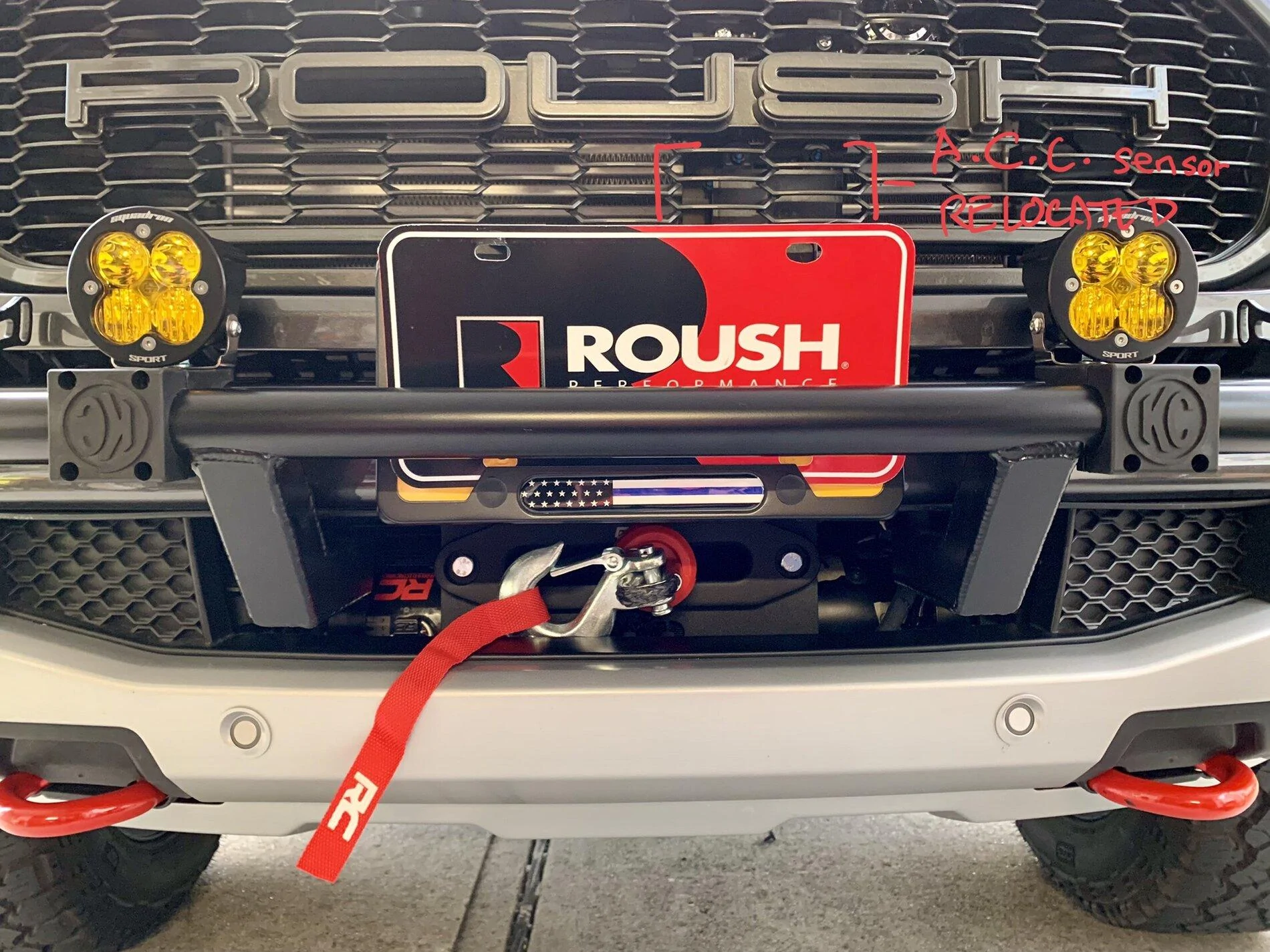

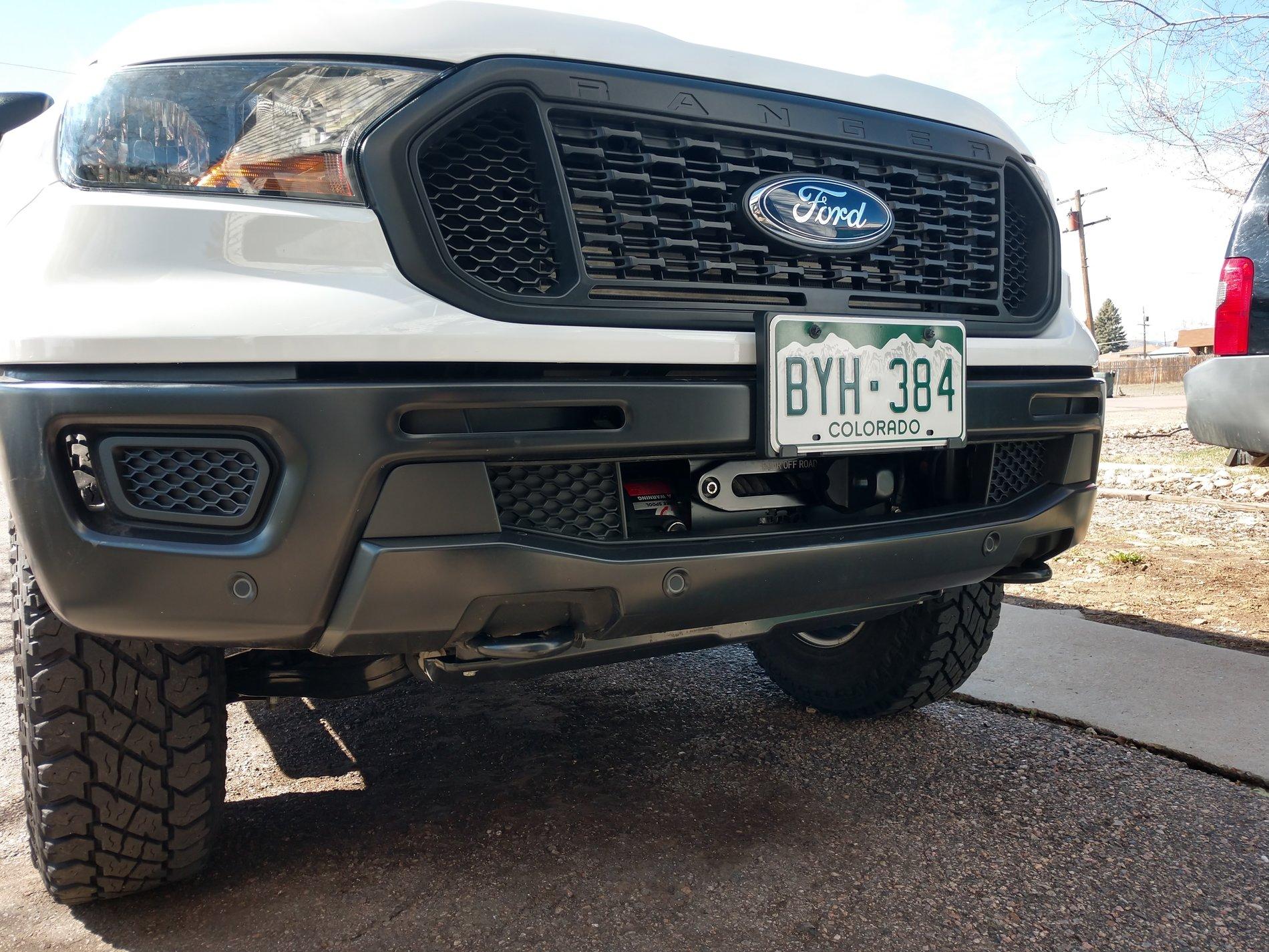

I have the @589FAB hidden winch mount similar to @RoadBoss.
Very happy with it. ?
(my goal was to keep the mostly stock Roush Ranger look)
The only thing I did different is that, I added @SVC Offroad light bar and I also re-located my ACC sensor using the stock bracket:
https://www.ranger5g.com/forum/thre...cc-sensor-relocation-using-oem-bracket.10171/
ETA: No issues with accessing winch clutch lever, ACC and parking sensors all works as it should.
That looks great. I have the same winch mount on its way to me now. Was it difficult to install? Require any special tools or cutting? How did you manage the power on/off? I'm mulling options but would be curious to hear your experience.
KnightRanger
Mar 23, 2019
329
1,070
USA
2020 Ford Ranger, 2016 Harley FLSS,
It would be better and quicker if you have a 2nd person to help.
(my son helped when I needed someone to hold the mount, and in putting oem bumper back)
As far as tools...
A good floor jack, with a piece of flat 2x6 wood at least 2-3ft.
I have several sets of SAE and metric ratcheting wrench. You def need at least 2 (one to hold bolt in place, and one to tighten).
Also, I used an oscillating tool with a multi cut-off blade. It made it easier to trim the plastic inside. (it would make sense, once you start mocking up the winch mount, it would hit the plastic trim on each side, and you would know how much or how little you need to trim)
As for power, It would depend on the winch you ordered. You have to figure out how much wiring to add, if you need to relocate the controller.
I ended up ordering/using a Rough Country 2 gauge winch lead wires set. (so together with what came with the kit, it was enough wires for the control box relocation)
Routing the wires is a Pain, because of the thickness. Take it slow, be patient and Good Luck!

That's really very helpful, thanks. Did you fuse the line at all or develop done way to energize/deenergize the winch when needed, or no? I'm leaning towards no fuse, there's nothing to protect, it just adds a failure point in a system that, when you need it you really need it not to fail. But if there was a super chonky 500A toggle somewhere, I don't dislike that idea. How did you go about it? Just leave it energized? I think I'm learning this is the most common method.
KnightRanger
Mar 23, 2019
329
1,070
USA
I just make sure engine is running, prior to using it.
(It could drain your battery)
As far as it being energized/On, it would only engage if you attach the wired switch to the controller, so its not really On all the time.
I have used several winch brands in the past. (back in my jeep days)
Have not seen one that required a fuse or breaker with the install.
But saying that, I do have an Auxiliary power box, which provides protection for my aux lights, compressor, etc. It wont handle that high of an amp that the winch requires, so a dedicated high amp breaker would be ideal.

I didn't change the whole bumper, but I installed the 589 fab hidden winch mount in the factory bumper.
if you're just simply looking to install a winch I think this is a great option.
if you're looking for a style change as well, then this is not an option.
I like the stock bumper. Do you have a link for the fab 589?

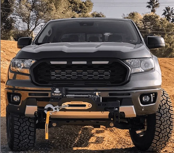

Westin Automotive and Superwinch have teamed up to build a winch bumper/bull bar. They should be releasing it soon. David at Westin would know more information if you called them. Based out in San Dimas, CA.
I kind of want this!

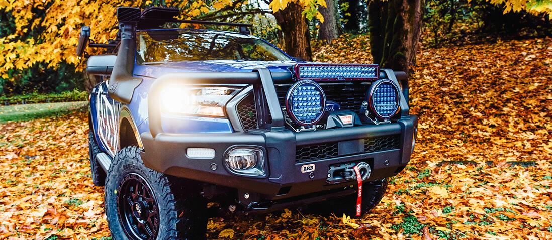

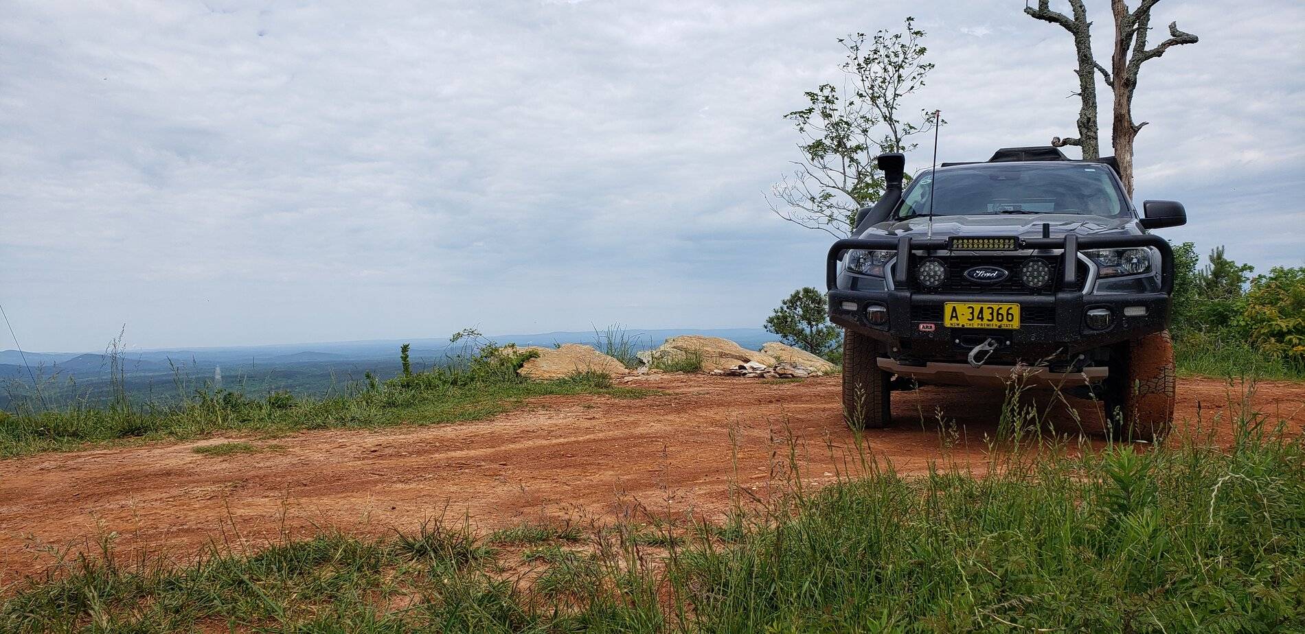

The ARB Summit bumper is also compatible with the ACC.
I probably won't get one until this spring or summer so I'm hoping more options may be available then.
As of right now, the ARB is my top choice.
That thing looks like it weights a ton. I know that's a good thing, but also... a bad thing if you also daily the truck.
