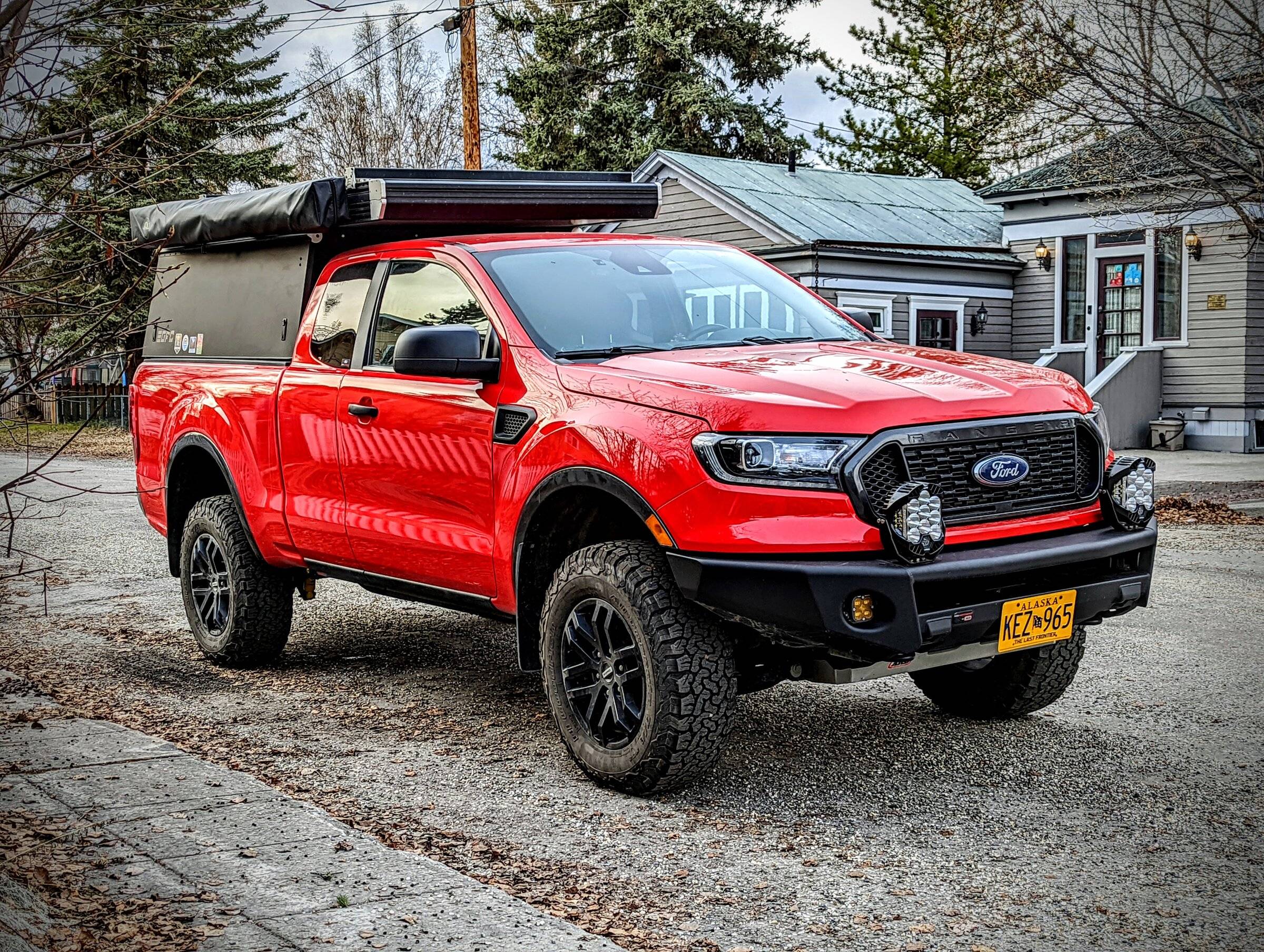

New pic with lights installed. Loving this bumper. I bought a Warn winch and will install it soon.
Hi Mapco, what lights did you get? No longer shown on arb website. Thank you!

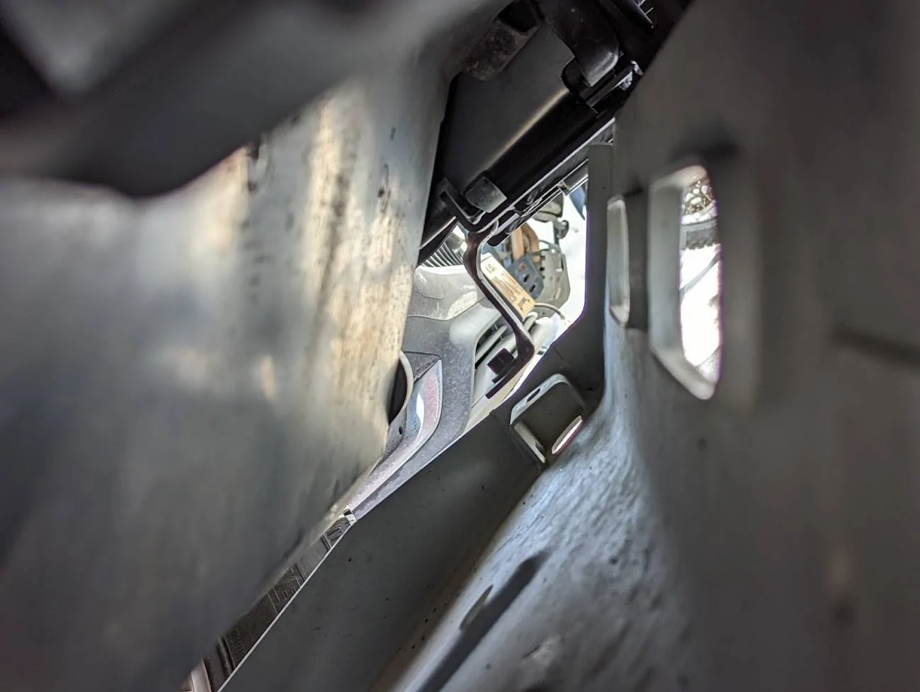

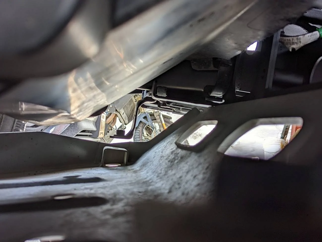

As for installing yourself, lol it's a bear of a job. I'm doing mine now on vacation and about to roll into my third day ? I'm only pulling about 6 to 7 hours of work per day on it, and I'm losing a ton of time adapting it for my parking sensors and figuring out the adaptive cruise radar
End of day two I've got it hung on the truck, have to torque everything tomorrow and install some little trim plates and finish installing the ACC
You'll need a 21mm socket and a 17mm wrench to get it done, those were two items I didn't have on the shelf

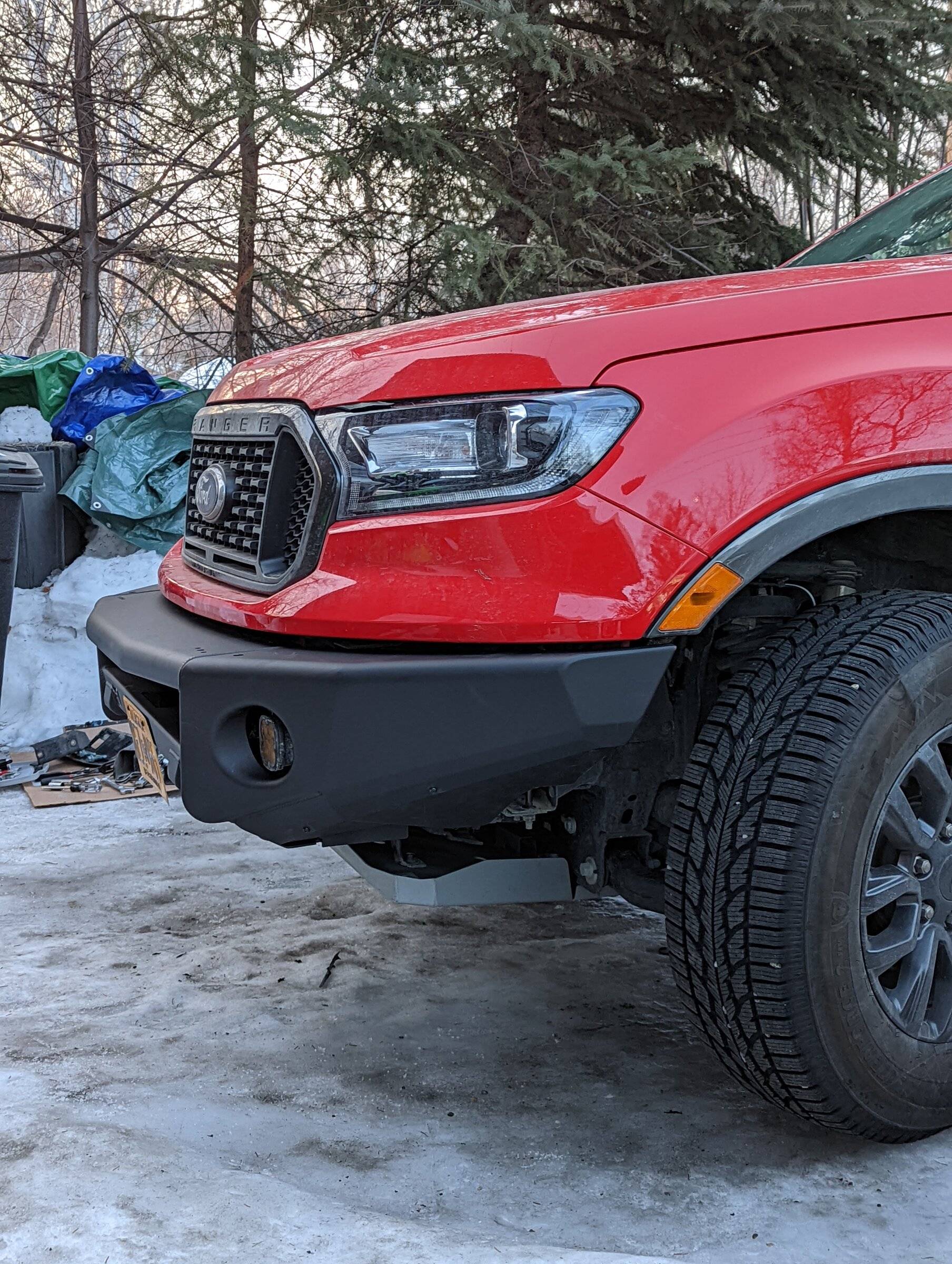

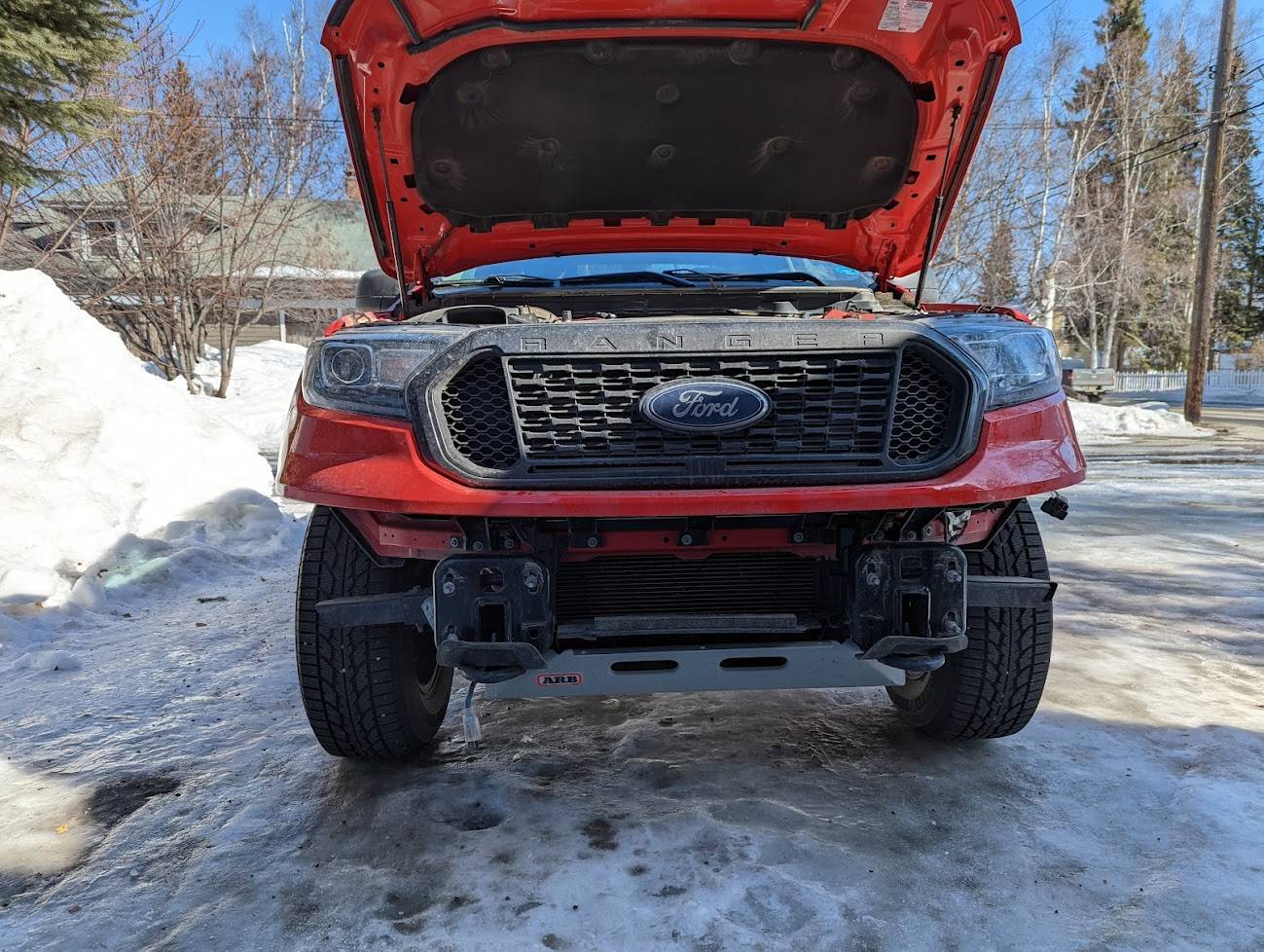

Since this thread popped back up I thought I'd give my 2¢
Overall nice bumper (Quagmire chin needs lights/hoops not to look weird tho), instructions were pretty lackluster, the one part I didn't get at first was that you need to pop the 3 bolts holding the original bumper off.
Seems sturdy without being overly heavy. Lots of holes inside and out for mounting things. Gotta tweak one of the sensors and the ACC bracket still, but not so bad.
Really dumb they didn't follow thru and drill holes for sensors and ACC. Or fit for ARB skids, although that's a quick fix. Also not great that their recovery tow piece that fits in those holes is $200. Rattlecan blue tow hooks will do for now.
