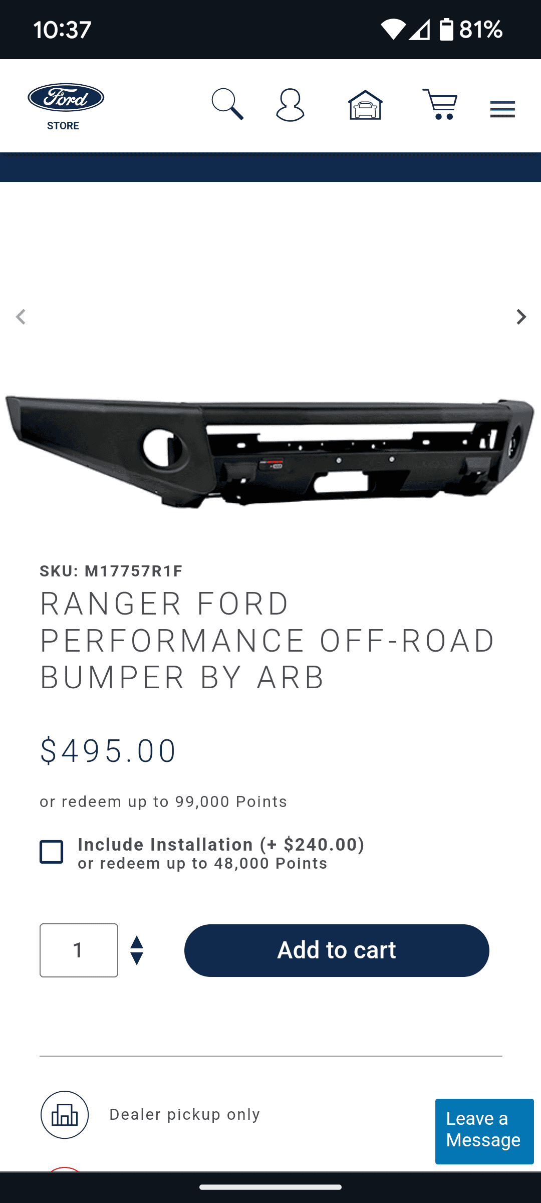

I just ordered this bumper; It's now only $495. After a few cold ones had it delivered to my local delaer. I dont have the factory fog light option (XL). Wiring aside, anyone know what size aftermarket lights will mount/fit into the fog light spot on this ARB?
Where did you find it for $495?
Got a link?
Thanks!
