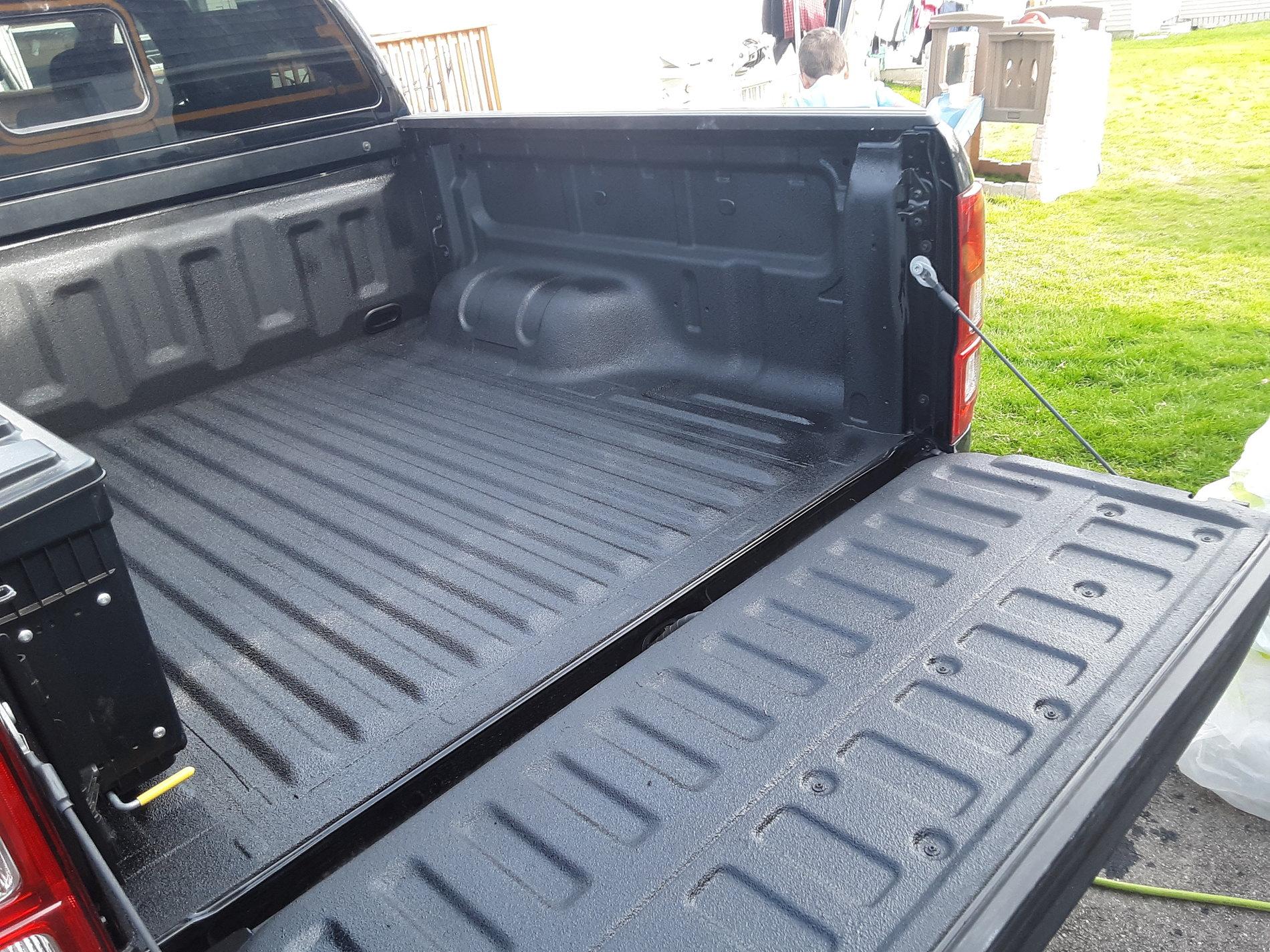

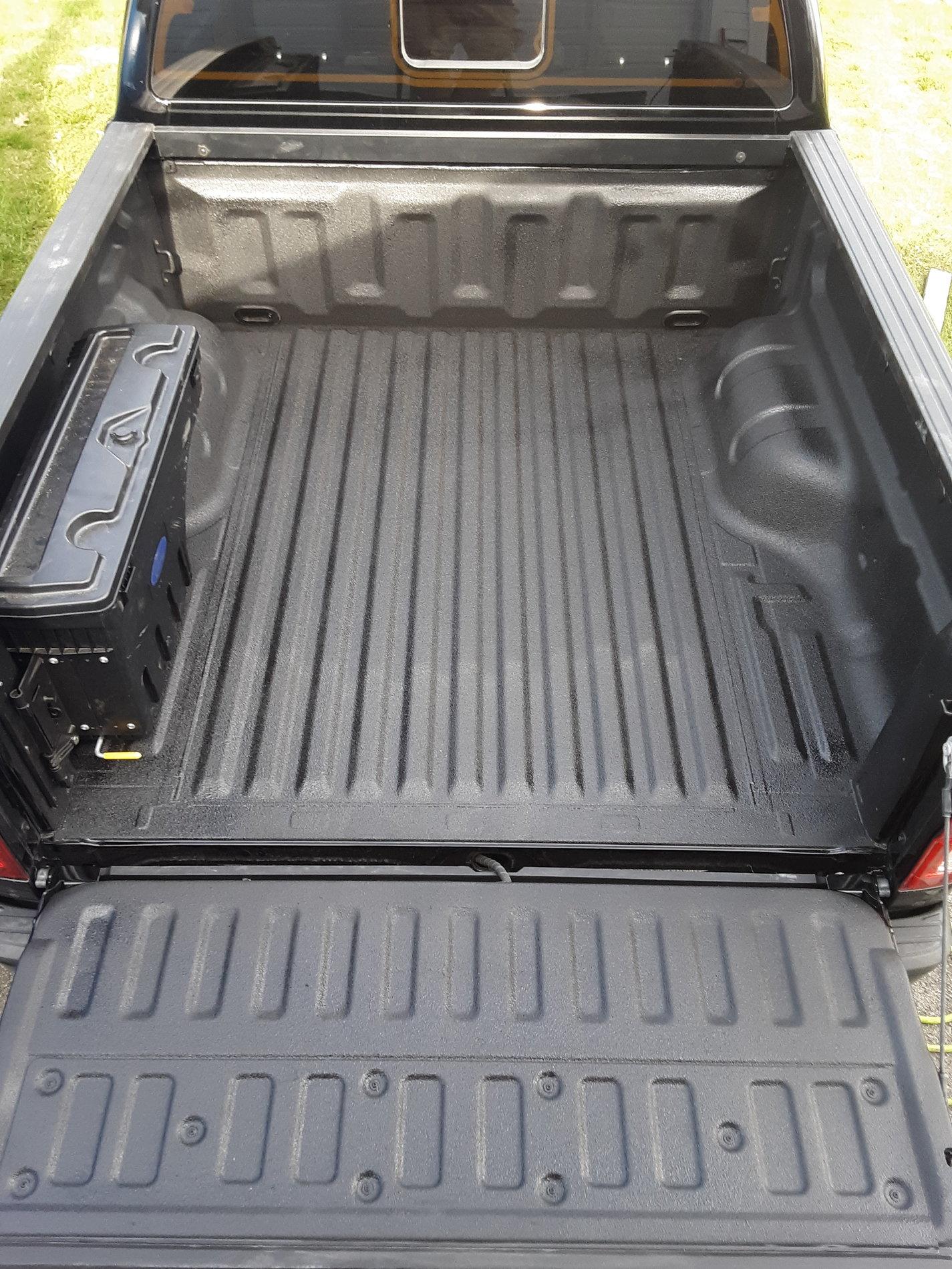

Next chapter in the life of the black beast of aaaggghhhh! Today it received its spray on raptor bedliner....that stuff is pretty OK...
That looks really good - do you have a link to the kit you used? I keep thinking I might end up putting a DIY spray in under my bedrug....

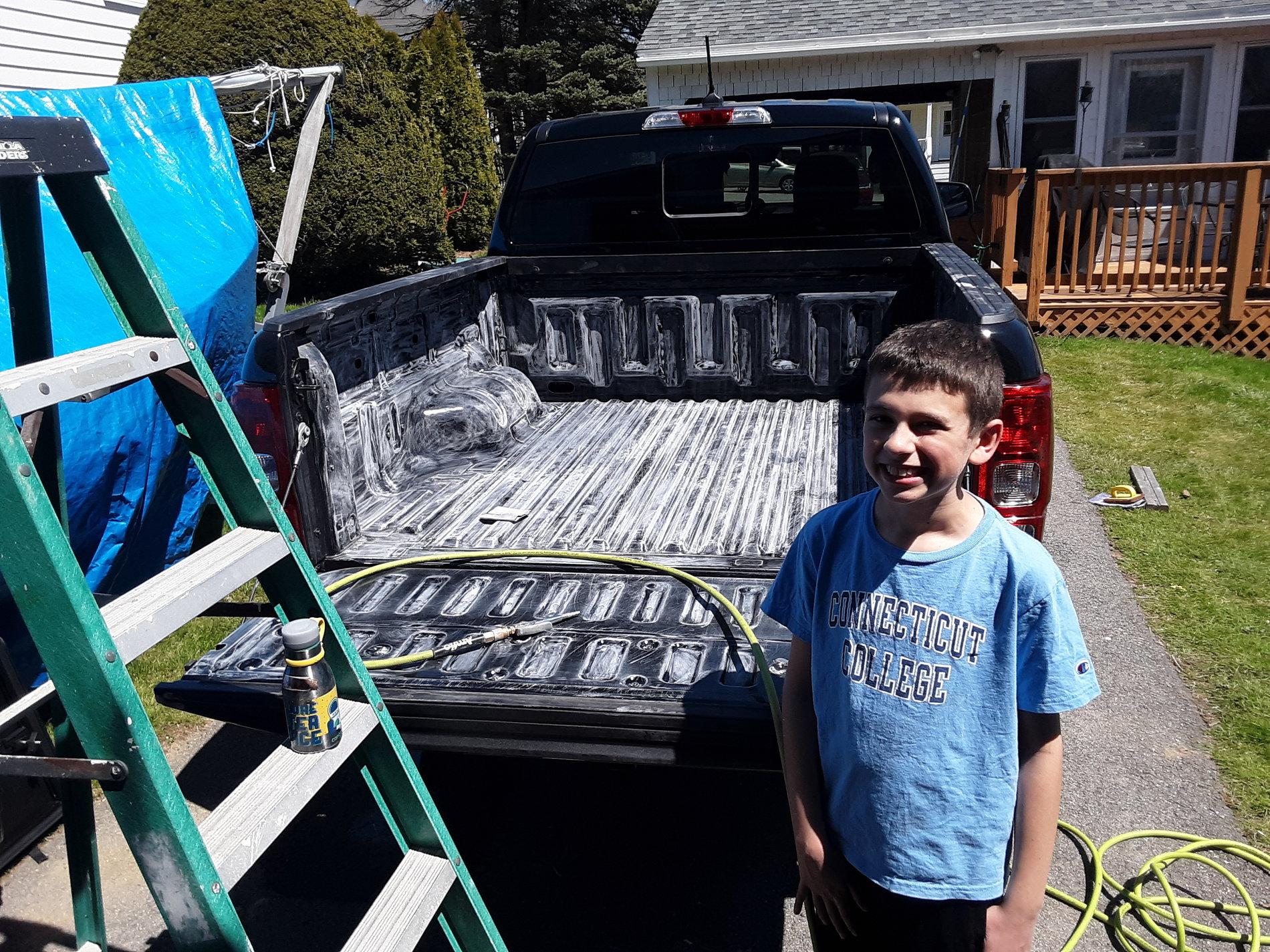

Sure...I bought it at Amazon Comes with a cheapy spray nozzle but it got the job done. The built in pressure regulator valve didn't work very well, so I adjusted the pressure at my compressor and left the valve wide open. The process is a little tedious but the paint scratching is the biggest chore: my son and I did it in about 2 hours using a combination of scour pad, angle grinder and 150 grit sand paper. Blew it clean then cleaned it with TSP; rubbed it dry and sprayed away. It is best to mix two bottles at a time. The finish on the stuff is great...looks like a PRO job :rockon:

looks good. I have a drop in liner I'd like to ditch but don't want to drop over $400 for a professional spray in.

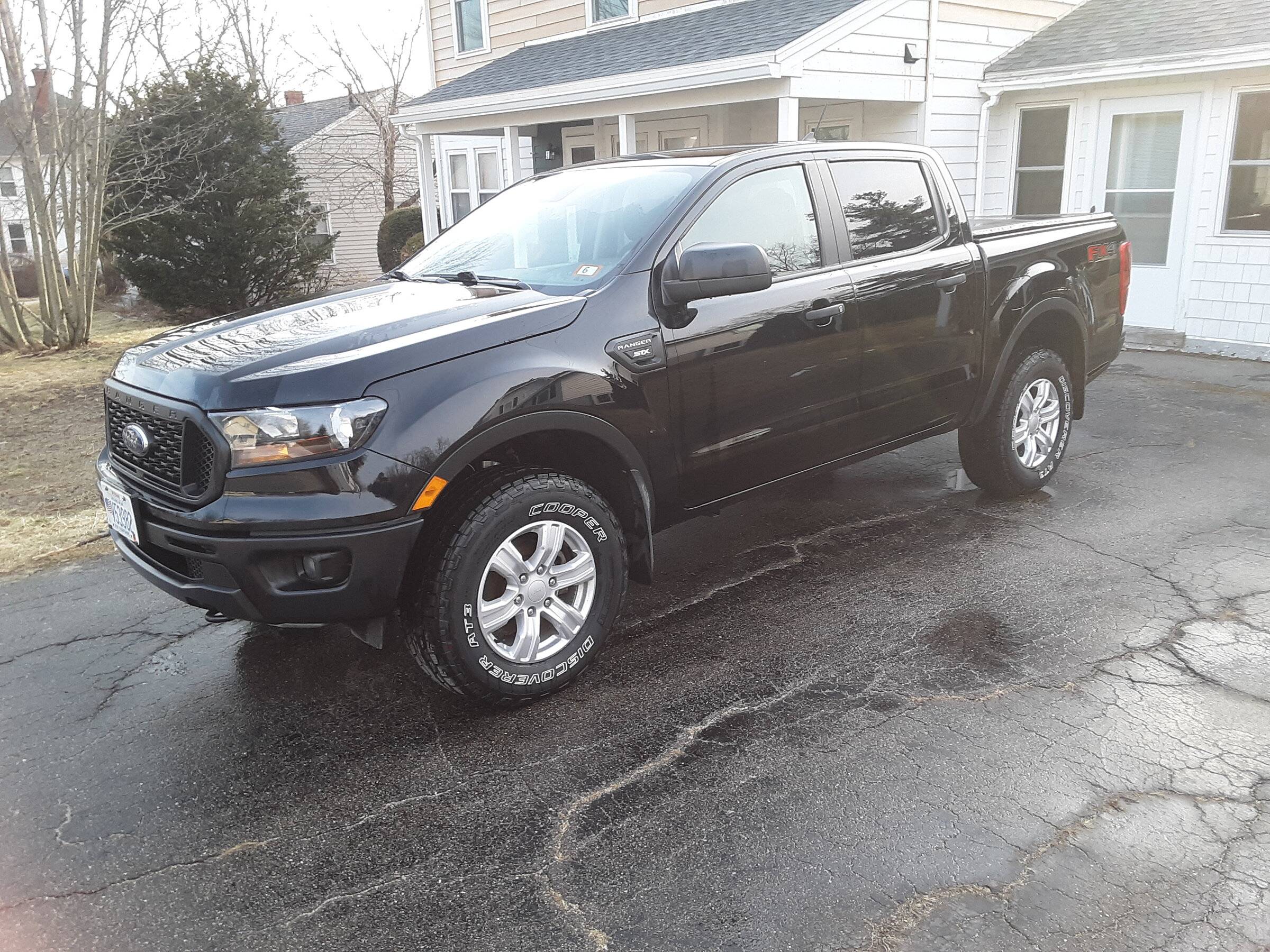

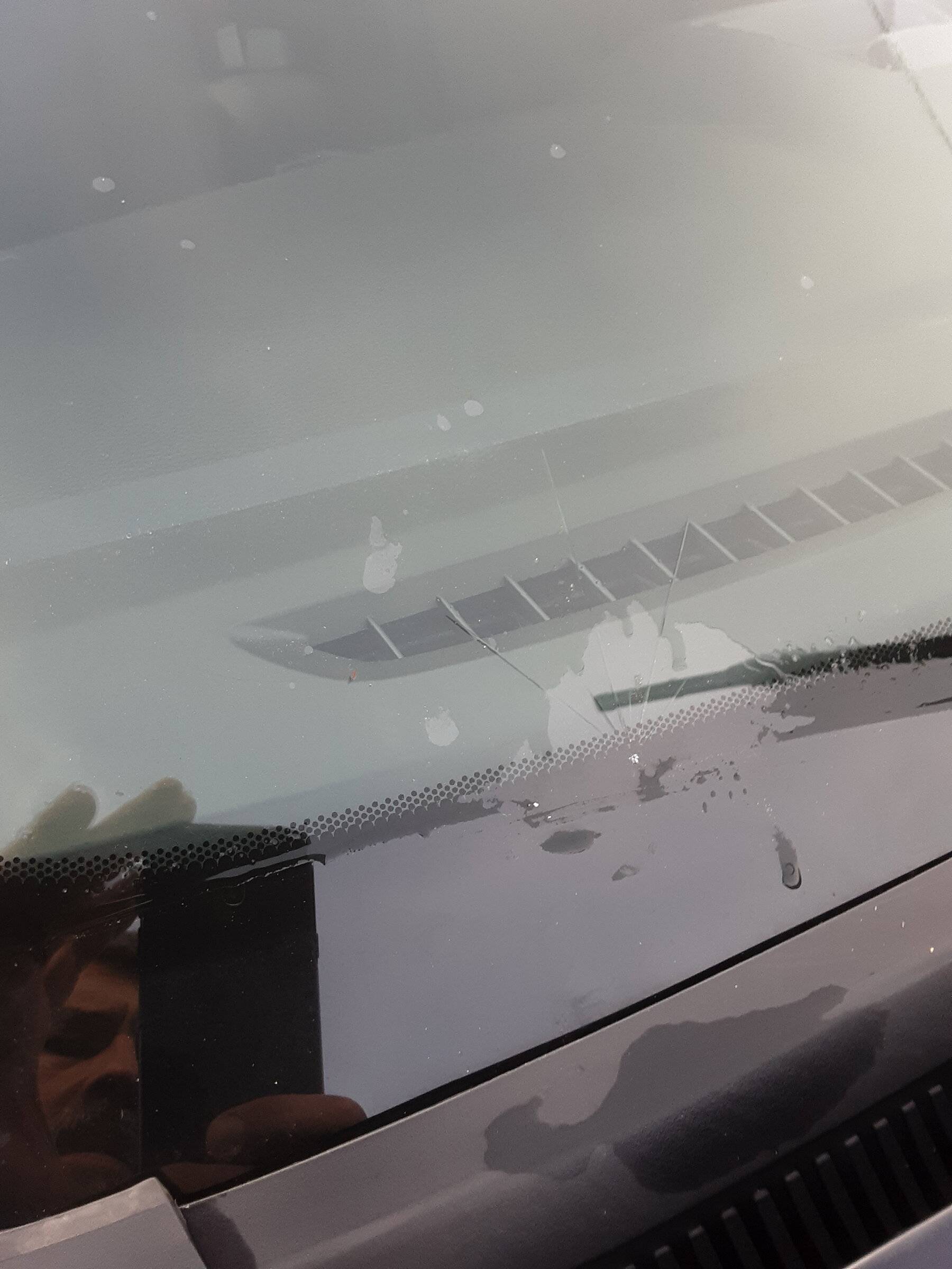

Wow! It's been a while since I've done anything to the beast but drive it....after 19,300 miles, I replaced my stock Hankook Dynapro ATM 265-65-17's with Cooper Discoverer AT3 4S in 265-70-17. Adjusted the tire size with FORSCAN from 2390 (stock) to 2437 (tire circunference in mm). The next day (yesterday) decided to wash the truck at home and replace the windshield wipers, as I'm popping out the passenger side, the arm slipped off my hand and hit the windshield...CRACK! (!@#$%^&!*!SOB!). Can't believe how wimpy the glass on newer vehicles is. Anyway, getting replaced Wednesday.

well, the new windshield is in (OE thank goodness!) and all is well. BTW I have 4 OE Dynapros plus a brand new spare if anyone is interested-side note: the Hankooks weren't necessarily "bad" tires...they were pretty quiet, got decent MPG, good in the wet and dirt but not so good in the snow...anyone interested LMK via PM. They are 265 65 17's BTW

Here is a picture of the new look....plus the cracked windshield. All good now
