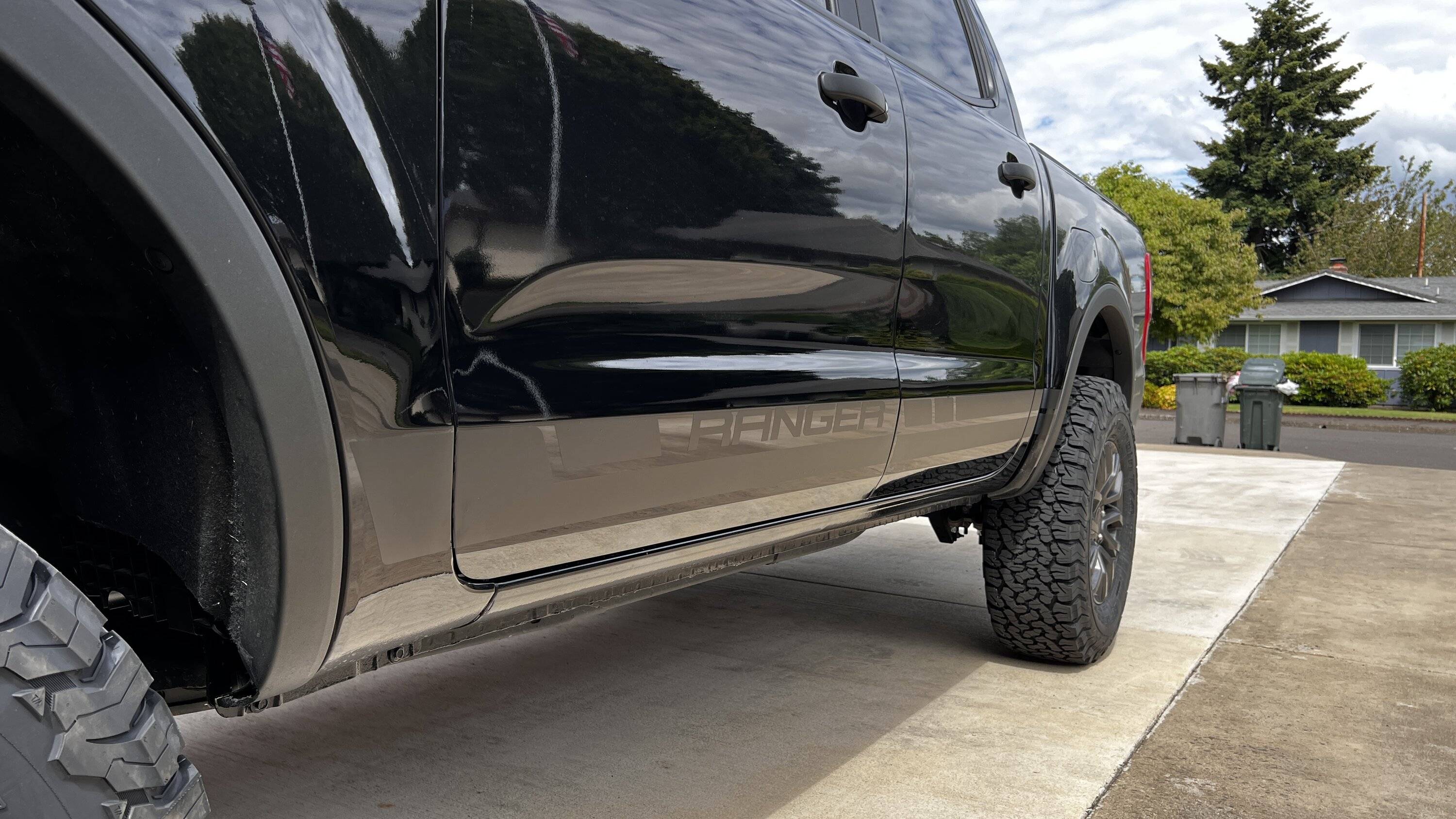

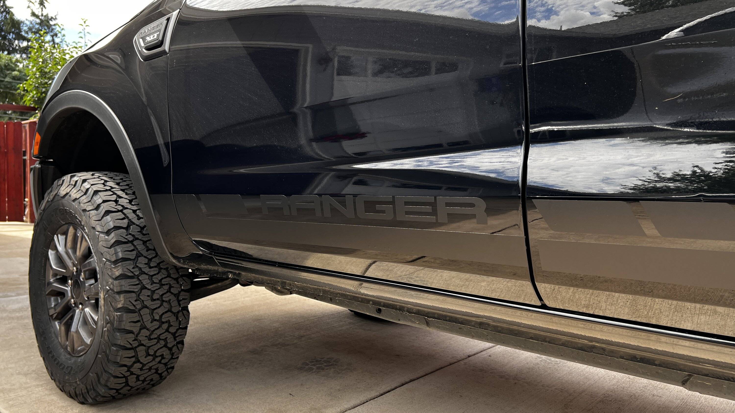

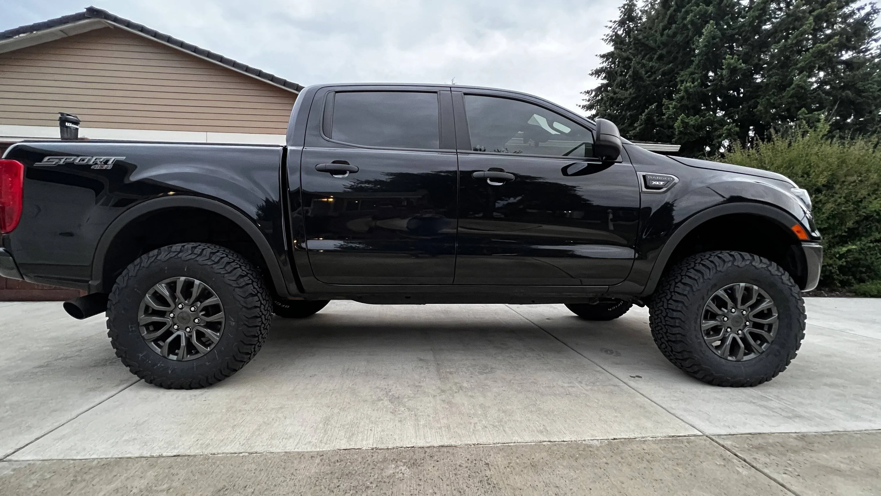

Great looking Ranger Hector!!!!!!! Where are you in Oregon? Beaverton by W Square for me? By one of those pictures are you by a golf course? Thanks
