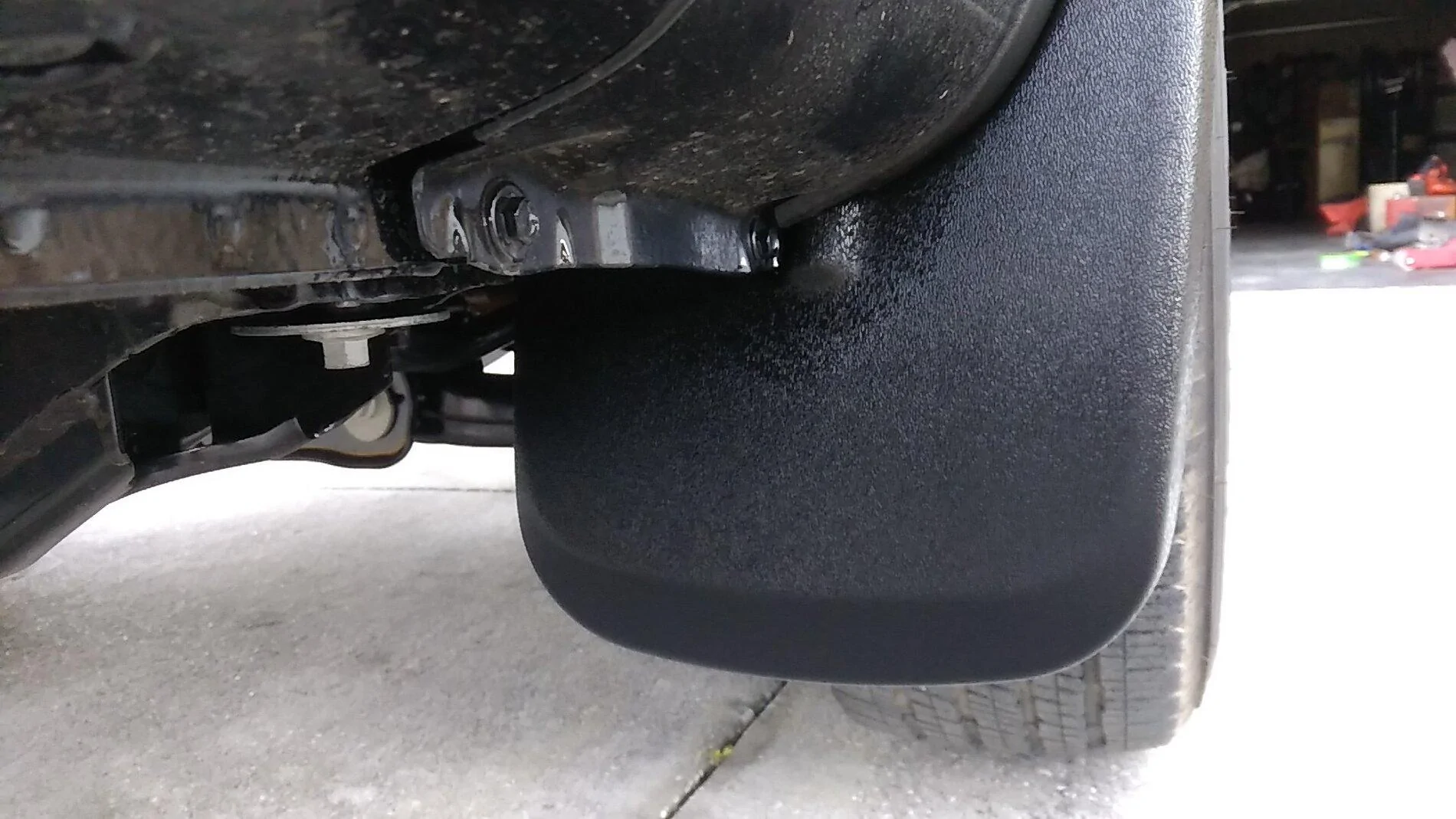

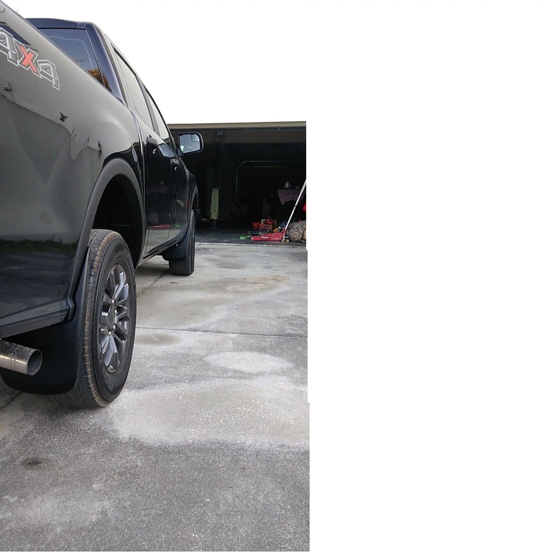

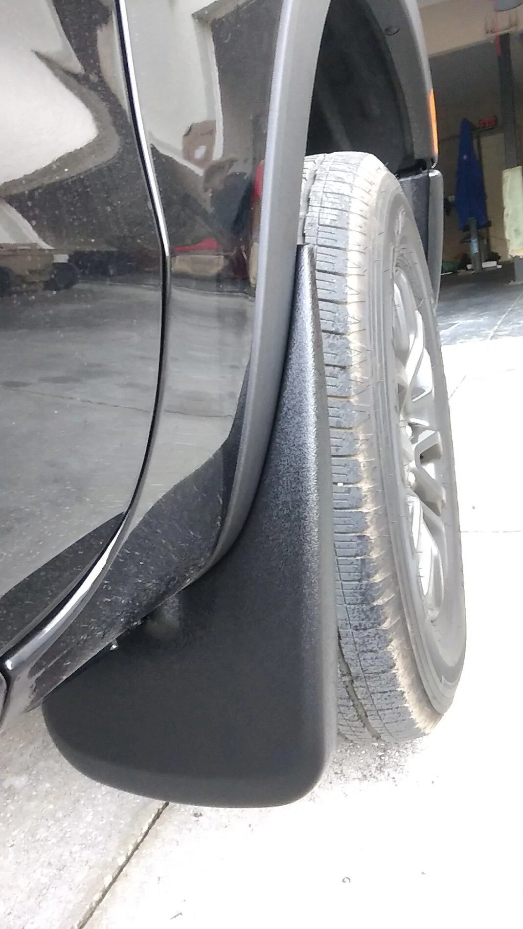

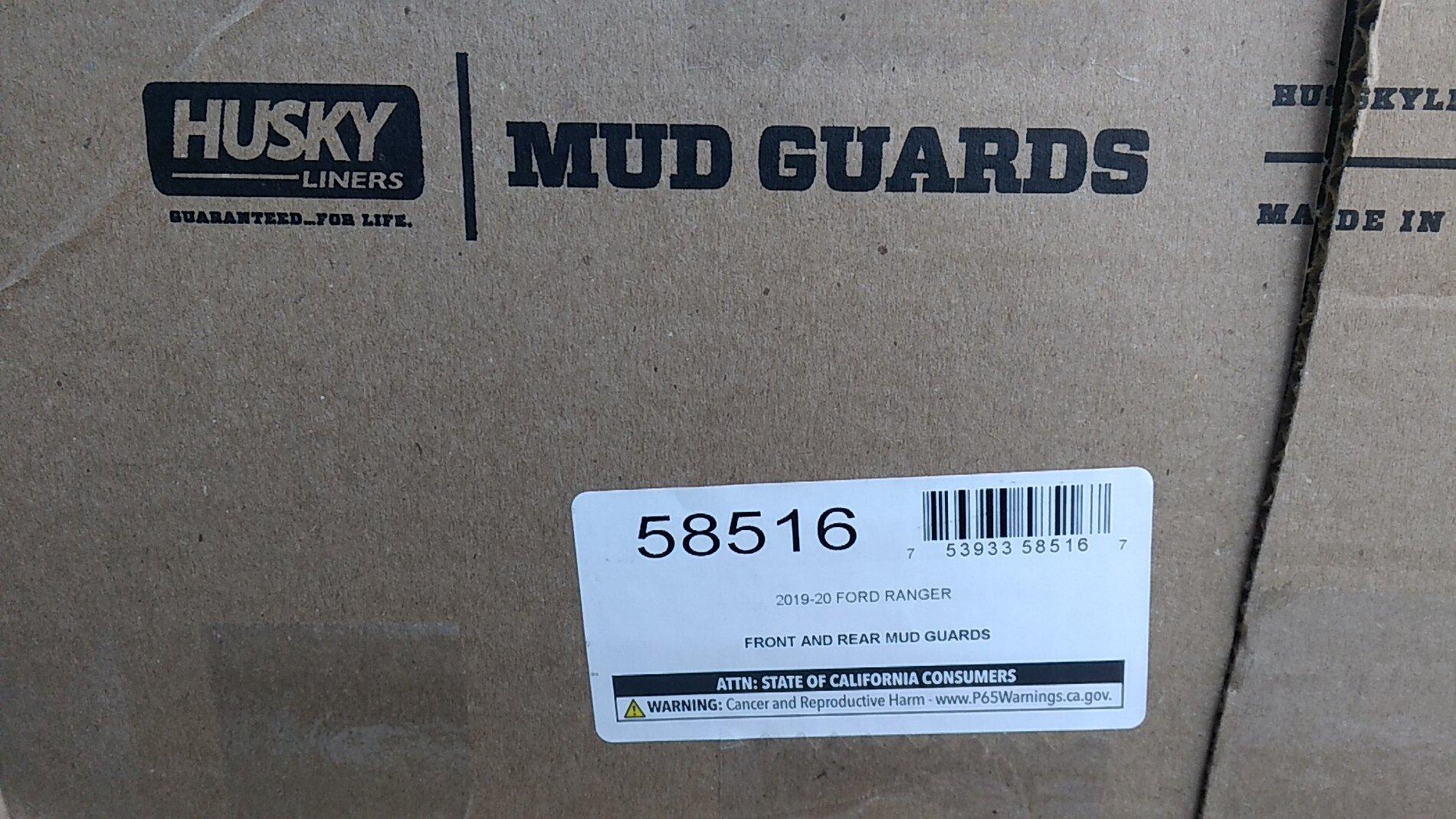

Installed Husky liner mudflaps today....a few reviews said they dont contour fit ????? They fit tight like a glove....I like these to prevent rock chips . Quality pieces. I used self tappers and predrilled them .
Do you have a picture of the front mudflaps from the rear? Do they cover the crash bars?

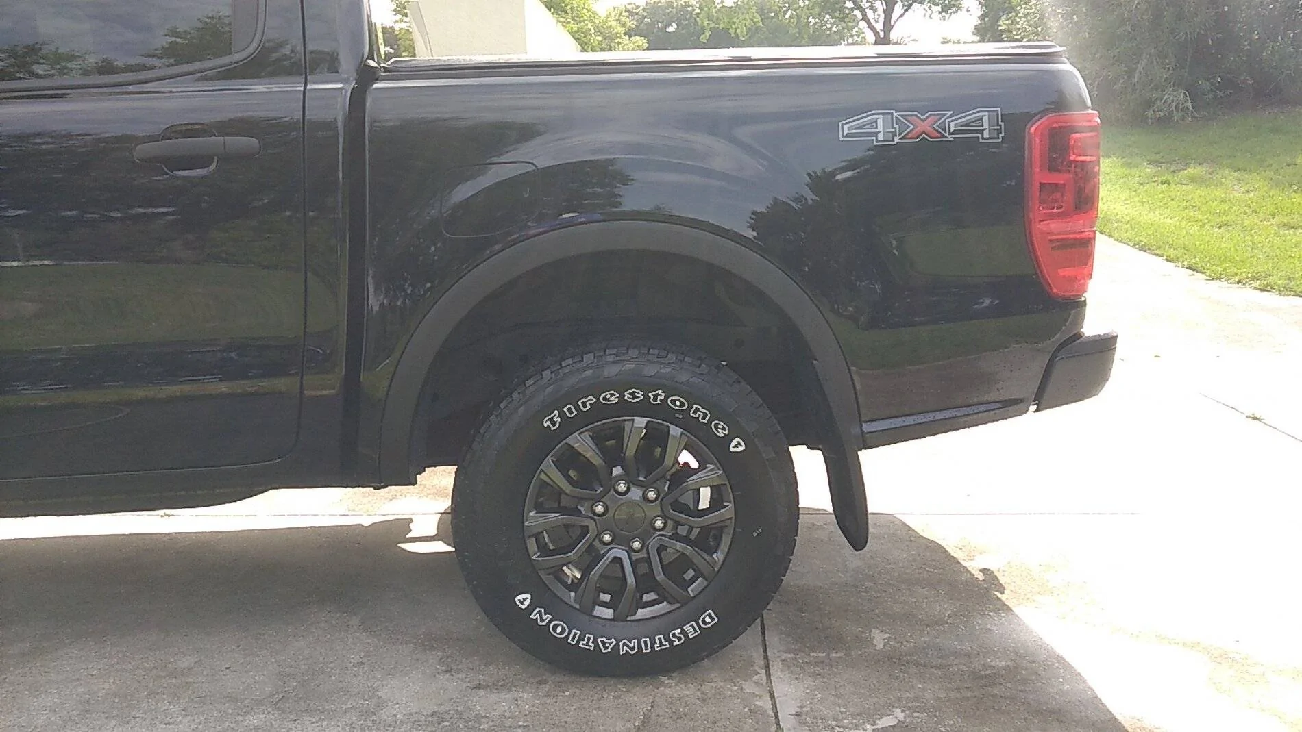

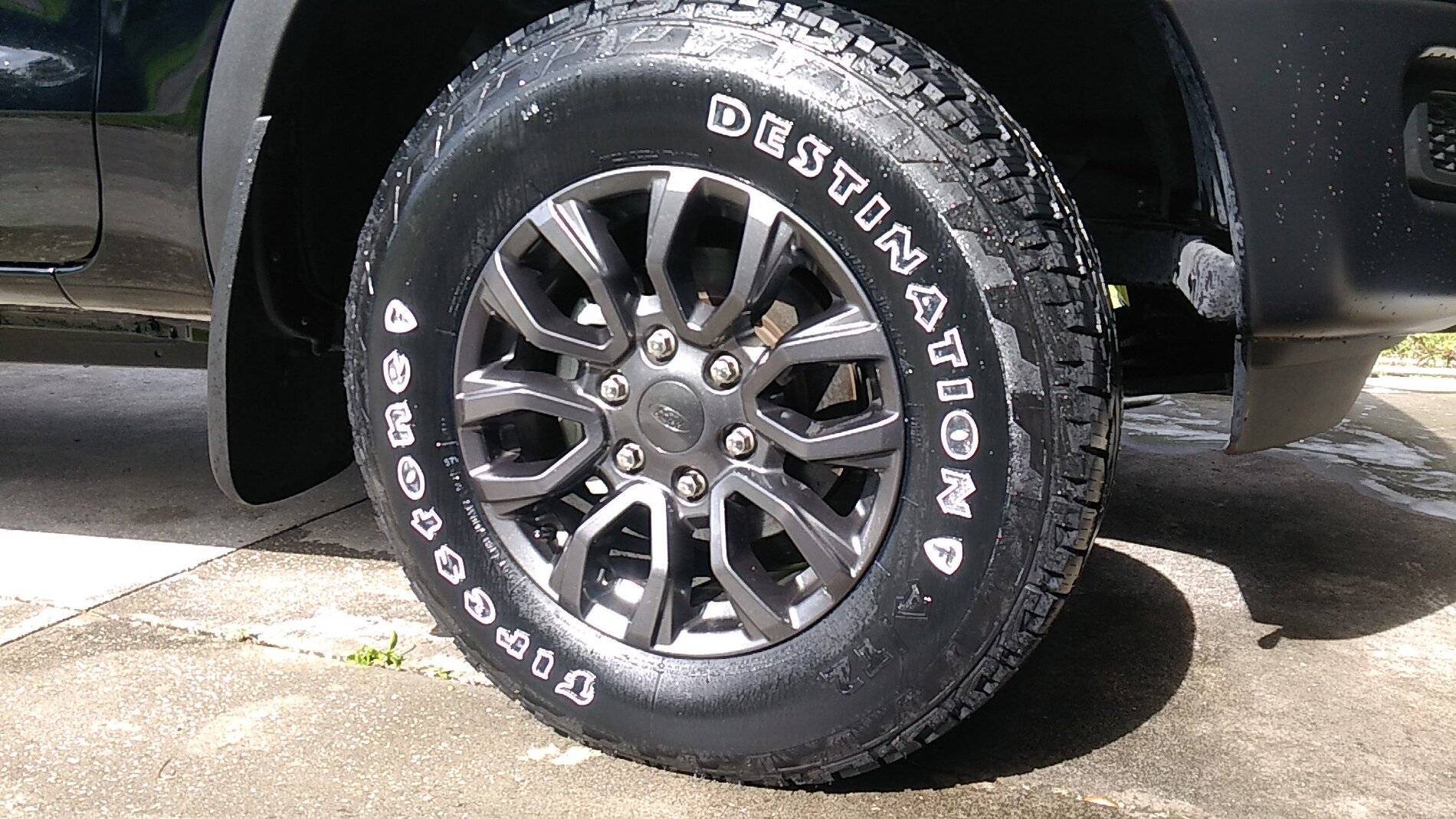

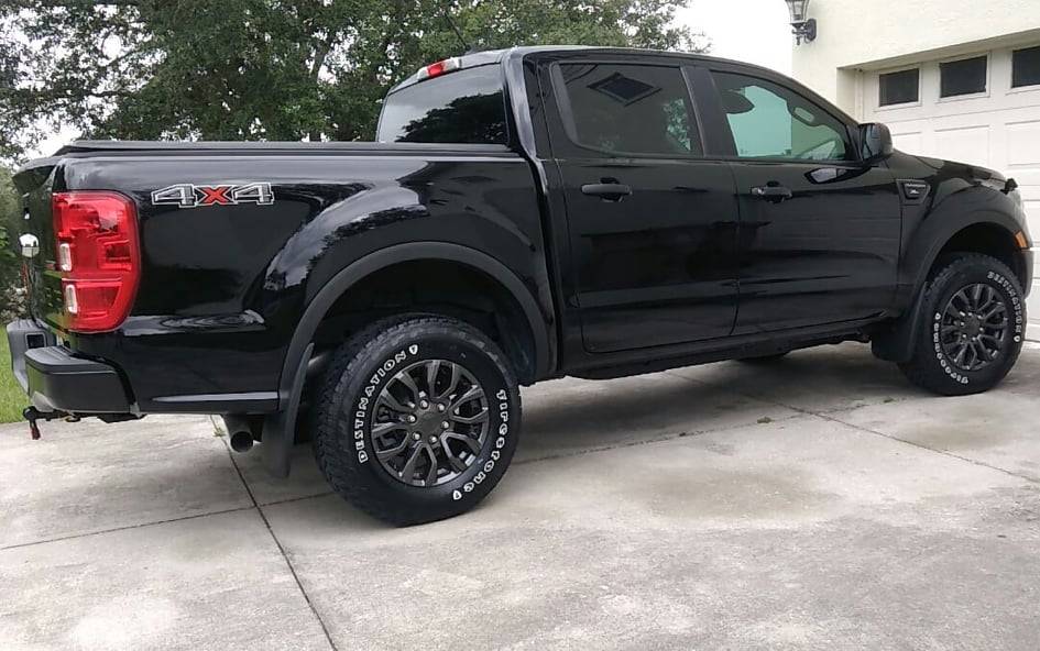

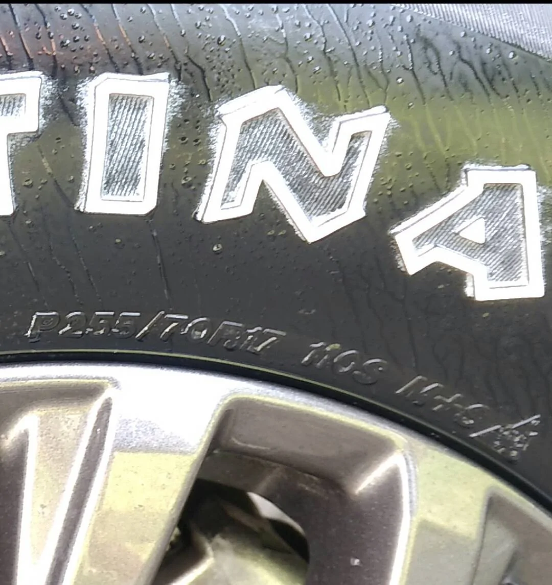

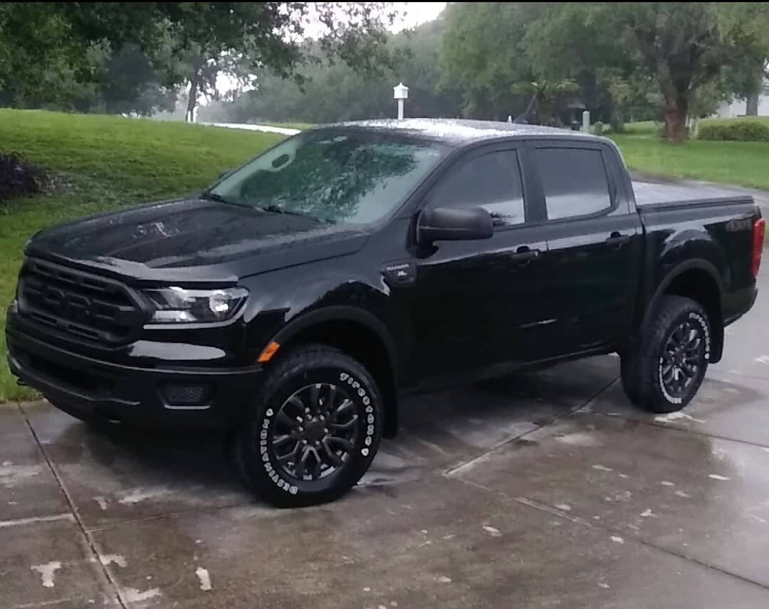

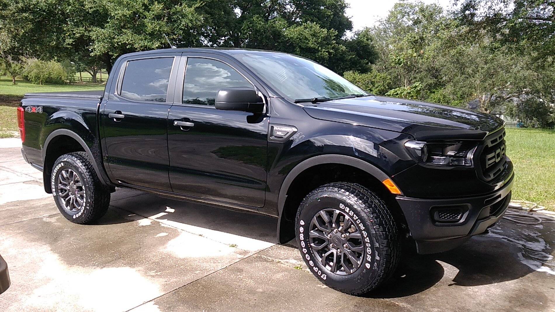

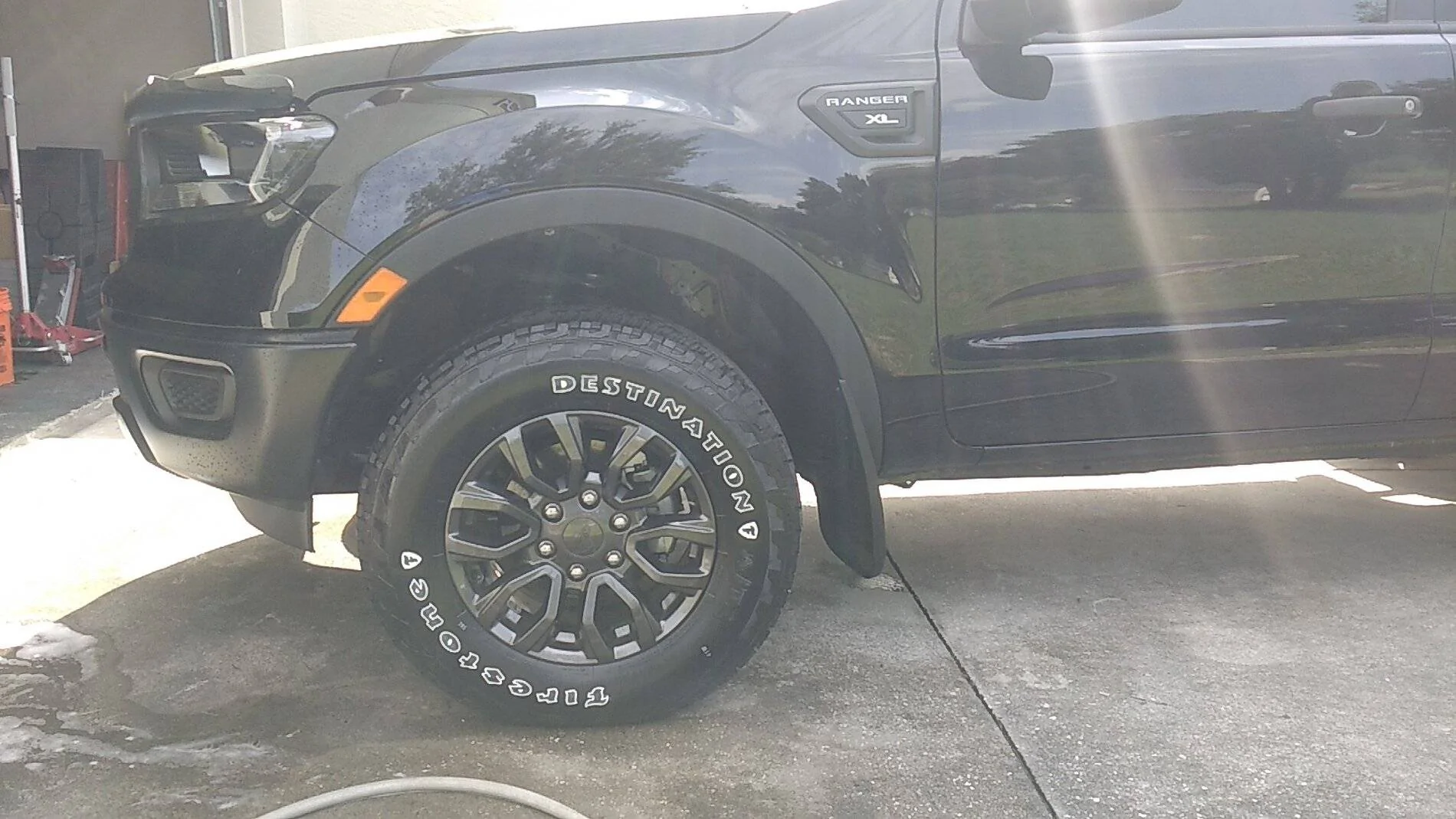

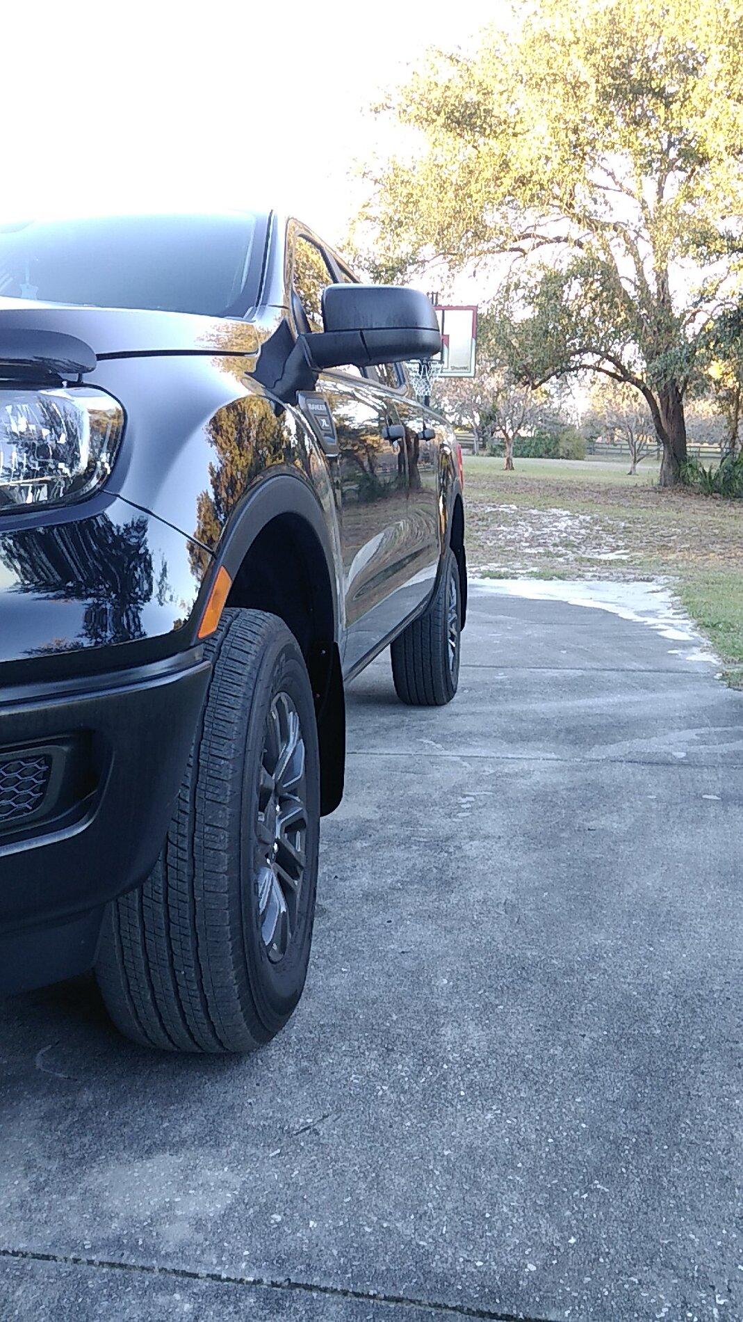

New shoes Firestone Destination AT2 ....didnt want to go full on AT ....255 70 17 - 31 in ...quiet ,took alot of balance weights however near the tpms?

A few more

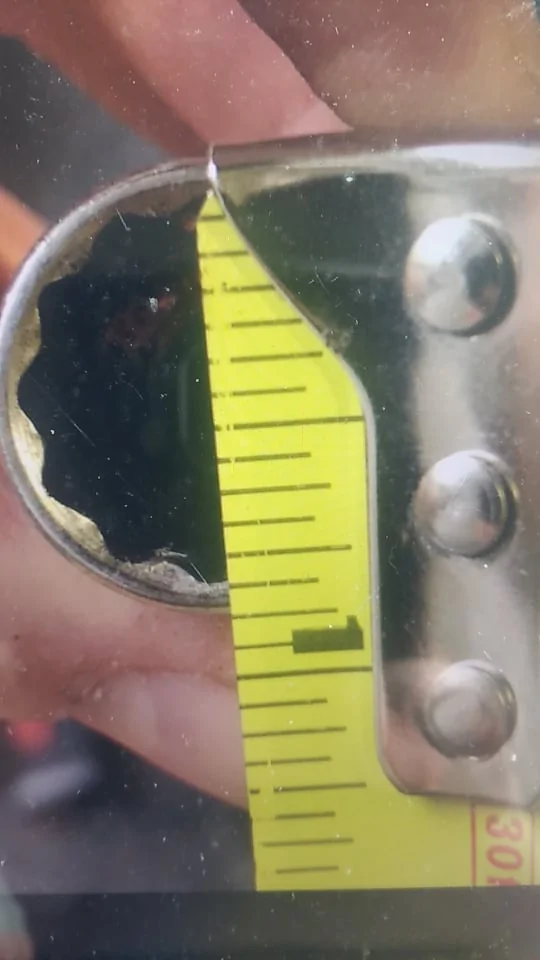

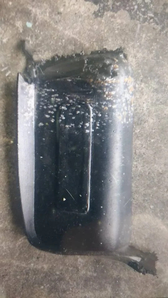

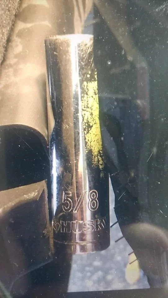

255 70 17 - 31 " no lift , XL 4 x 4 stock suspension and 1" faction fab spacers , room shown with a 5/8 th socket stuck between the tire and the front crash bar - wheel turned to greatest intrusion point . I had Huskyliner mudflaps and had to cut off the 4" piece that sticks out and fully covers the crash bars inside the wheel well . Cannot tell at all they have been trimmed . No rubbing at all .

Nice post John. I grabbed the current sale on these spacers with the same set up you have. Except I have 265's.
Looks like trimming of the mudflaps is a must, but we can deal with that when the time comes.
Must agree, the sport wheels do need that 1" of poke.

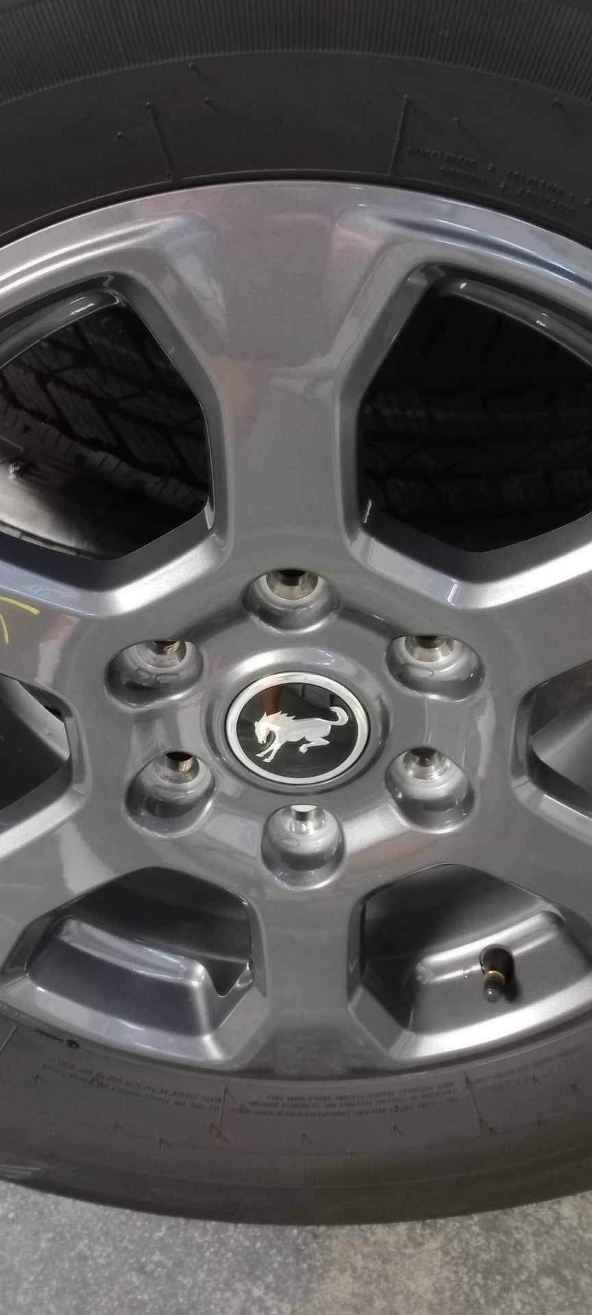

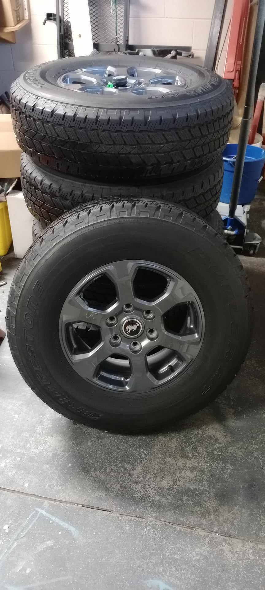

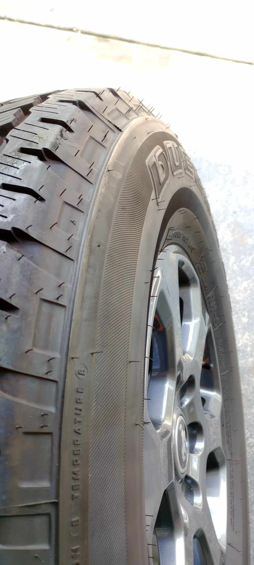

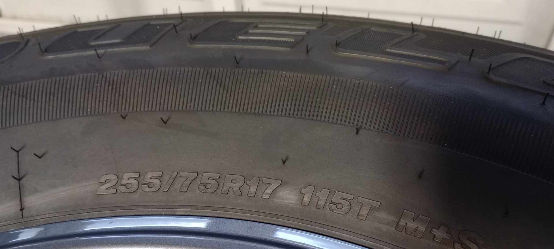

Seeing the prices of new tires lately I have been keeping my eyes peeled for any new Ford takeoffs....I couldnt pass up a great deal I finally found so I pulled the trigger today and scored these qty 5 2022 Bronco takeoffs with Dueler AT's from a nice guy with little to no miles on them .....got all 5 for $400 ! Factory weights, nibs still on them ,center caps ,lug nuts 255 75 17 . I was actually going to put them on another vehicle I have but I just think it will be a nice change and my 255 70 17 Destinations already have 45k on them . I think I am going to sell those rims n tires and my faction fab 1" spacers behind them as a package deal to further offset my cost on these. Will post some before and after shots .

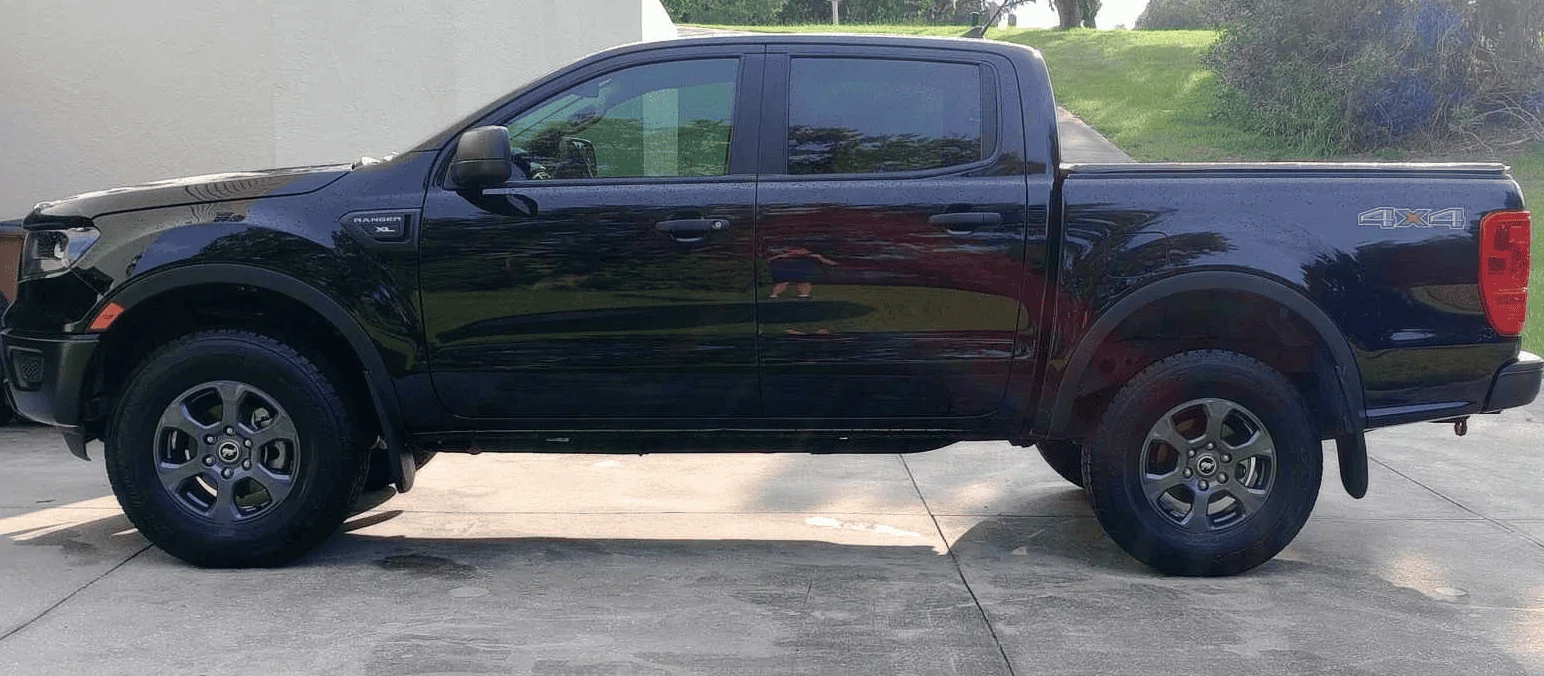

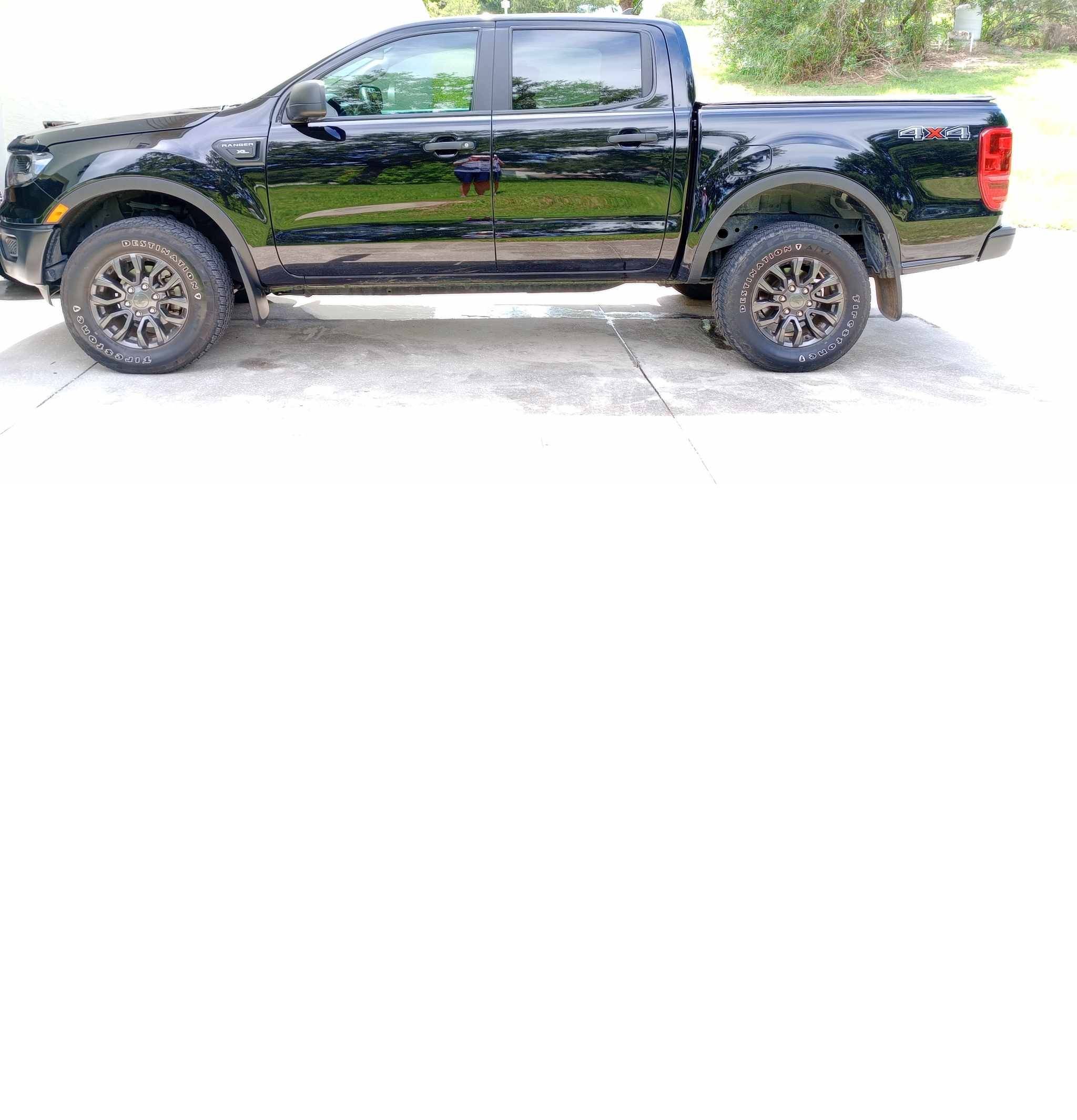

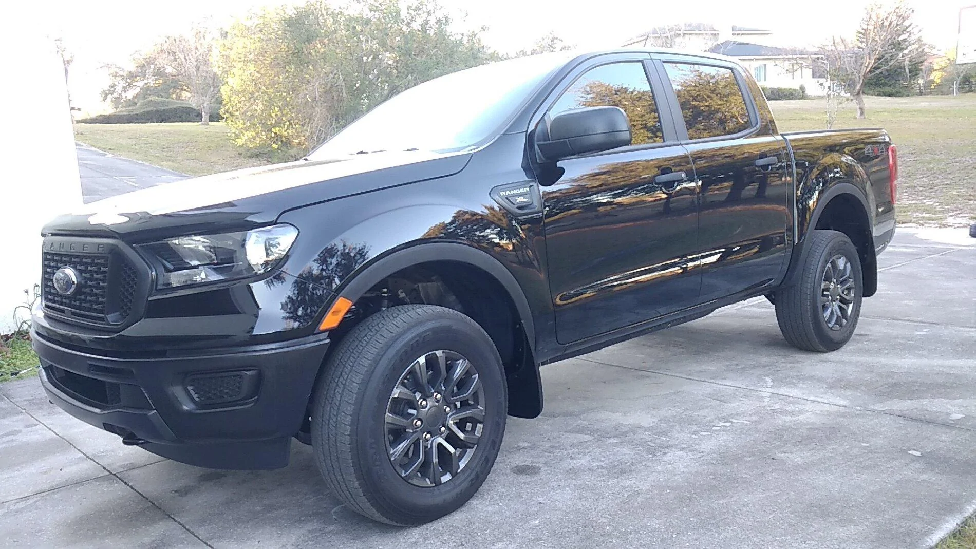

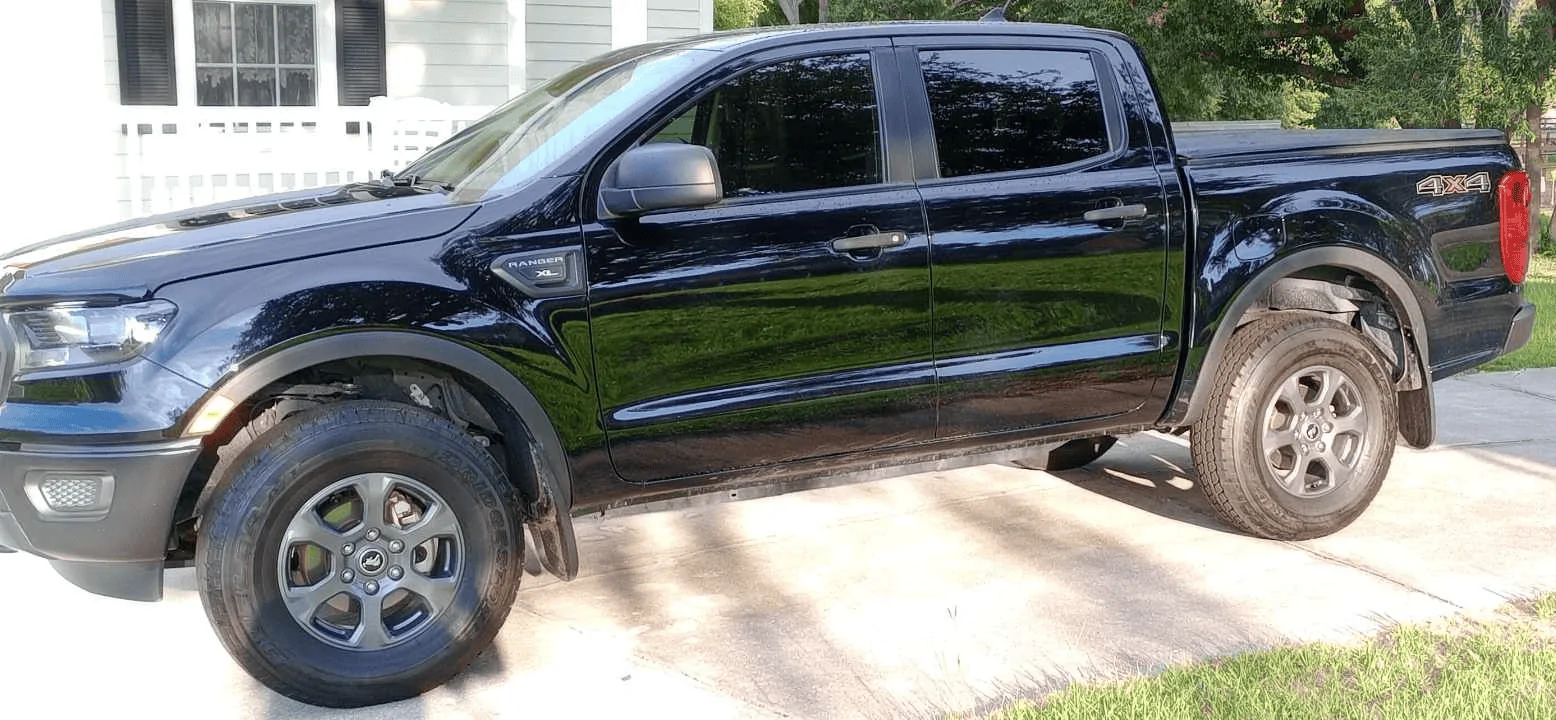

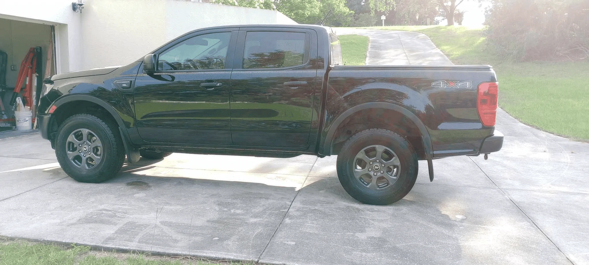

Stock 2022 Bronco takeoff rims 255 75 17 Bridgestone Dueler A/T ...hubs are exactly the same . N O rubbing at all ...no spacers, no lift . Happy with the look ! Before 2nd pic. below. Broncos 1 inch bigger at 32" ..255 75 17 vs old Firestones 255 70 17 31" .

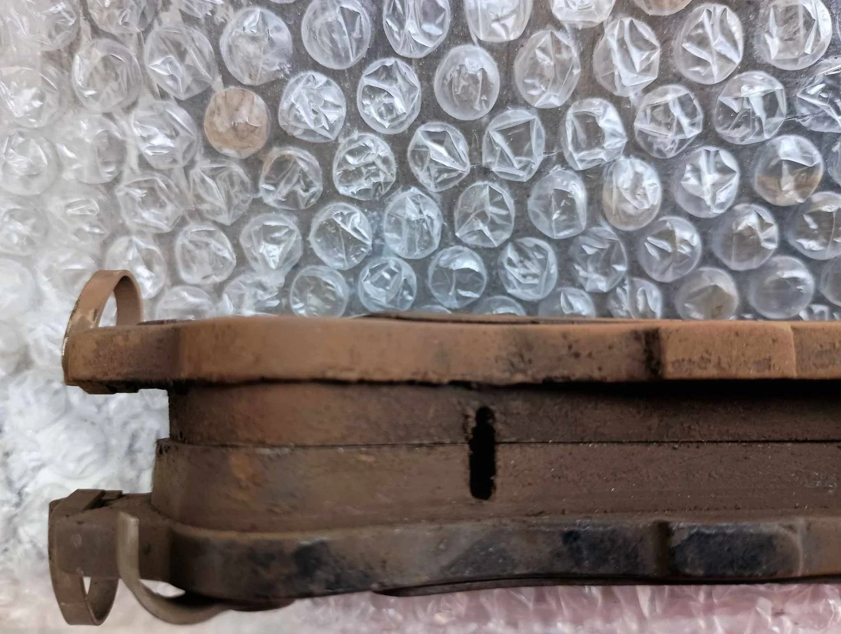

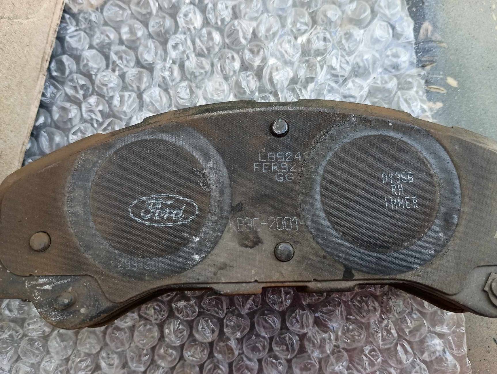

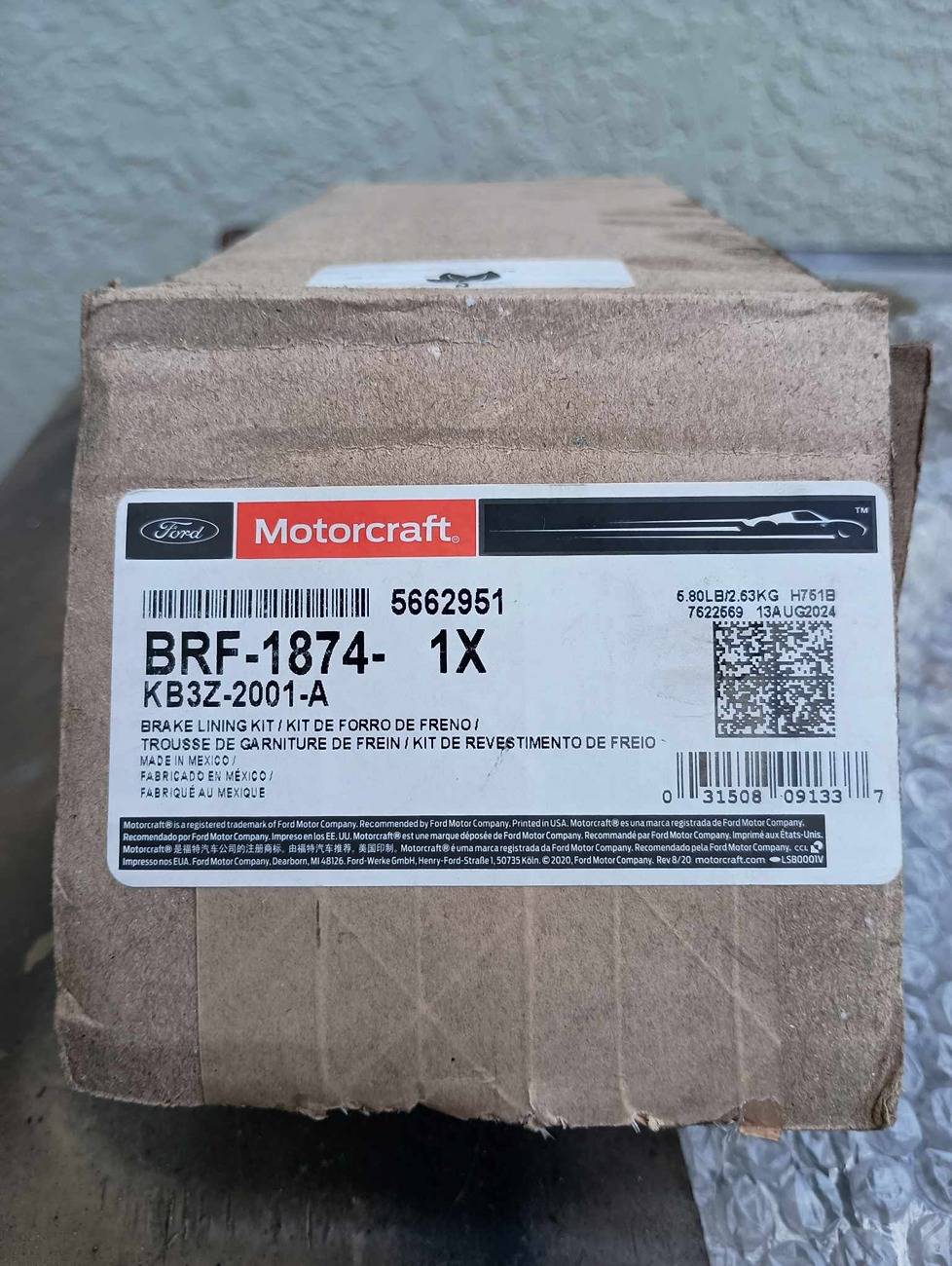

69K miles ...threw on some Ford front brake pads today even though I was shocked and found they had probably around 40- 50% pad left...... amazing. Figured I would go ahead and do them anyway. I also did a tire rotation. My only tip is to roll the pads into the channels with those funky tensioner clips. Kit came with new pads, caliper bolts with thread locker, tension clips and aluminum shoe ear saddles for lack of a better term ( I dont know what they are officially called).
