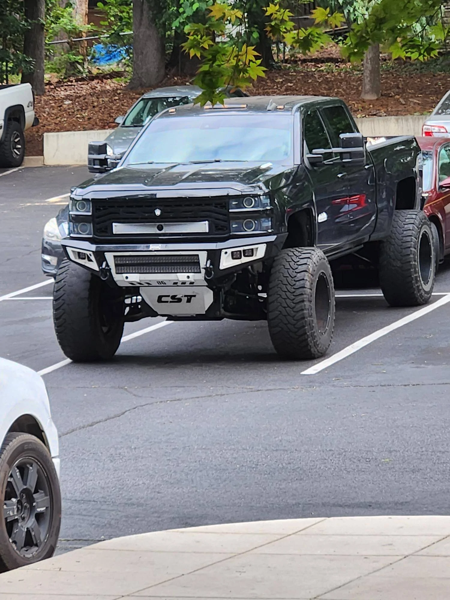

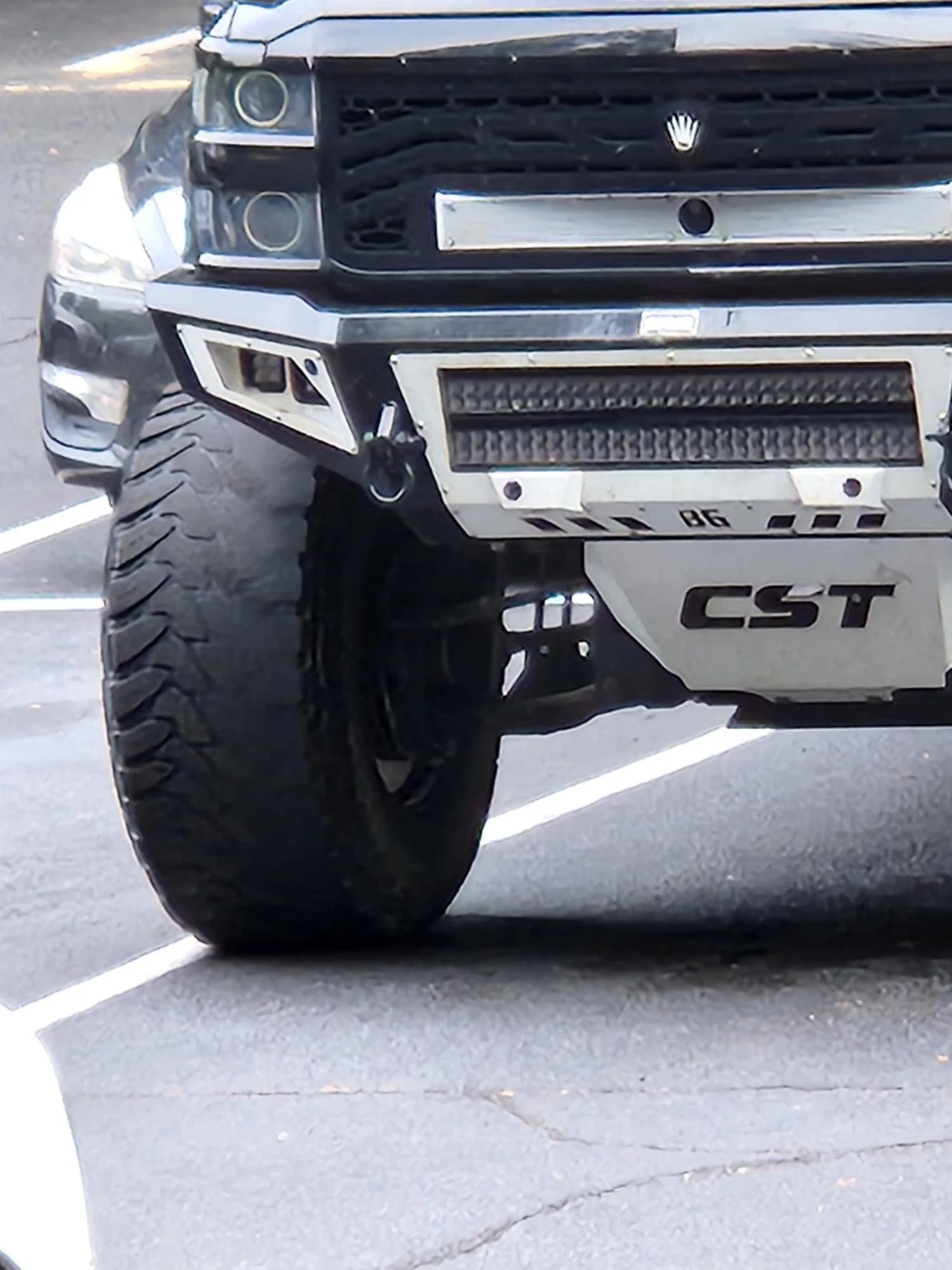

So were the SC tires or the Japan tires the defective ones? Speaking of tires, this truck was parked in my office's parking lot this week. Check out the wear on that passenger tire.

They never measured the height of each tire. That being said I would assume the Japan's since they were both different even to each other compared to the SC one's which were the taller one's.
