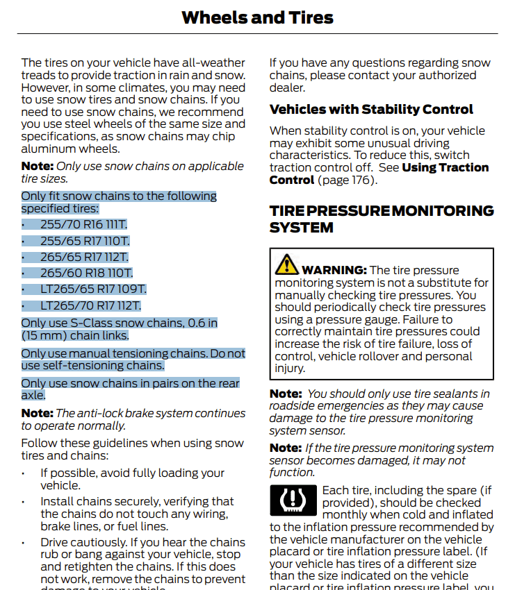

What timing! Was just looking at this in another thread. The Ranger's owner's manual states to use chains meeting SAE "S" Class clearance requirements on the rear axle only.

I believe it's just for clearance, but I can't imagine there being much of a clearance issue on the rear. The front wheels have a fairly tight gap between the tire and the suspension, though.

On a 2WD vehicle, you'd always chain up the drive wheels, whether that be the front or rear wheels. If I had to put chains on my old Ranger it was always in 4WD anyway, so I could put them either on the front or the rear. I always found it more useful to have them on the front for braking traction.

If there was no issue with clearance I would say put them on the front. Unfortunately due to clearance I can only put chains in the rear. With that said if I didnt have to worry about rubbing I would use Auto Socks!! Before using the chains I would suggest getting two sand bags and put them in the bed. It really helps with traction for snow.
