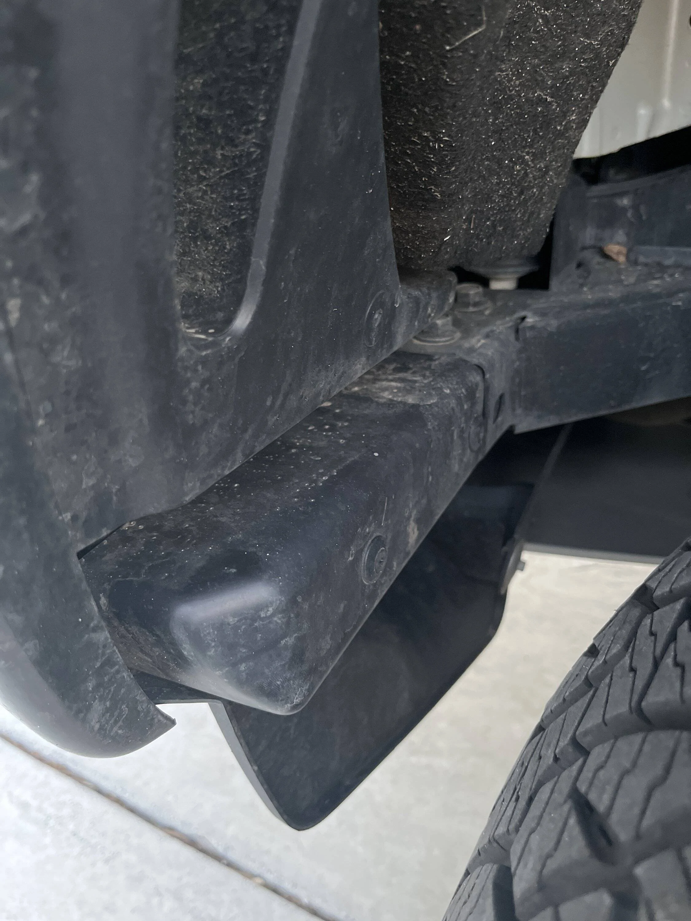

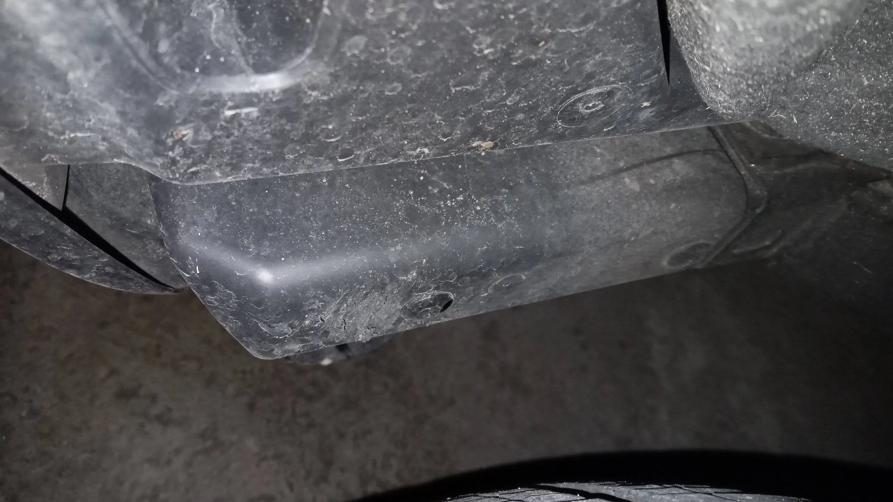

It almost sounds like it's catching the fender liner when you're turning sharp. Any way to have someone check it out while you turn it slowly in a parking lot? Maybe they can see/hear it better that way.
This - The boneheads who change my oil at the dealer didn't put the bottom 3 screws back in the rubber flaps on the inside of the wheel well. It didn't rub with my oem 255/65-R17's, but it did with my 265/70-R17's. The first thing I thought was all those guys on Ranger5G were wrong, 265/70-R17's don't fit without rubbing! (insert obscenities) But then I looked and saw the missing screw retainers, popped them back in and all was well. ?
The same thing happened to me with my local dealer. I made them fix it out of principle.

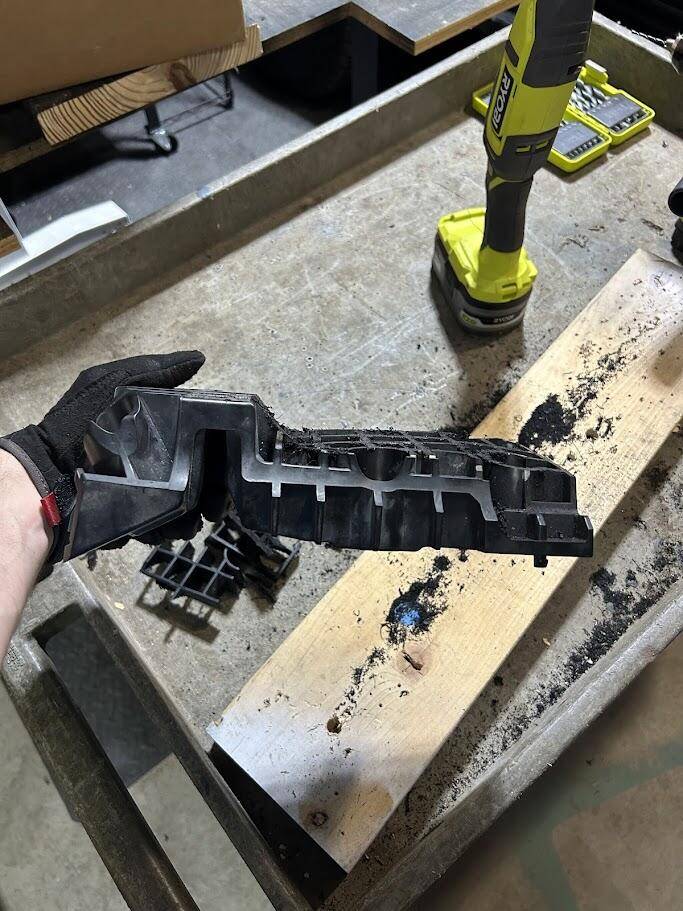

Don't know if this was ever resolved, or if the actual issue was just ABS, but wante to share a solution I came up with incase anyone else comes across. I fitted 0 offset 33s and they rub very slightly on the rearward portion of the fende rliner at full lock. I was able to use a multitool ad belt sander to reduce the tickness of the plastic block, and add rivnuts to it. I also used oversized washers and a couple bolts and now the fende rliner is pulled well out of the way.
