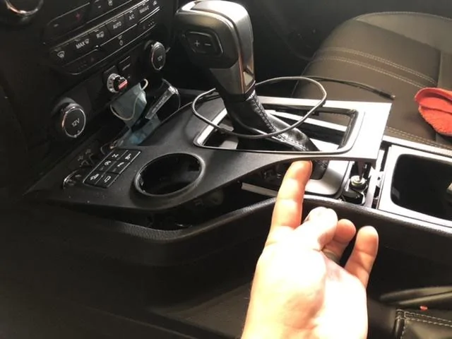

TM knob and TC switches installed. TM works as expected with the required Forscan setting. Still waiting on TC...?
I haven’t seen this pic yet, maybe it will help the next guy. This is all the panel has to be lifted to make the changes.

Seems like you did it the smart way dmeyer. I loosened up the drivers side console sidewall a little before removing the top shifter panel.
