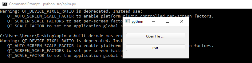

Once downloaded you will need to extract it somewhere that you will remember. Open the CMD prompt after Python is installed and change the directory to the folder. Example: cd C:\Users\bruce\Desktop\apim-asbuilt-decode-master\
After the directory is changed type in python src/apim.py
You will then see a box like this:

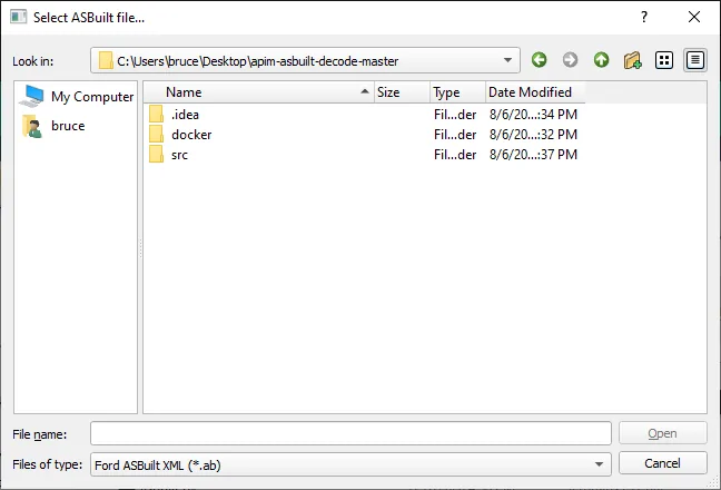

Select Open File and go to the location of your ASBUILT .ab file or your FORSCAN .abt file and open them.

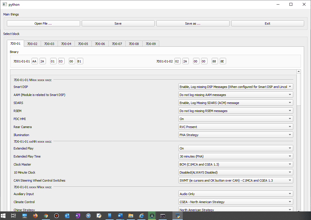

You will have to change the file type in order to see the .ab file if you choose to use that on. And this is what you see next.
You can edit and save it from here. Use a copy of the files and not the originals in case you screw up like I'm sure I will.

I really like being able to actually look at my asbuilt data without having to mess with a spreadsheet and bouncing around in forscan trying to figure out what each code is.

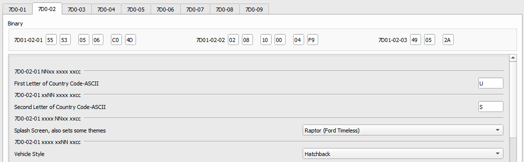

Wow - this is a great find! Very interesting - I just started looking - I'm wondering how accurate some of the info is however - this is what I got from 7D0-02-01:
Says the "vehicle style" is a hatchback - and there is an option for a pickup truck.
One other thing - if you haven't installed python before, you will also need to install pyqt5. It is not something I would recommend for someone not comfortable on the command line.

Interesting - No that was a subsequent back file I generated but I don't recall making a change - but when I loaded my original backup (before I made any changes), it shows Pickup Truck. I take back what I said... :)
