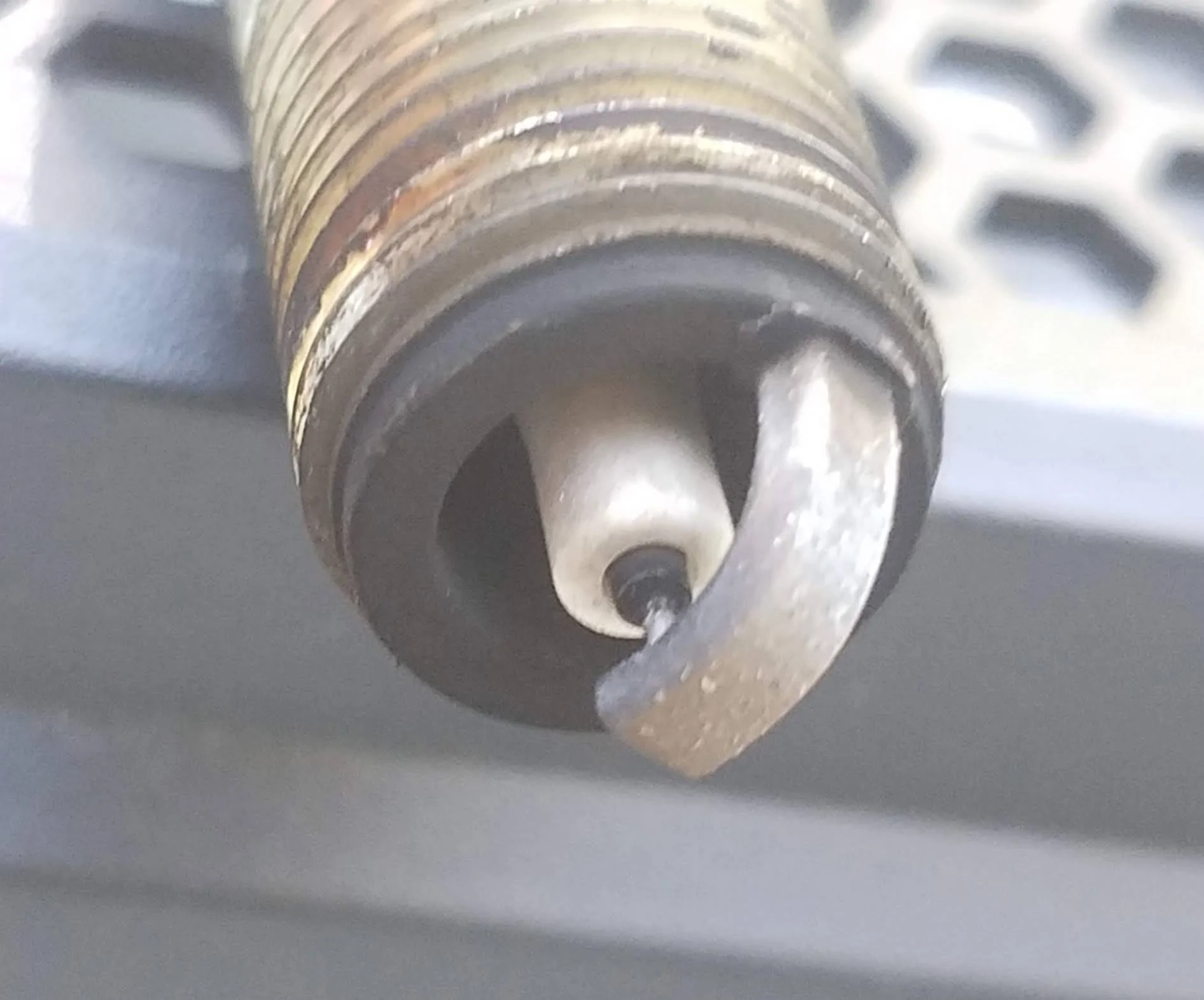

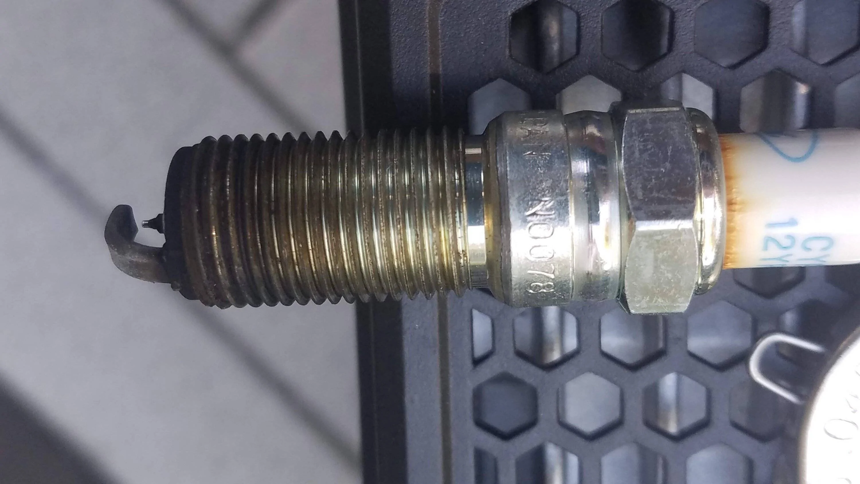

#4 spark plug (closest to windshield) looks great overall, as expected for 8k miles. The gap is right at 0.030 using wire gauge tool.
Not sure it's worth checking the other 3, as this one looks so nice...

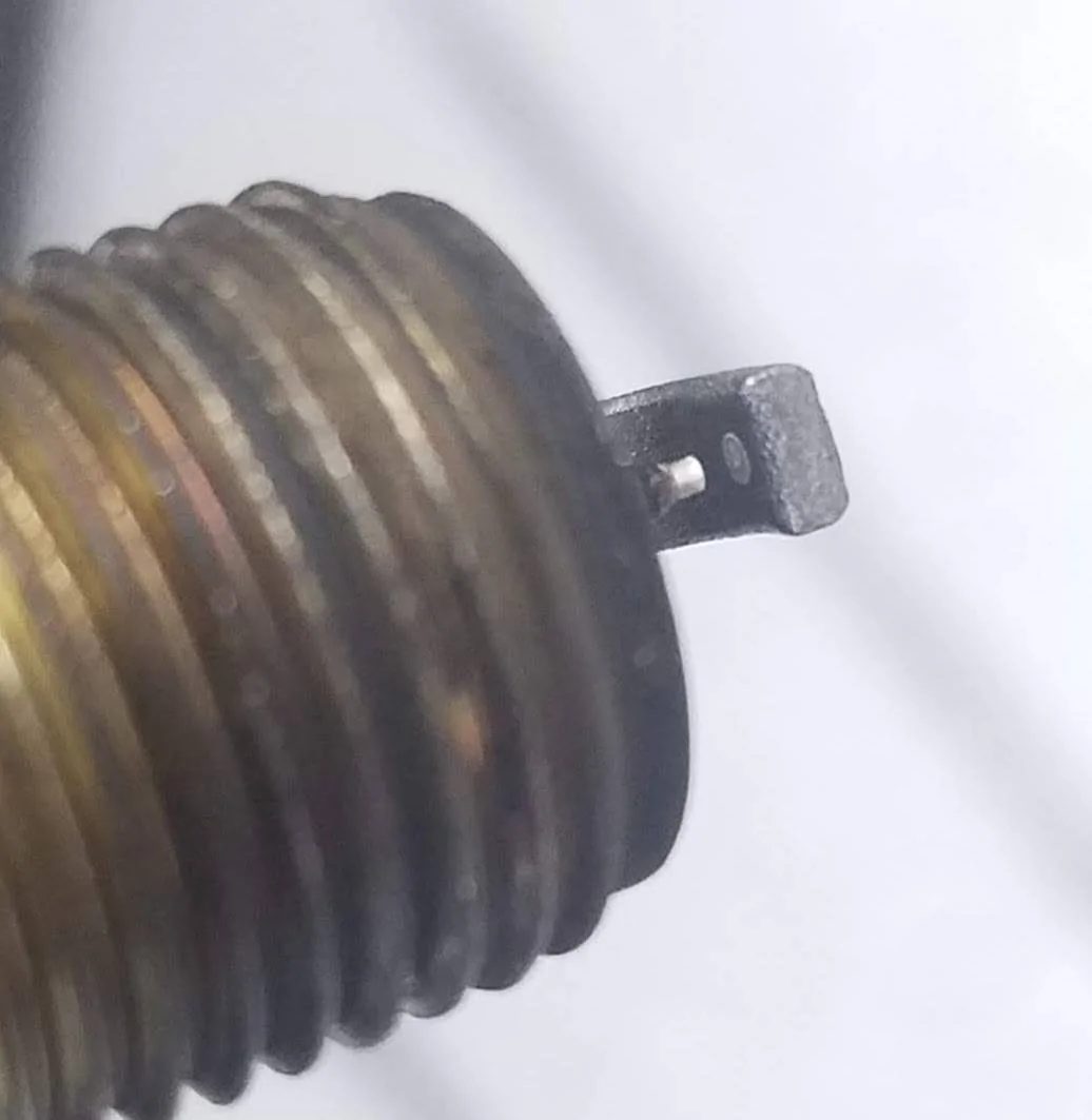

Edit: added 3rd pic based on comments later on.
Note: Ford's manual doesn't recommend anti-seize, so i'm reinstalling it dry, contrary to what i've done with other vehicles....

That looks rich to me..
Interesting; what makes you say that?
BTW I looked at this link here and here after reading your comment, and then realized that I didn't include an angle looking inwards (my bad), so here's that:
If it was me, I would change plugs and air filter as a start.
Thanks. air filter is still great condition, but I have a spare on hand and I could change it. Same with plugs: I have another set, but seems like swapping without fixing anything else would just cause the new plugs to be ineffective as well... unless you're saying that the plug above doesn't look good?

Ok that plug looks normal at that angle. Yes heat will transfer to the rim, short of a thermal camera to see rotor temperature this is the next best. Feel close to the lugs almost immediately after your trip.
