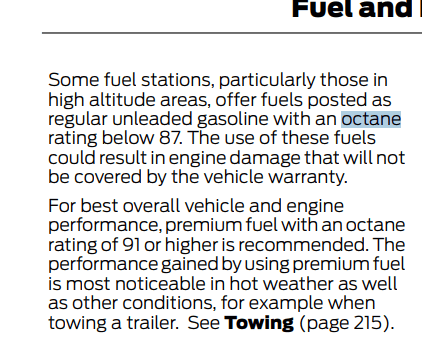

Ford has noted officially that the rated HP/Tq numbers for the Ranger are done at 91+ octane, and that 87 octane, while still sufficient to power these trucks, will give you an appreciable hit to your power and efficiency numbers (it's also why they suggest premium when towing).
Page 142 of the manual:
