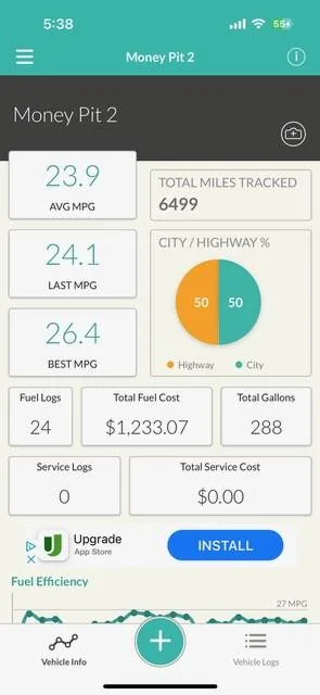

Mpg has been beat to death on here. No two people drive the same and it's going to depend on driving style, conditions, gas etc. My new Tremor has been averaging 23.9 with a best of 26.4 mostly highway driving from picking it up in WA and now while on vacation. I only use premium fuel and try to buy from top tier stations. I suspect I"ll start taking a hit now I'm back home and I'll be driving mostly short distances with the ac blasting.
