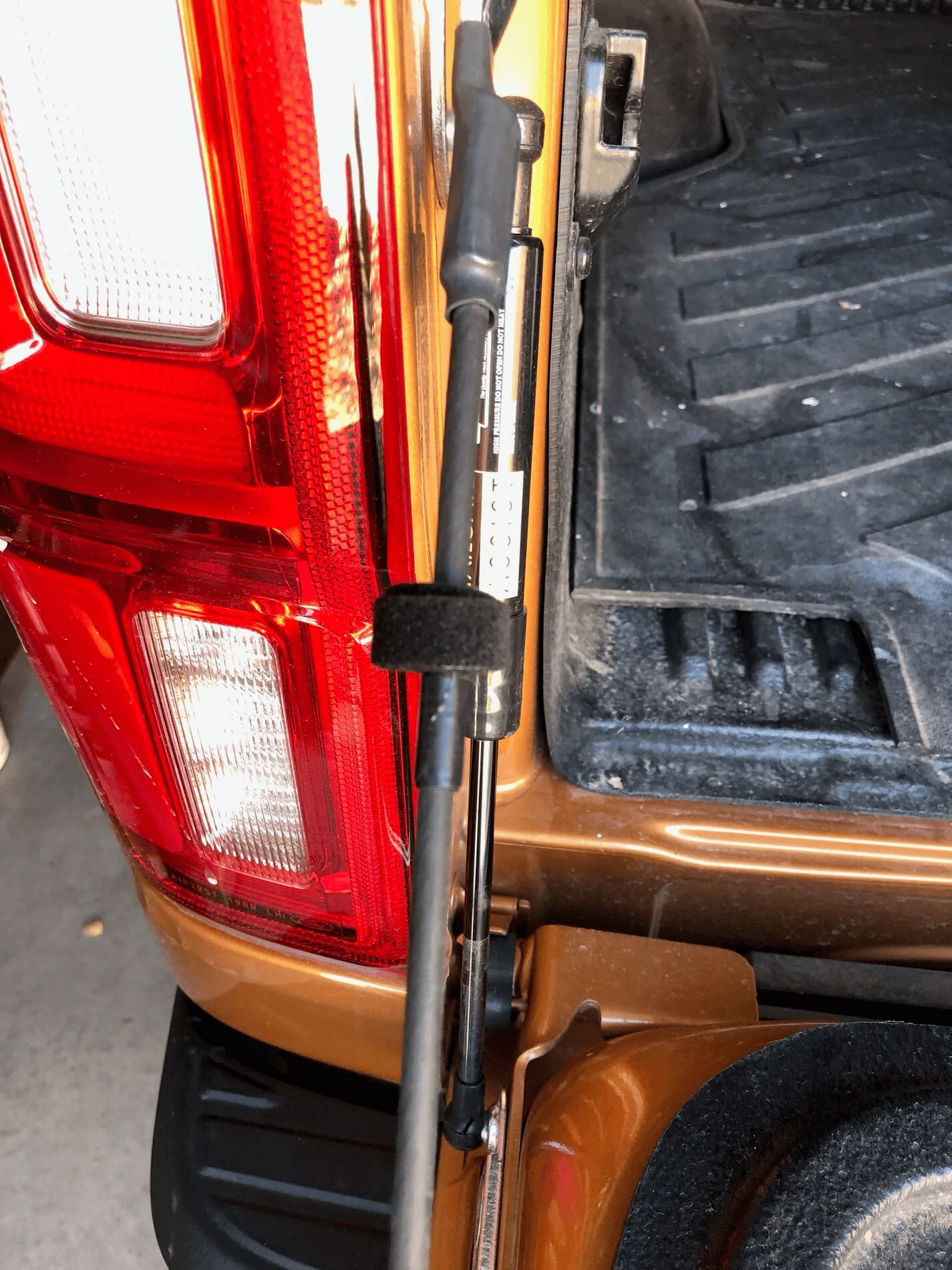

I hate doors or anything slamming or hitting the limits of travel just me from my old machinist days I guess. I have found mine pinches the tailgate cable when closing and has kinked the cable. I see no way to have this avoided so may replace the cable and remove the Damper. Love it but cant keep replacing the cables.
Hey Mel, there’s a simple fix for that….
It’s a bit of Velcro wrapped around the cable with some electrical tape below it to keep it from sliding down. The Velcro guides the cable away from the damper. You guessed it, this was all @AzScorpion ’s doing and that’s his truck in the photo.
When you think about it, and I am because I don’t have better things to do this early, the damper is a mod for the tailgate, the Velcro is a mod for the damper and the tape is a mod for the Velcro. Man, I sure hope that tape holds out or a fourth mod will be needed.

Weird! The cable on mine just kinda pops around it harmlessly.
