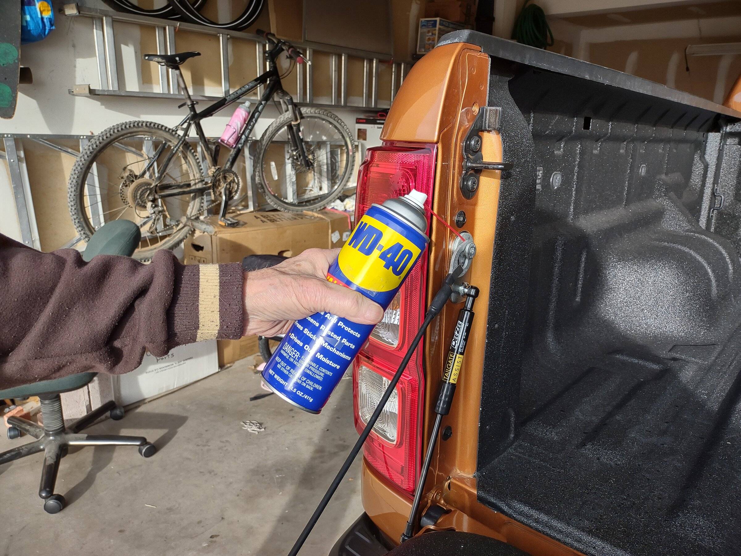

It's not the damper it's the bushing on the tailgate mount. Dirt gets trapped in there and it creaks like an old barn door. Just spray some lube in there and it'll be good.
Thanks. As in where the tailgate attaches to the bed/body?
Yes on the left and right sides you'll see a sleeve where it attaches to the side of the bed. Spray a few shots in there, move it up and down (if you have the strength now lol) and it should go aways.

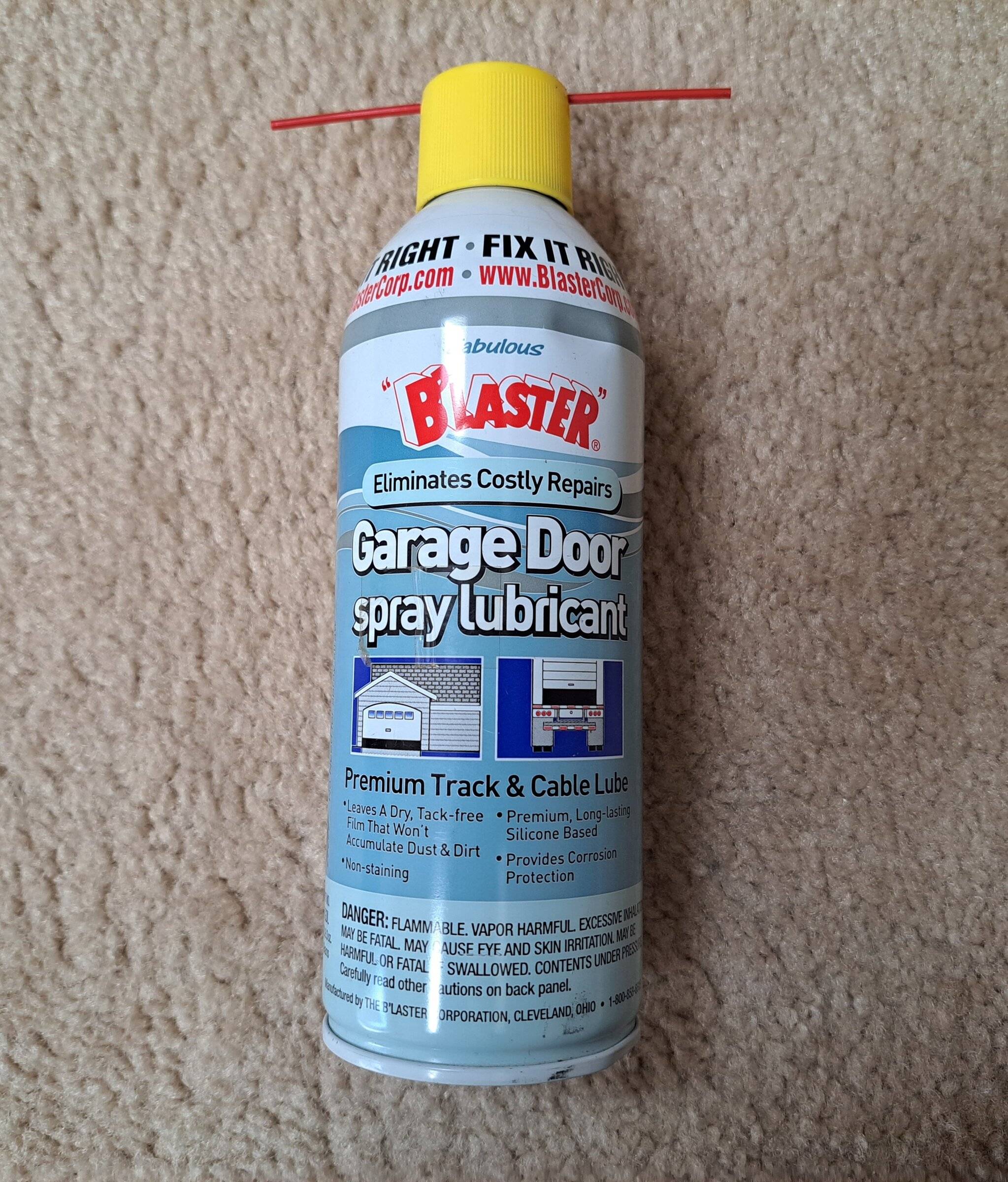

Paul, try this stuff. It works much better than WD-40 and lasts a lot longer too.
Thanks for the tip Dave, I have a can of this to lube the garage door...

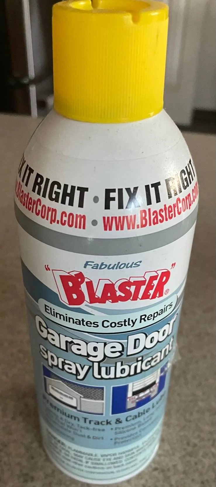

With all the dust we have here this stuff seems to really work the best. I also use it to lube the window tracks in my house as the slides tend to stick from all the dust.
We have a lot of blowing dust too. Blaster will probably drip less and stick better with the silicone base than WD-40.
