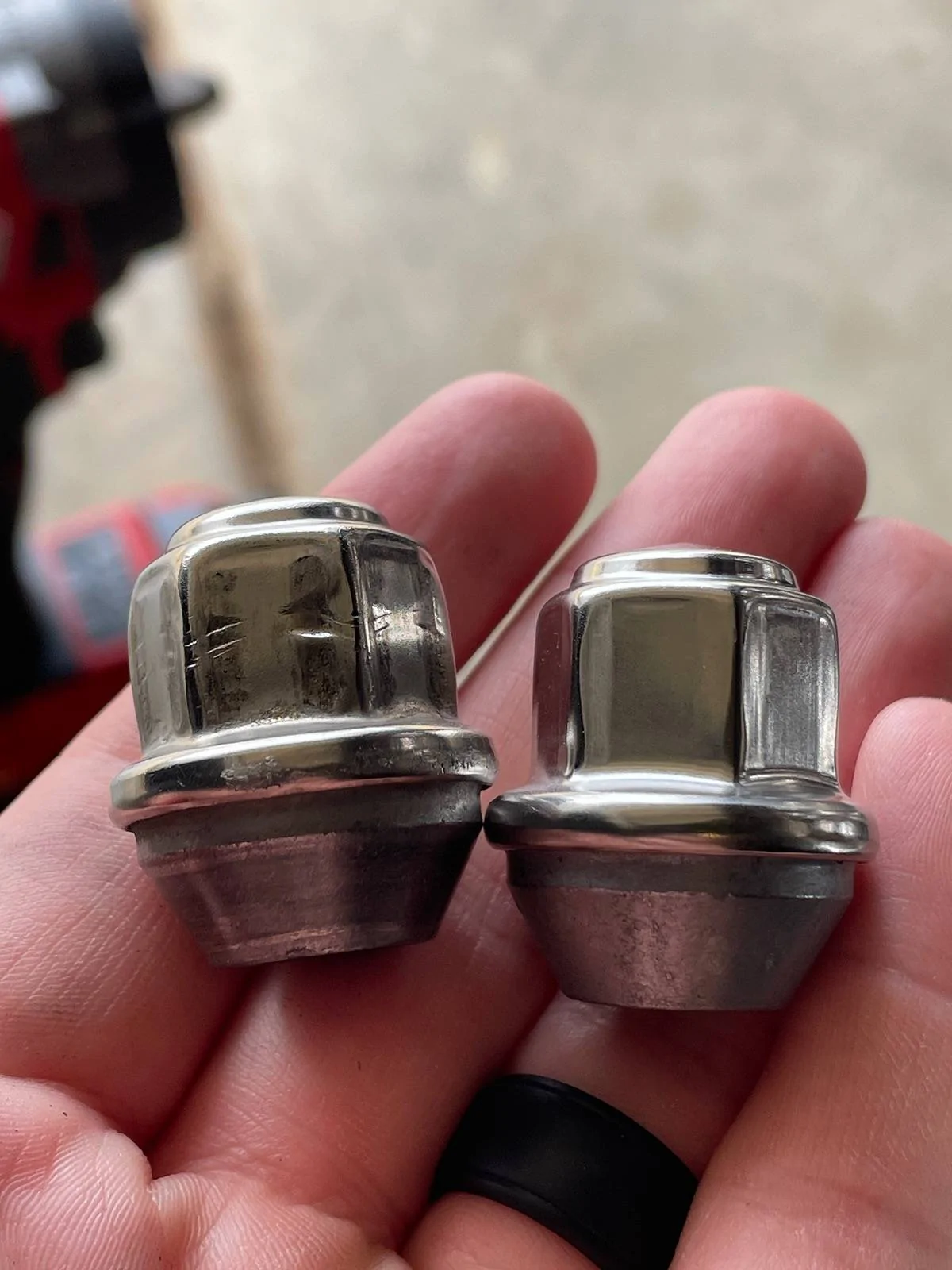

Swollen M12x1.5 Wheel Nut (ACPZ-1012-H) Replacement Write-Up
got3fords
Apr 12, 2021
131
5,326
13,839
22973
Mom Joke Professional
They should be fine ?.
You mainly need to look at the taper at the bottom where it seats against the rim and the thread in this case. The overall shape shouldn't make any difference.
That's what I figured, just wanted a second opinion. Thanks!

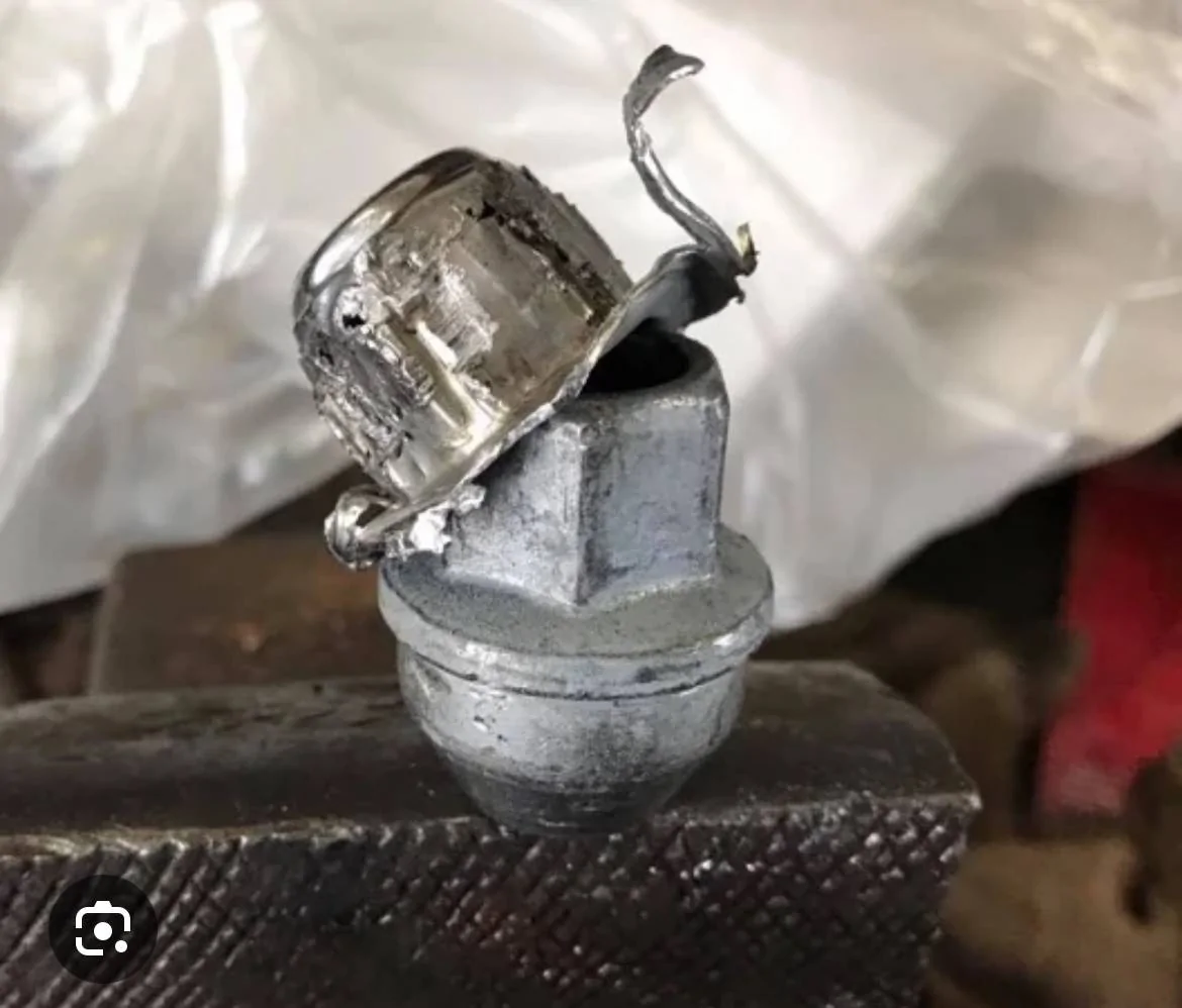

It's an old story with Ford's I had to replace the lug nuts twice on my wife's escape. I'm a slow learner. I just replaced the factory lug nuts on her new 24 Bronco Sport with one piece nut and am doing my Ranger this week. You don't want to be caught on the side of the road with a flat tire and find your lug wrench does not fit your swollen lug nuts.

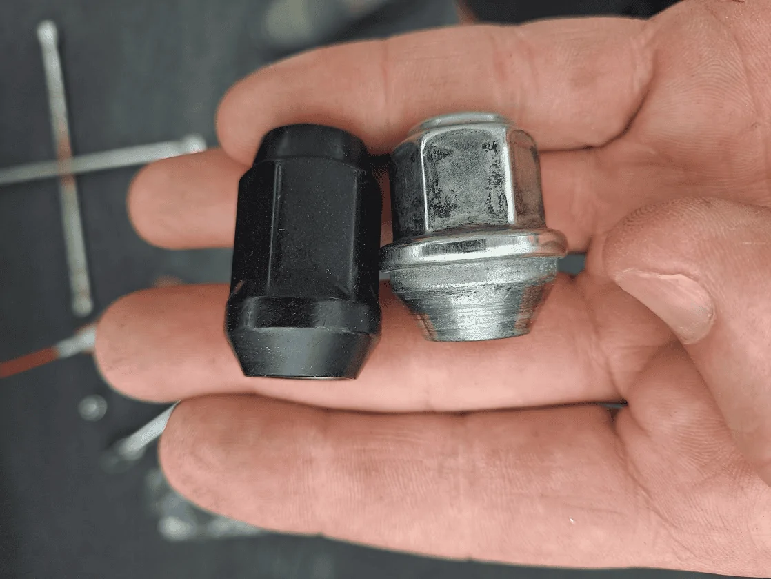

I changed mine out for McGuards soon after purchase. Changed them on my 2014 Mustang and a few were starting to swell and I live in the South.

I got my one piece lug nuts for my Ranger today after work, it took about 10 minutes, well worth the effort. None swollen yet so got them swapped out in time.
Awesome! Did you use a torque wrench? I mean, I have a history of not, but this time I actually did.

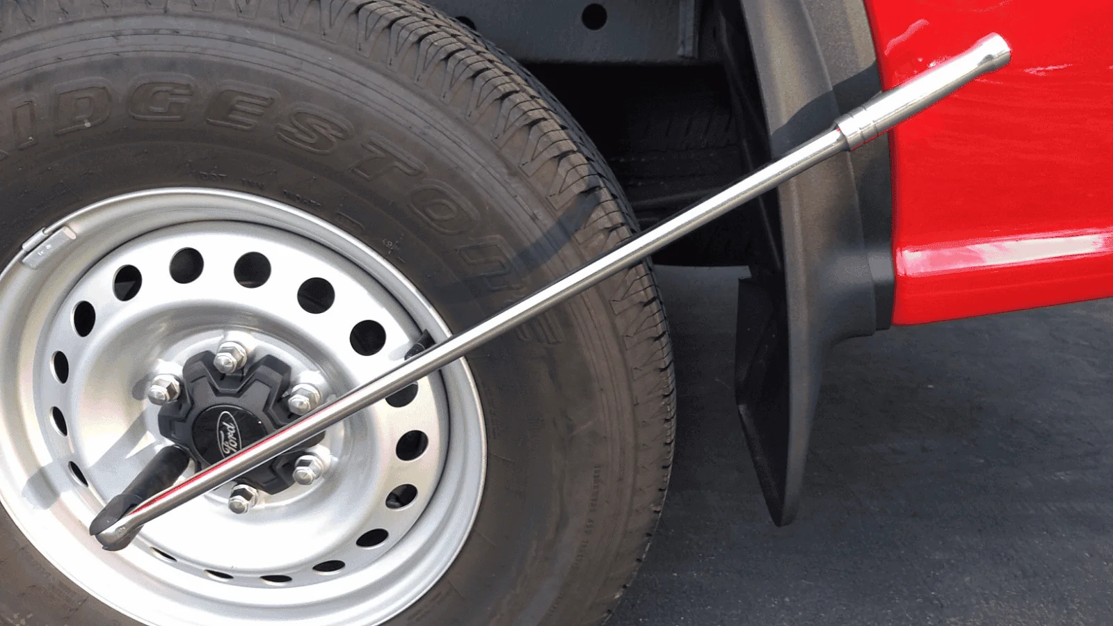

Do these McGard fit the factory lug wrench? What is the torque for the lug nuts 125 ft/lbs.?
Those should take a 3/4" wrench like factory, I am pretty sure the spec is 100ft/lb.
