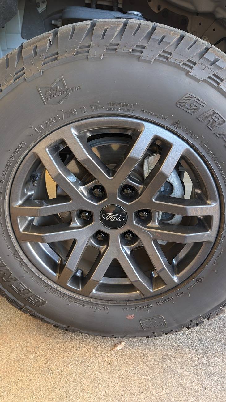

I got a set of splined lug nuts in black as part of my chrome delete project. Got a few done when I took a closer look. The bearing surface that contacts the wheel is about 1/3 to 1/2 of the factory lug nuts. I feel it should contact the full length of the available wheel surface, so I put the old ones back on. Thoughts?
I bought a similar set, with the same issue. Returned them and ordered a black standard set on Amazon, they fit perfectly.
Wheel Accessories Parts 24 Pcs M12x1.5 12x1.5 Thread OEM Style Lug Nuts 1.25" 32mm Long Black Chrome 3/4" 19mm Hex Hex Fits Ford 2021+ Bronco (NO Raptor) 2019-25 Ranger ACPZ-1012-H | 611-303 https://a.co/d/f4BiIwM

The wider ring is to hold the center plastic hubcap in place on an XL Ranger. See Step #6 here:
