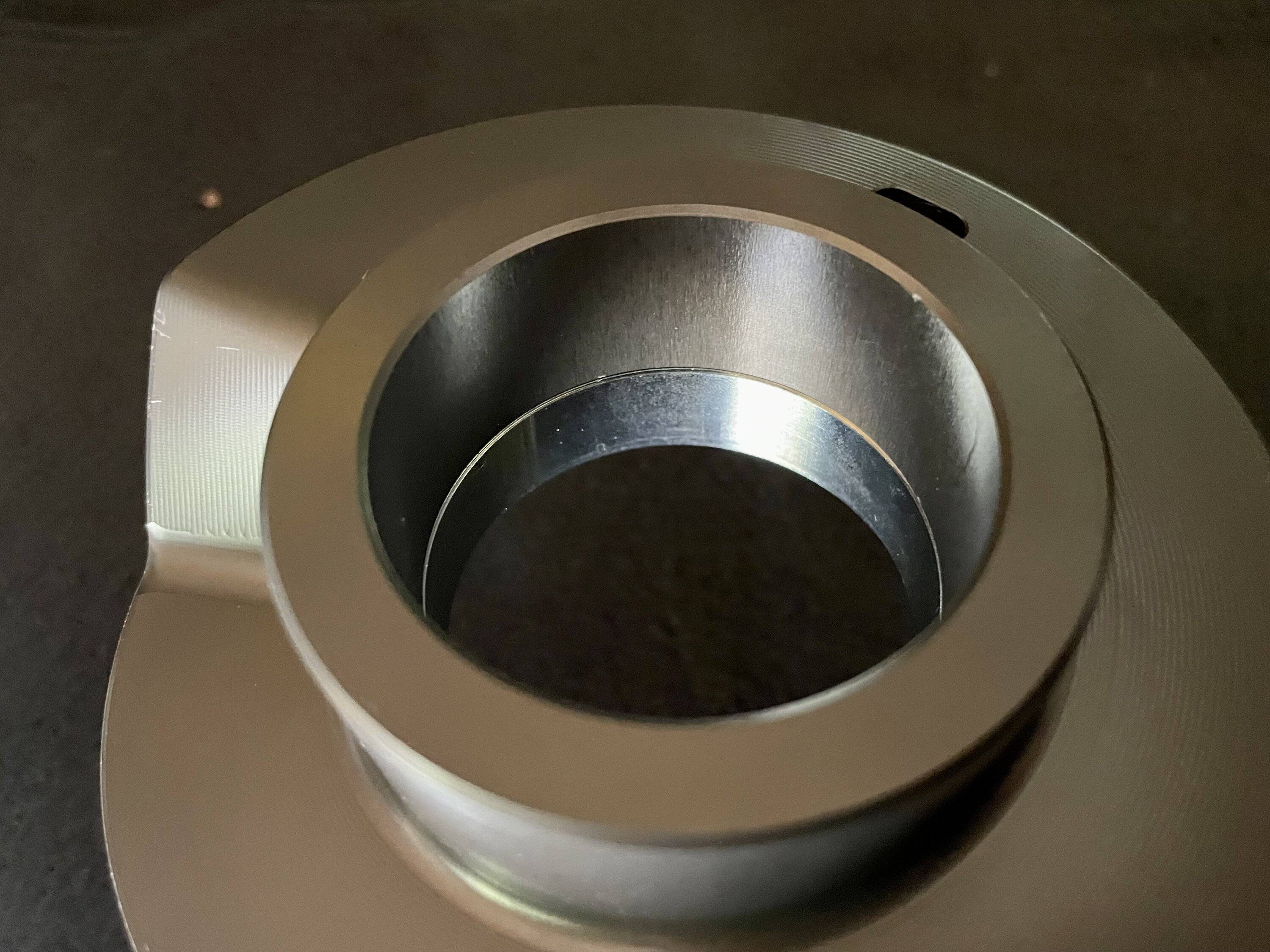

Anyone out there with experience installing this kit decide for or against the additional 1/2” perch spacer?
The kit I received didn’t come with them and Jeff from @SVC Offroad was nice enough to send a pair along. They arrive today. I don’t see any info/pics/videos of anyone using them anywhere on the interwebs. It must have been a late addition to the kit because it’s not in their instructions either.
They’re getting bolted on this Thursday one way or another.
Pros and cons?
Pairing up with 265/70R18 Wildpeak + 1” Bora wheel spacers on Lariat wheels.
Appreciate any input or feedback.

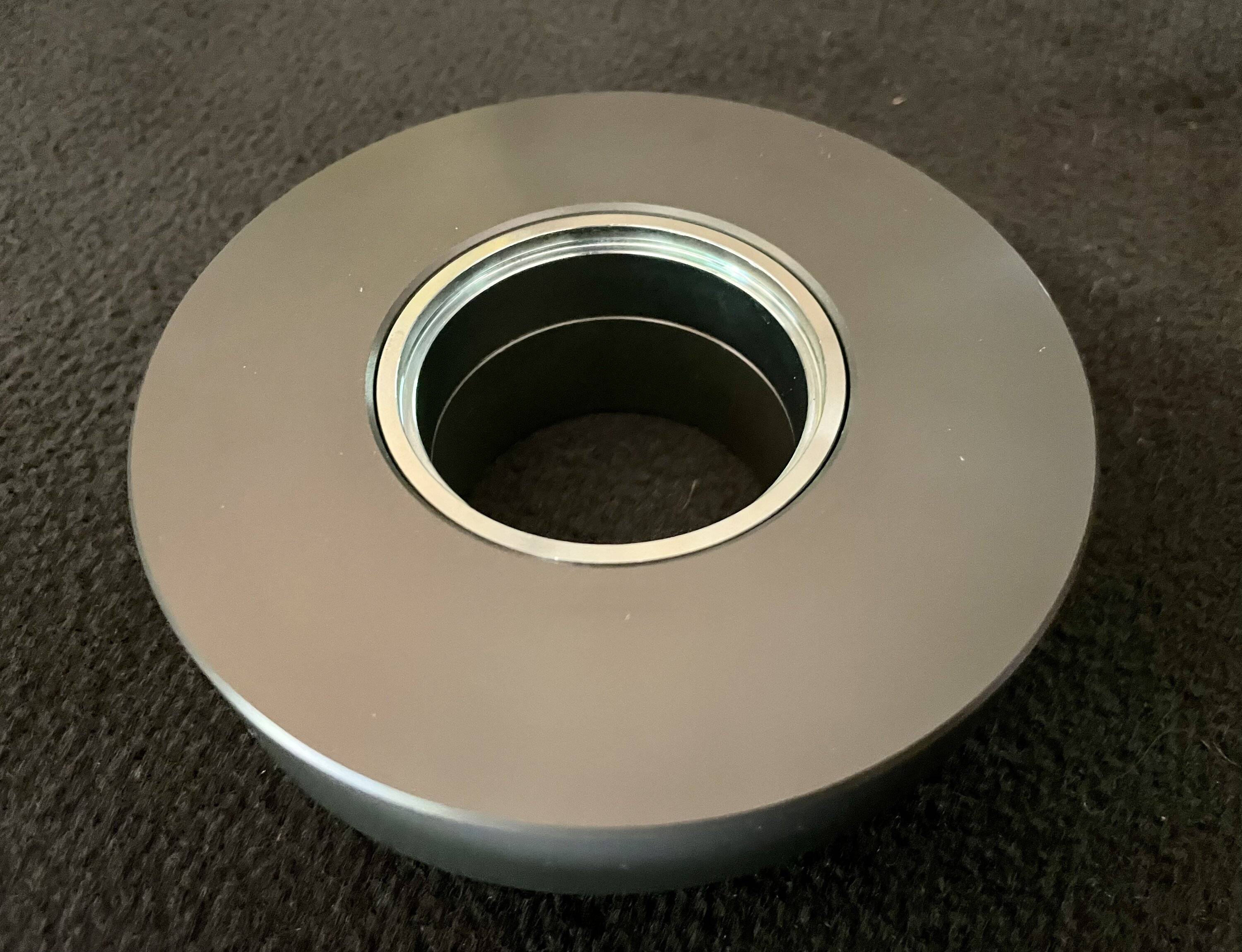

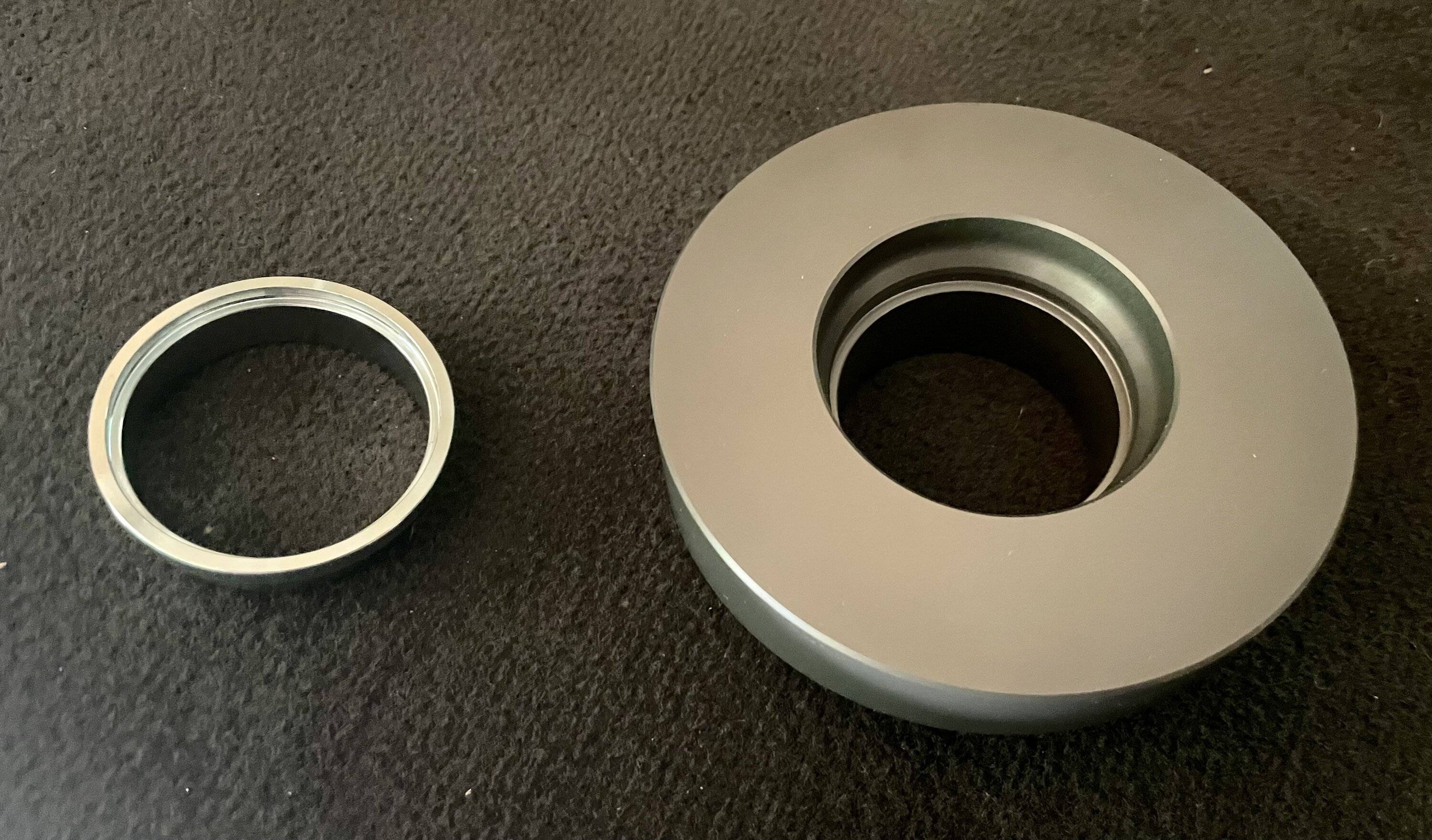

Received the perch additions. It was really nice of them to include 1/4” as well as 1/2” option. It’s perfectly designed to fit inside the main collar which would push the bottom of the spring that much further up.
The main collar measures exactly 1” without. I’ll be sure to take hub to fender measurements before and after.

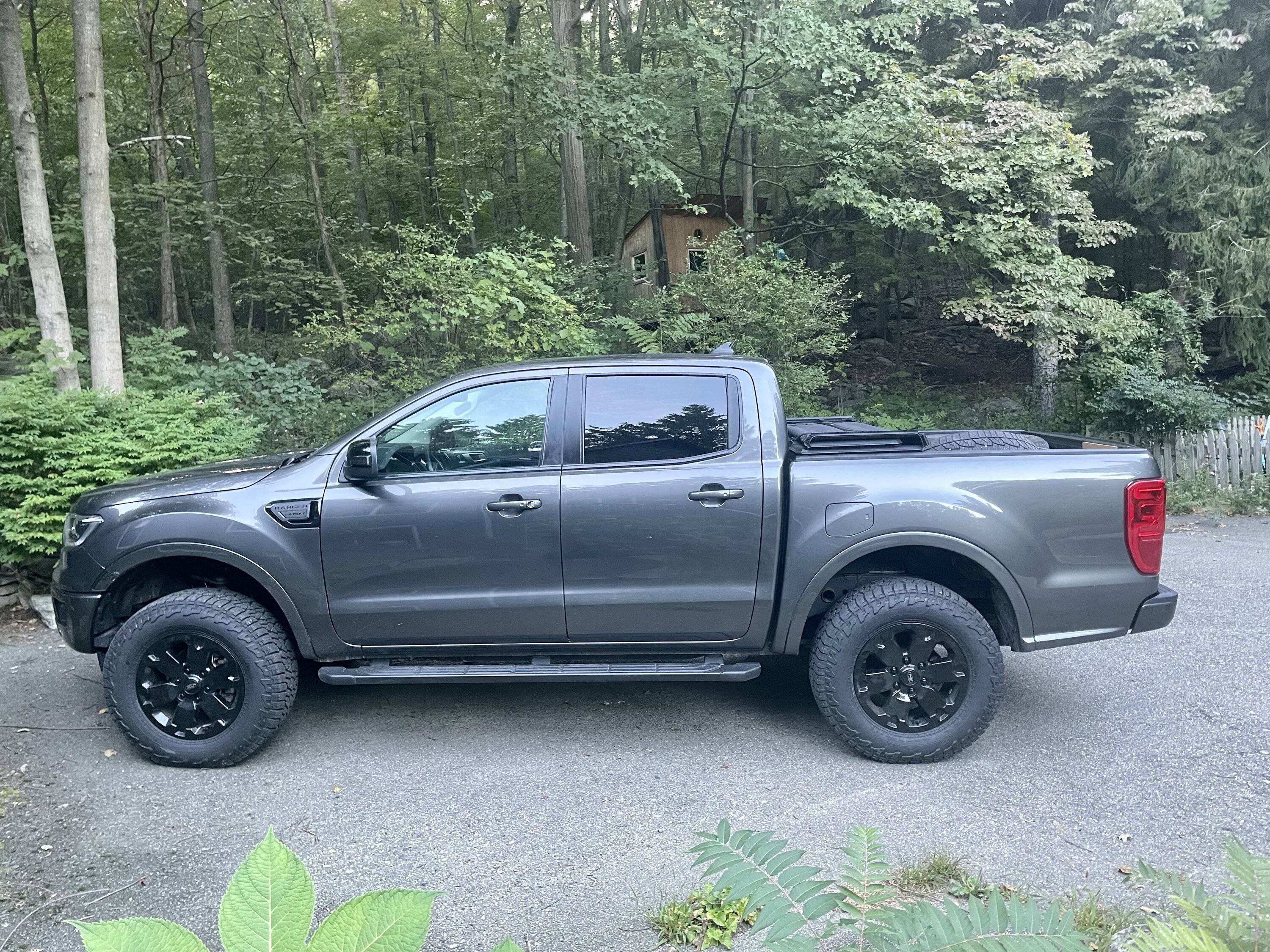

MUCH BETTERER!
Falken A/T3W: 265/70R18 + SVC Perch Collar with additional 0.5” spacer + Bora 1” wheel spacers.
Stock height:
Front: 21”
Rear: 23.5”
After:
Front: 23.5”
Rear: 24.5”
So, 1” gain from the tires + 1.5” from the collars. That means I gained some decent ground clearance. I’m happy with that. I did have to remove the plastic covers on the front crash bars. I’ll do some compression testing, but, I think I’m in the clear. I guess getting the BDS kit would be added assurance.
2500mm pretty much dialed in the speedometer (always 4-5% less than actual which was 2601mm). I need some highway GPS tests. But, it’s close enough for now.
Now I gotta adjust the headlights.
FWIW: I’m glad I had professionals disassemble and reassemble the shocks. As someone that likes to wrench these types of projects - it was reassuring that it was beyond my capabilities with the tools that I have. The technician is a good buddy of mine and he said he’s never worked with such strong springs. That being said, it’s a regular shop and not an off-road shop. But, the spring bent the forks on his several thousand dollar machine. Glad I didn’t try and prove something and use an Amazon special.
