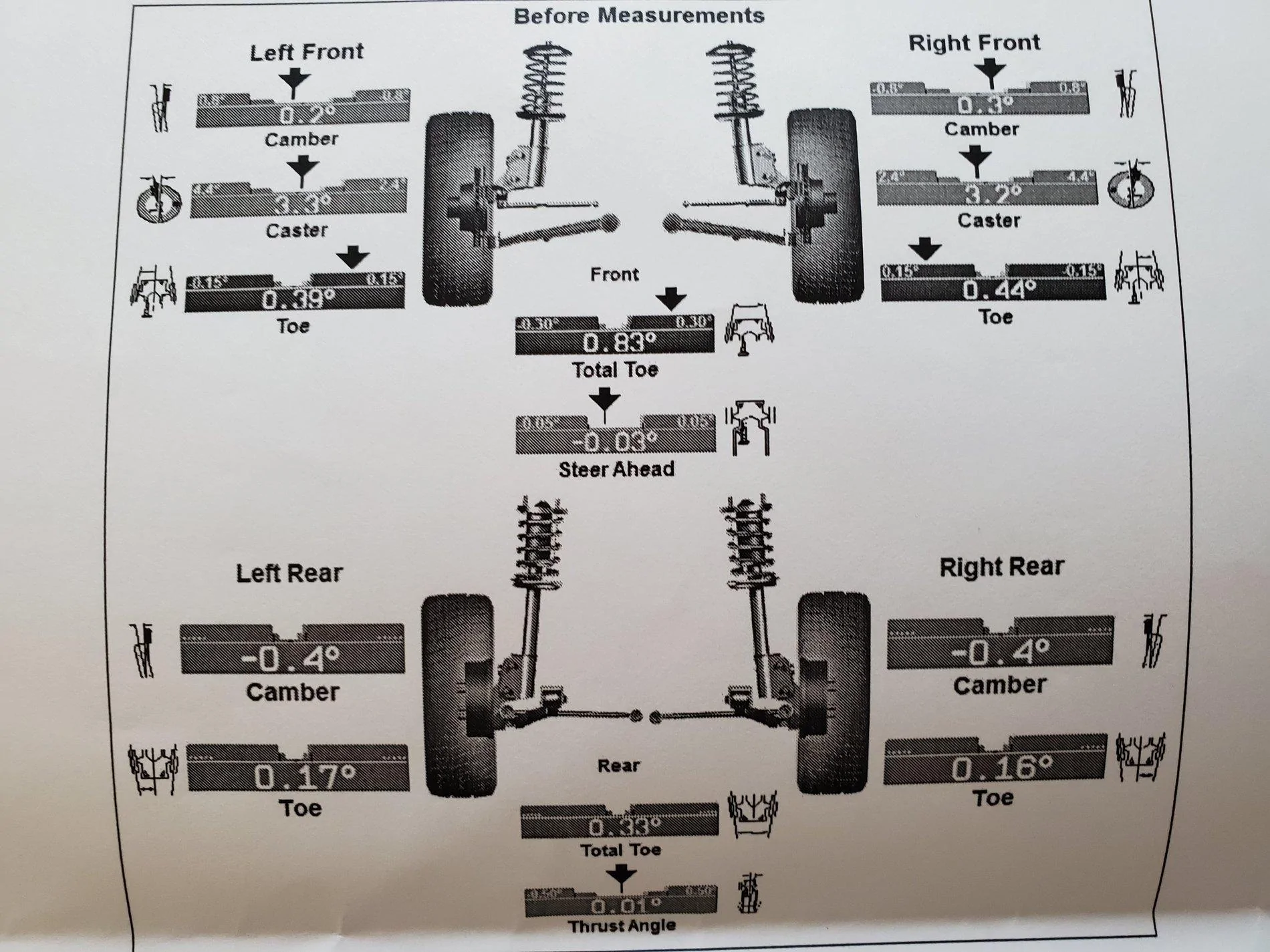

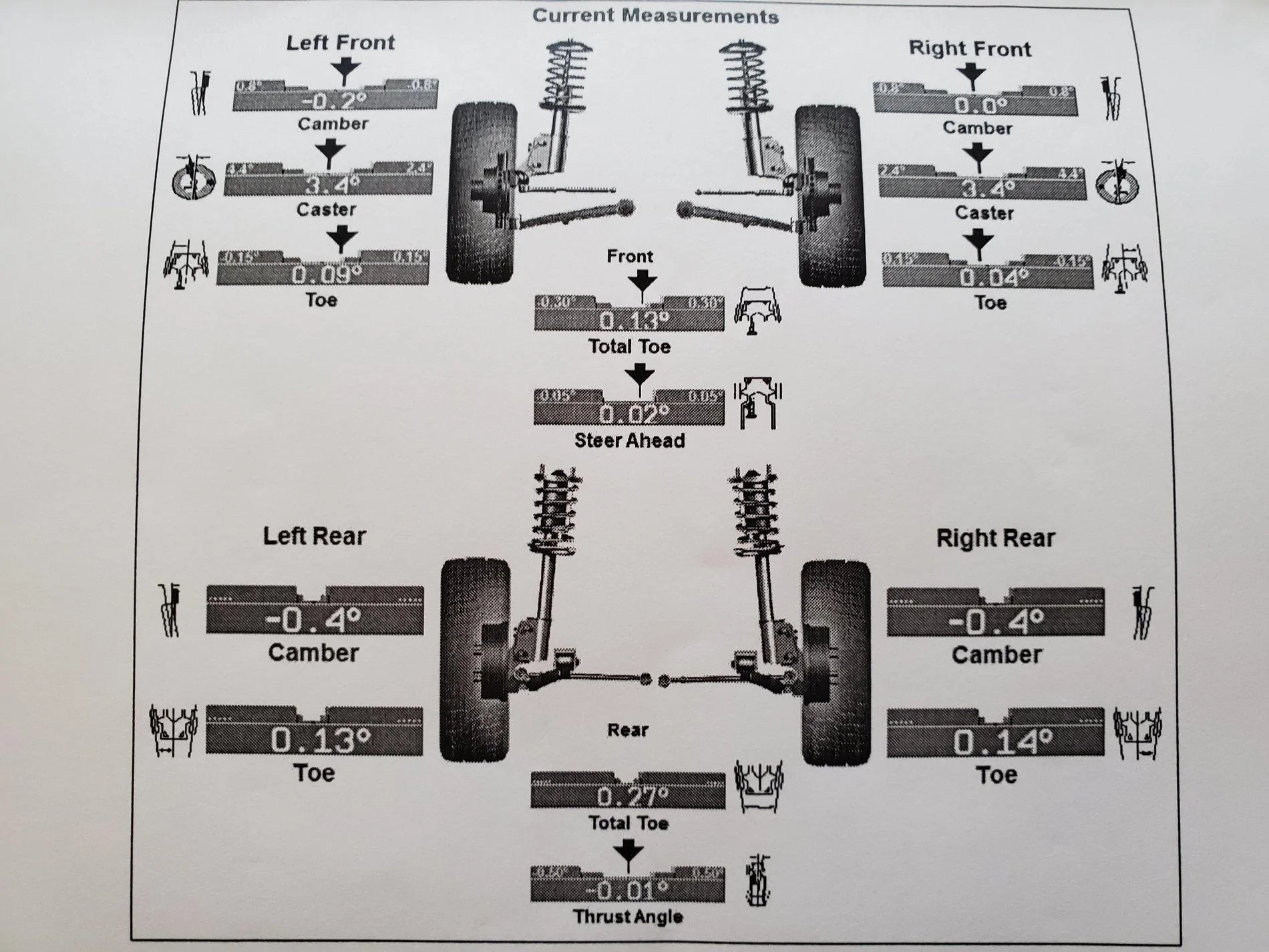

The sad part was that no one would put it up and check the existing settings without a "2019 Ford Ranger Spec" safety net.
Finally went down to a small shop my buddy gets his (bmw) racecar suspension adjusted at....
They threw it up, I showed them the spec numbers from another thread. We checked out the existing.
Not a camber issue, a toe issue.
Before:
After:
Now, what we tested was how the camber and toe changed with a driver inside so that's why the printout has slightly different values on driver side.
With a driver in, the camber/toes balance.
We also tested the effect of additional weight in the back.
All in all, additional weight in the bed will slightly change the camber positive and the toe in a smidge.
Breaking does the oposite.
So it would appear, all things being equal, that raising the suspension dramatically affects toe-in and will wear the outer edges.
