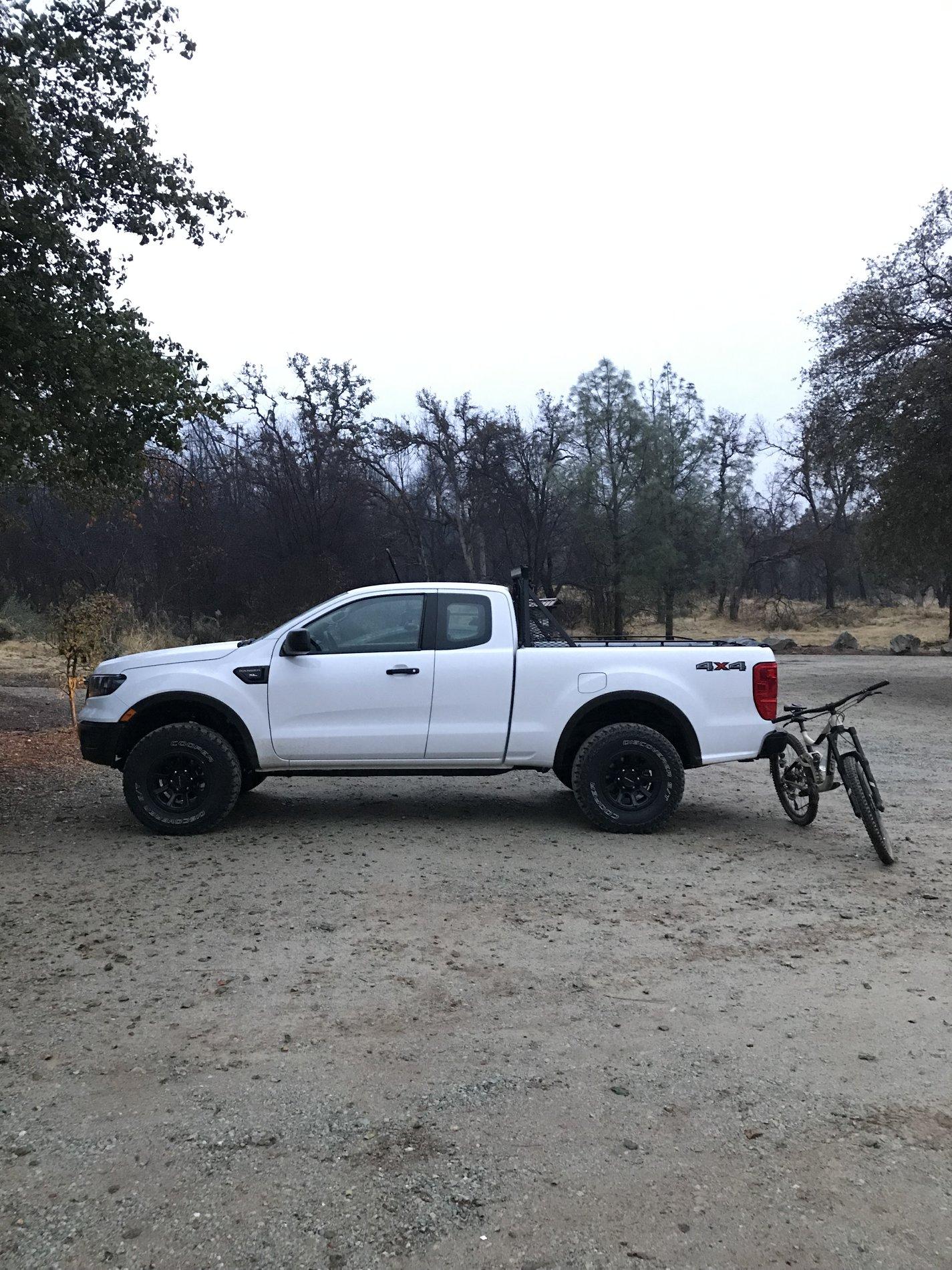

This goes underneath the spring, not on top of the assembly. You have to completely remove strut assembly. Iā€™m loving my SVC leveling collars, I feel like the truck needed the front end firmed up, have put about 3000 miles on it with a decent amount of off-road abuse. Very happy

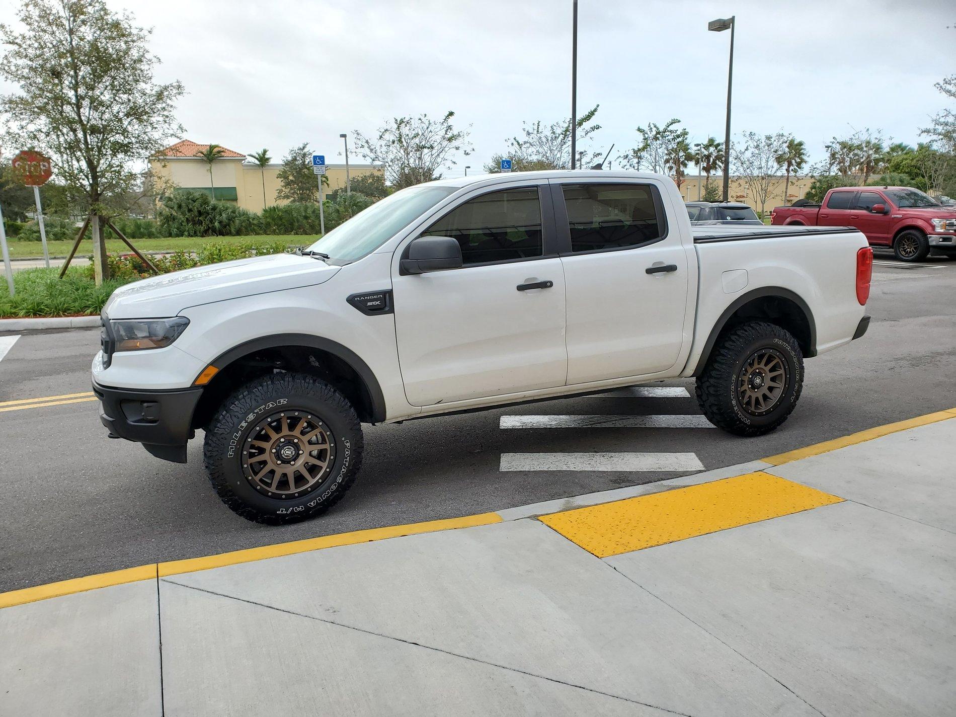

Have had mine for about 4K miles now. FX4. Including light offroading around the mountains of NC.
Zero issues and no creaking yet!
I put 8k miles on mine so far.
The ONLY issue is that it made my front camber a little positive and that made my outside tread wear faster than the inside.
Im in the process of getting the camber put more negative/neutral.

2019 Ranger XL Oxford White
You never got a alignment after install?
The truck rode perfectly straight.
The positive camber was hardly noticable.
Plus none of the quick-alignment guys have the "Ranger Spec" and I'm trying to find a real shop that will just adjust it manually without the "Spec" info crap.
Also it took 8k miles to really show up and it's not like it made the outside bald just that it wore a little more than the inside.
