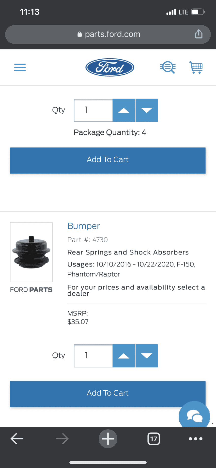

APG includes Raptor stops with springs. If I wanted to try that, what Raptor? Ranger or F-150?
Not sure about which ones APG offers. But I did these with my global springs.
They're from a second generation F-150 Raptor. A slight bit of surgery was needed, a locating tab needed cut off and a bit of paint over the cut. They match up well with the extended travel and extra thickness of my global spring.

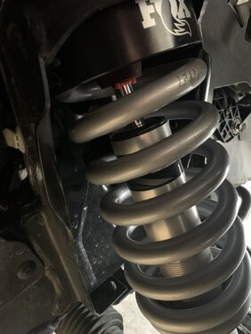

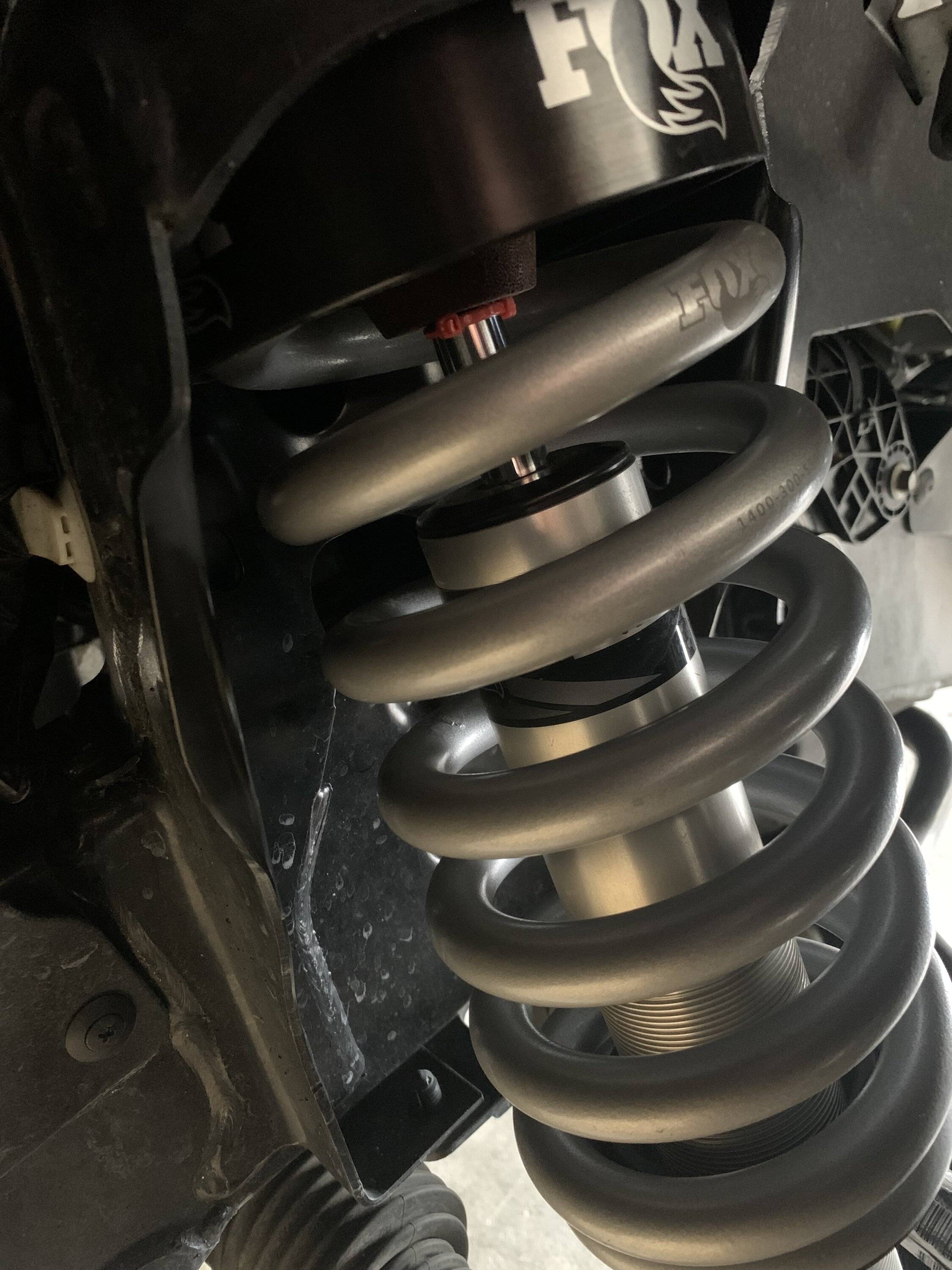

I'm attaching a shot of my Fox 2.0 coilovers with Icon UCA's. The shock is bottoming out. Notice the zip tie on the shaft.
I installed as delivered, it raised the front to level out. Looks to me like I should put some turns to the Coil support on the shock body.

Yep, I bought the ICON Stage 2 kit when it came out... 2.5 internal res coilovers, tubular UCAs, 2.0 rear shocks. It raised the front about 3.5", just a tad higher in the front than rear. (I have the APG ProRunenr kit now with the same ICON coilovers, so i'm pulling from memory on the original setup.)
If your shock is bottoming out that means a) it could use more preload or b) the spring rate is too light and you need a stiffer spring.
Check with Fox on how much preload you can add... most manufacturers have a specific range to follow. If you add the max preload and you still bottom out, then you need to go up in spring rate.
Just a guess, but it looks like Fox 2.0 has a 550 lb spring rate judging from the part number on the coil. (1400.300.550). It's almost identical to Eibach part numbers (1400.300.0550s) so they are most likely Eibach springs rebranded for Fox, which is what most all suspension companies do. My ICONs came with 650 lb springs and they were perfect IMO until I added a winch and bumper. I went up to 700lb springs from Eibach and backed out the preload which seems to be perfect now, but still more testing to do.

Great technical input. Good info to have. I emailed my issue and a pic of the front coiler to Stage 3 , and got a response from Chris. He doesn't think it looks right. I might have to pull them and add preload. I'm waiting to hear back.
