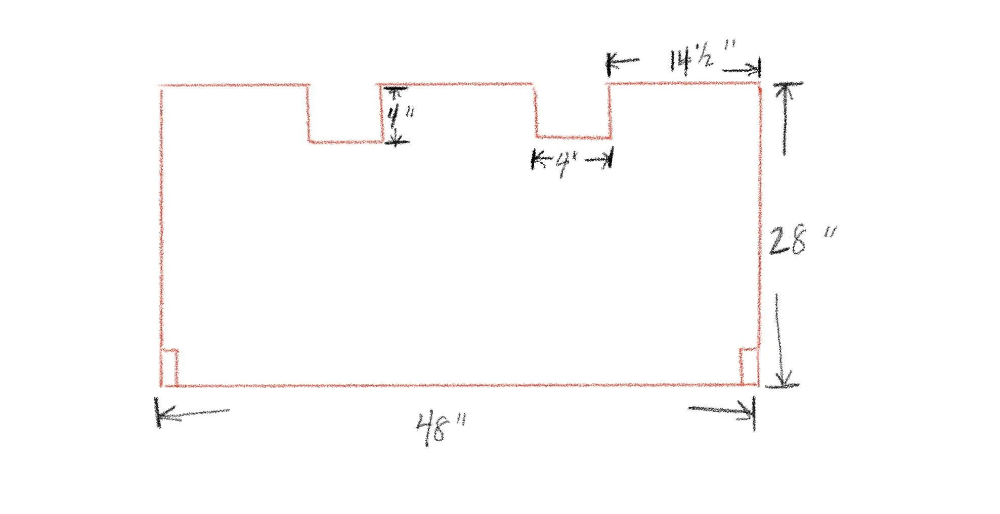

Wanted to share a quick project I completed and some of the specs in case anyone is looking for some ideas.
this is a plan for a platform with the rear bench still mounted not deleted.
Build list
- 3/8“ plywood sheathing
- outdoor indoor carpet (Crestline grey from Lowes)
- carpet tape
- staple gun
- 2x4 for legs
- 3” wood screws
- nite Ize rubber twist ties. Optional
Notes

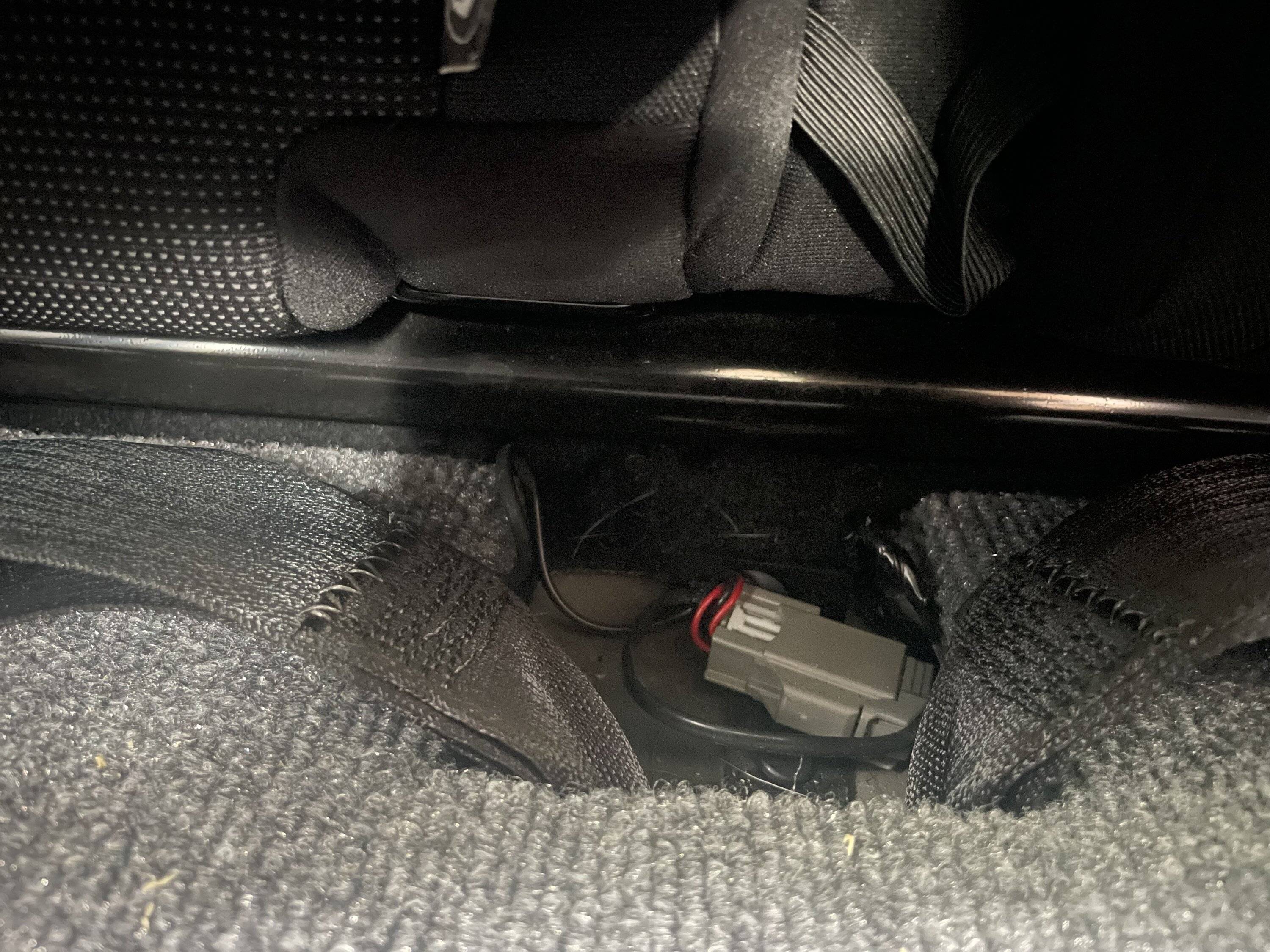

- platform fits the inner width of rear seat bar. You can see bar when seat is folded up.
- platform can be taken in and out at current dimensions without adjusting seats
- I have two rubber twist ties securing the platform to the rear seat bar. Drilled two holes in platform and then twisted around the bar.
- platform leg height will vary depending on your floor mats.
- seat belt cut outs provided in drawing.

Very nicely done. And super job on your finishing.

looks nicely done, I may be copying this, thank you!
