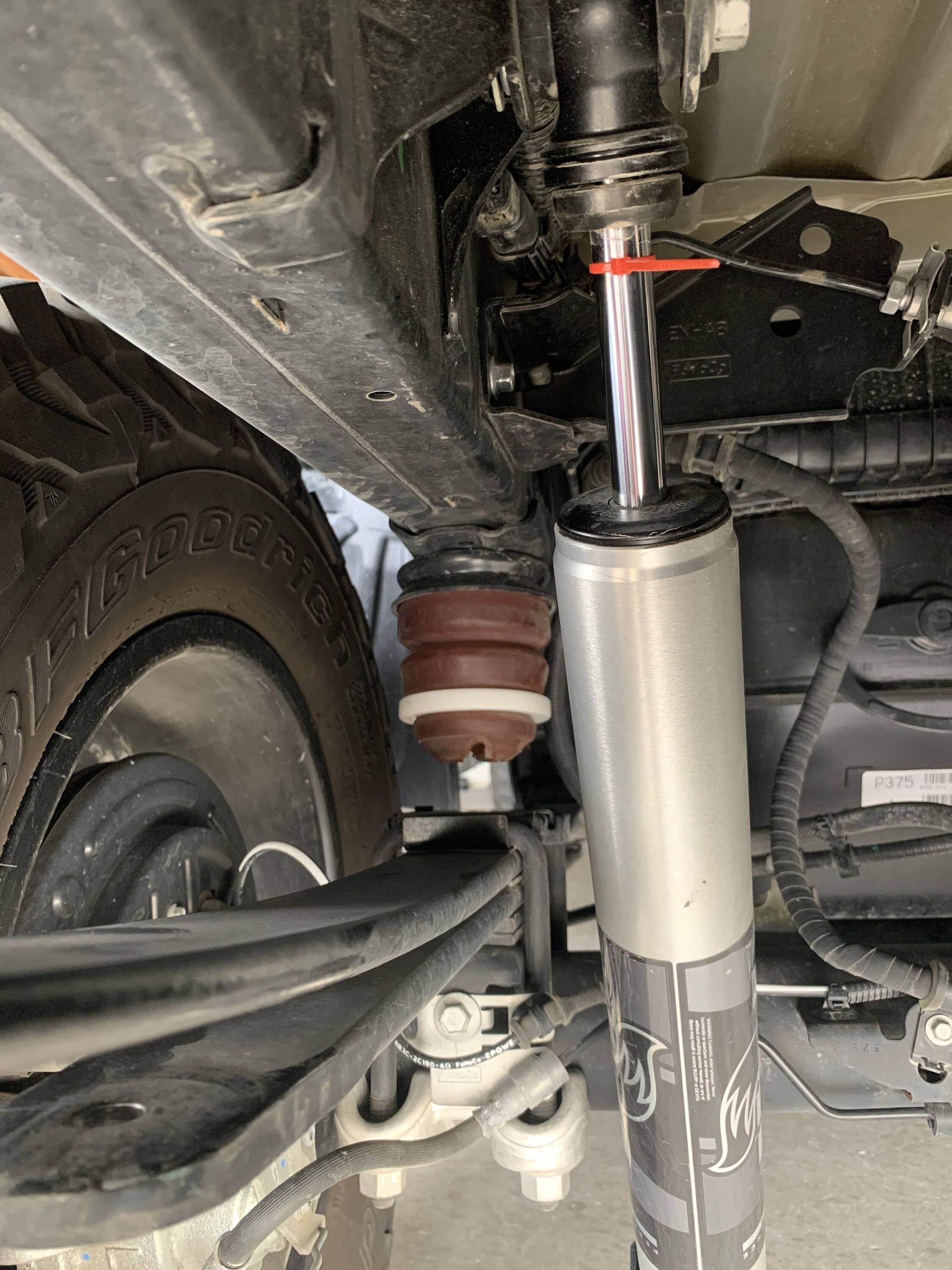

I have a 2020 Ranger XLT 4x4 Supercab with Fox 2.0 shocks and Icon UCA’s.
My wife doesn’t like riding in the truck because of the stiff ride.
I’d like to swap out the rear springs to smooth out the ride some.
I know APG Deavers, OME and Icon have aftermarket rears. I also have North County Spring that could build a pack.
All it takes is money.
I’m wondering if removing the stock bump stops will eliminate that hard hit the rear takes. Has anybody tried that?
Removing bump stops would not soften the ride unless the truck is loaded to squash to the bump stops. Only other ways the bump stops would come into play is if you hit a SUPER big bump.

Ive been playing with it. I think when the top leaf contacts the bottom, stiffoverload spring it stops hard. That happens about the same time it contacts the bump stop. And only leaves about 1/2” of shock shaft before that bottoms out.
I don’t want to trim or eliminate the bump stop, I’ll need it to limit shock travel and help with loads.
It is what it is. I’ll just have to swap them out.
When I did my rear suspension, Fox 2.0 and Global leafs, I also swapped out the bumpstops for Raptor bumpstops. Not sure how they'd work with the factory suspension, but they might be an option for you, Icon as well.
