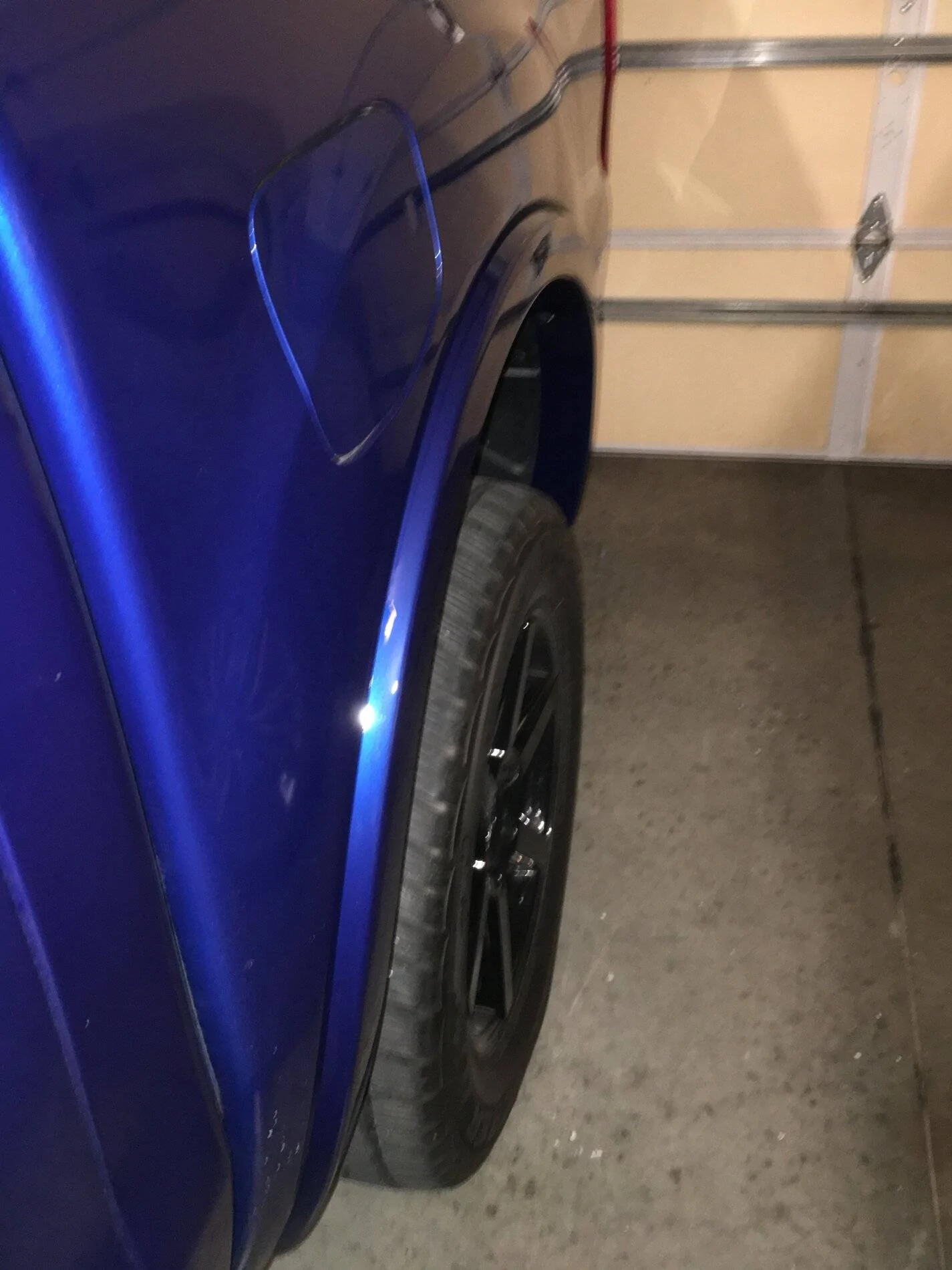

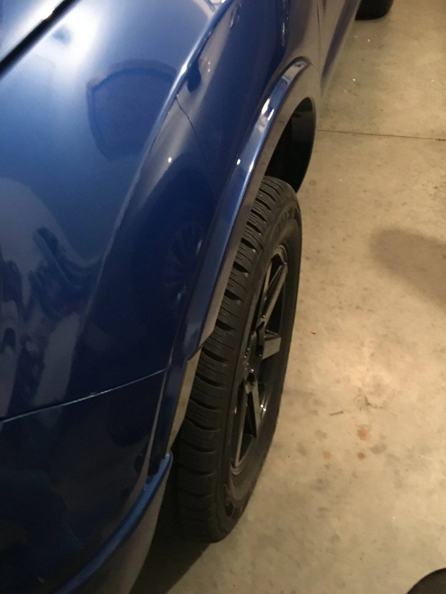

First, a caveat---This is how I do it....I've been doing it this way for 7-8 years with very good results. And the best part is I use rattle-cans that anyone can buy. I've had people comment that it looks just as good as the factory paint, even my uncle, and he's a real stickler for detail and will tell you the way it is, aka--no sugar coating. I've done the fender vents, the grill, and now the Tremor fender flares on my Ranger as well as other parts for other trucks I've owned. I will update this with some pics of the Tremor flares after I get them installed.

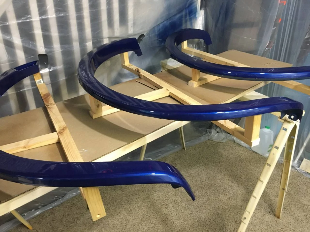

4--Painting. Make sure the paint you use is compatible with the primer and paint it in the same position that it will be on the truck....if it's a hood scoop, paint it laying flat on a table, fender flares need to be "hung" vertically--this is so the metallic particles (if your paint has it) can settle correctly.....yes, it will look bad if you don't do this. It's hard to describe how to paint, so just search YouTube. The basics are still the same, except, you can't adjust the fan pattern or the air or paint flow with a rattle-can. It really is "ya just have to try it to do it"... Follow the directions on the can....hold 6-8 inches from the surface and move in a sweeping motion with about 50% overlap, blah blah.....

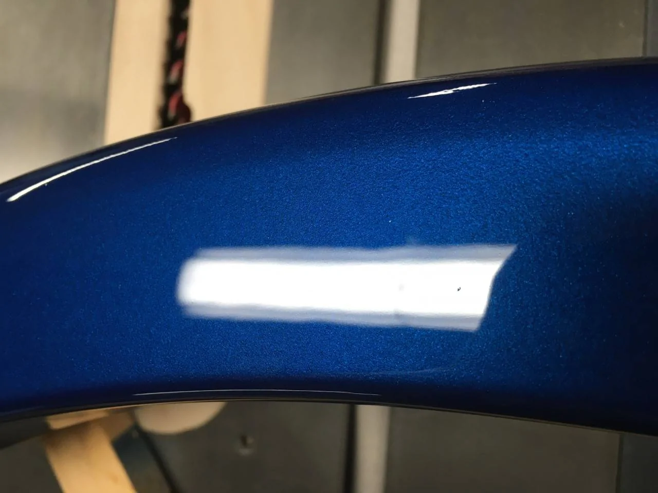

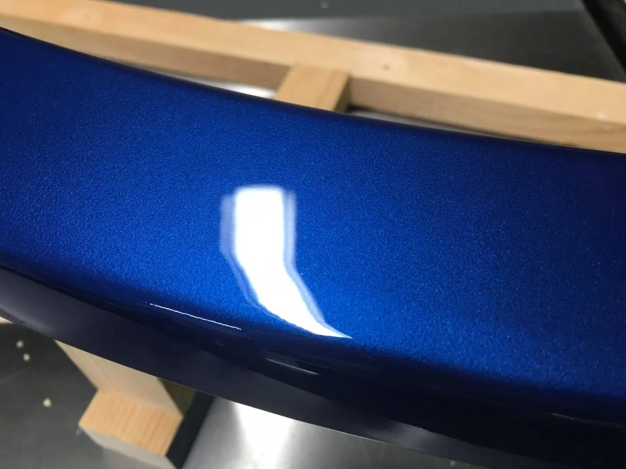

First, lightly wipe the part down with a tack clothe. The first coat, all I do is try to cover the primer by 50-75%. Let it flash for 15-20 min, add another coat that will fully cover the primer. At this point, I take my LED flashlight (on the 1000 lumen setting), and shine it on the paint and see if I can see the primer through the paint, and if I can, add another coat all over it. Let it flash again, and then re-check it with the flashlight. I do this until I can't see ANY primer, and then add a final wet coat...a little heavier/thicker coat....be careful, because this is where you can easily get runs in the paint. I let the last color coat flash/dry for about an hour before I clear coat it.
5--Clear-coating. I heard on one of the TV car shows, that clear coat is just paint, without the color. It does, of course, have UV inhibitors and hardeners in it. I try to get 3 good coats of clear on everything I paint, just incase I need to polish out any imperfections. The Tremor flares are drying as I type this, but I won't get them mounted for another couple weeks due to a trip to Louisiana this Friday.
