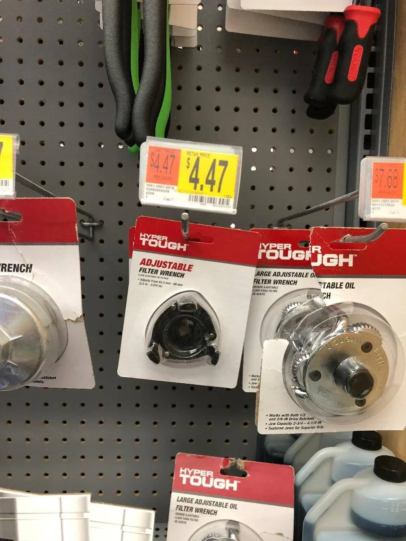

I grabbed one of these for like $5 at walmart for odd size filters. Seems like mobil 1, wix, ford all have a slightly different size filter body. I read a thread on a motorcycle blog where a guy had to drill holes in the bottom of one of those cup filter wrenches an put self tapping screws though it into the filter.
