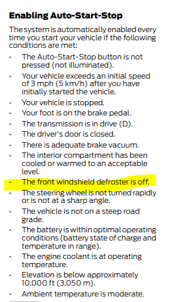

Turn on the defroster. I've yet to have the auto stop/start kick in with the defrost turned on. I always keep the defrost on at level 1, when the windows are up, anyway.
Ive had mine work with the defrost on. I have had the truck for two weeks and dont think ive shut the defrost off and its shut off several times. Will test some more.
