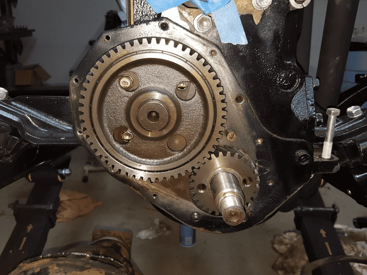

Meanwhile, my old FJ has timing gears (no chain or belt) and still going some 320K+ miles later ...
