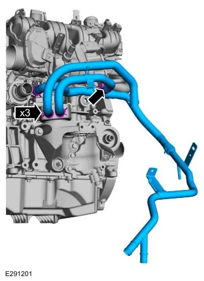

Using this pic as a ref
The Tube with the black marks is the tube you are referencing
The upper branch out - Routes here, back into the Block
The Horizontal Branch - Out (Black Rubber Hose (with White Marks)- Routes here, note this is the tubing in your pic, pulled away from the engine and the upper branch out disconnected
It is a solid tube that branches out into rubber hoses.
One routes to the (Water Pump Housing) next to the Thermostat
2 Routes to the Engine Oil Cooler (The X3 Note Arrow) in the Pic
It looks like it is a complete assembly
Note: One of the Black hoses has a nipple on it for the 3rd hose connection to the Water Pump Housing
Reservoir Hose - Ford (KB3Z-8075-E)
