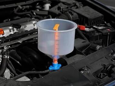

The Funnel works well on older autos with a radiator cap.
Well, I just ran out a took a peek under the hood... No old school radiator cap! Just the overflow tank that appears to be pressurized under load. So this funnel system is not appropriate for 5G Rangers.

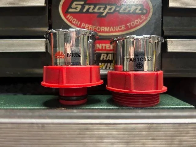

For a Reference - as these come it kits - Amazon / Harbor Freight Etc or Loan A Tool from Auto Parts Stores.
I just added adaptors to my Snap-On (Pressure Tester) now 36 Years Old, have never had an issue with it.
So instead of buying another kit for the correct adapters - I just sourced them separately and these (2) adaptors fit the Ranger - Reservoir and Cap.
You need to ensure that you are using the correct adapter, as when you install it (if incorrect) it can damage the threads on the reservoir.
The design difference in the adapters can be subtle but still have the same thread size, note the nipple extension on the (Left) adaptor
It is a balance over quality as the cheaper kits can give false readings (Leak Down) from the tool itself. Moreso the kits with the QD (Quick Disconnects)
I have tried these cheaper kits, and they lacked quality and leaked, when leak checking a cooling system - a quality tool is essential.
The Mac Adapter - RA10052 - Reservoir Adapter (Left)
The Snap-On - TAB1C053 - Cap Adapter (Right)
