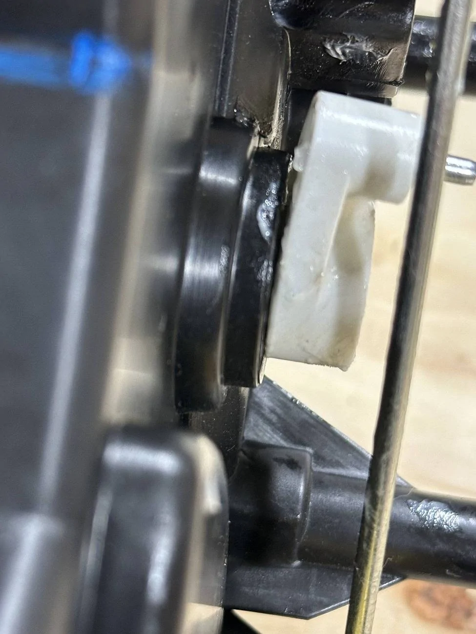

I couldn't actually feel the play since the bellcrank is pretty much hidden behind the actuator when it is in place. I am making an assumption that by tightening the bellcrank against the white lever it will reduce the possibility of the pin jumping out of the slot. I used two nylon washers, both about 1 inch OD. One of them has an ID large enough to clear a small raised cyclindrical boss in the actuator case where the shaft exits and the other has a slightly smaller ID, just large enough for the splined shaft. I am afraid I didn't make note of the exact dimensions - I brought the actuator with me to a hardware store and selected ones that fit my purpose by trial. In any case, when the bellcrank is slid onto the shaft it now bears against the outer washer, which I lightly greased, and is about 1/16 proud of where it would otherwise be. This is admittedly an experiment - I'll follow up.

Also, the splined shaft of the bell crank is not a tight, press fit onto the shaft of the actuator. There is a small amount of play which allows the bell crank to slightly move/rock out of parallel alignment. At the outer edge of the bell crank that slight movement is amplified and could result in the pin being closer to escaping the slot. With the end of the bell crank shaft bearing against the nylon washer, it reduces that tendency. That's my hope at least.

Added two nylon washers between the blue cam and the body of the actuator which moved the cam out about 1/16 inch and tightened it up against the white lever/pin. Back together and working - will post if the pin jumps out of the slot in the future. At least I have heat - 20's in the a.m.
