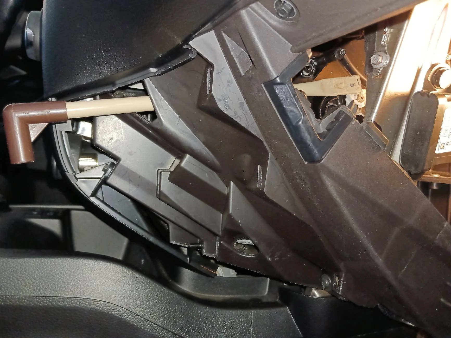

This is what Airline Tech is referring to, but mine has manual A/C this is for the blend door to control the temp. Since the install I have painted it & blends in well. I have to take another pic.

Airline Tech or any one else question. If the blend door is binding why is it so easy to move manually? Or is it that the side of the box warps enough to move the acctuator? ?

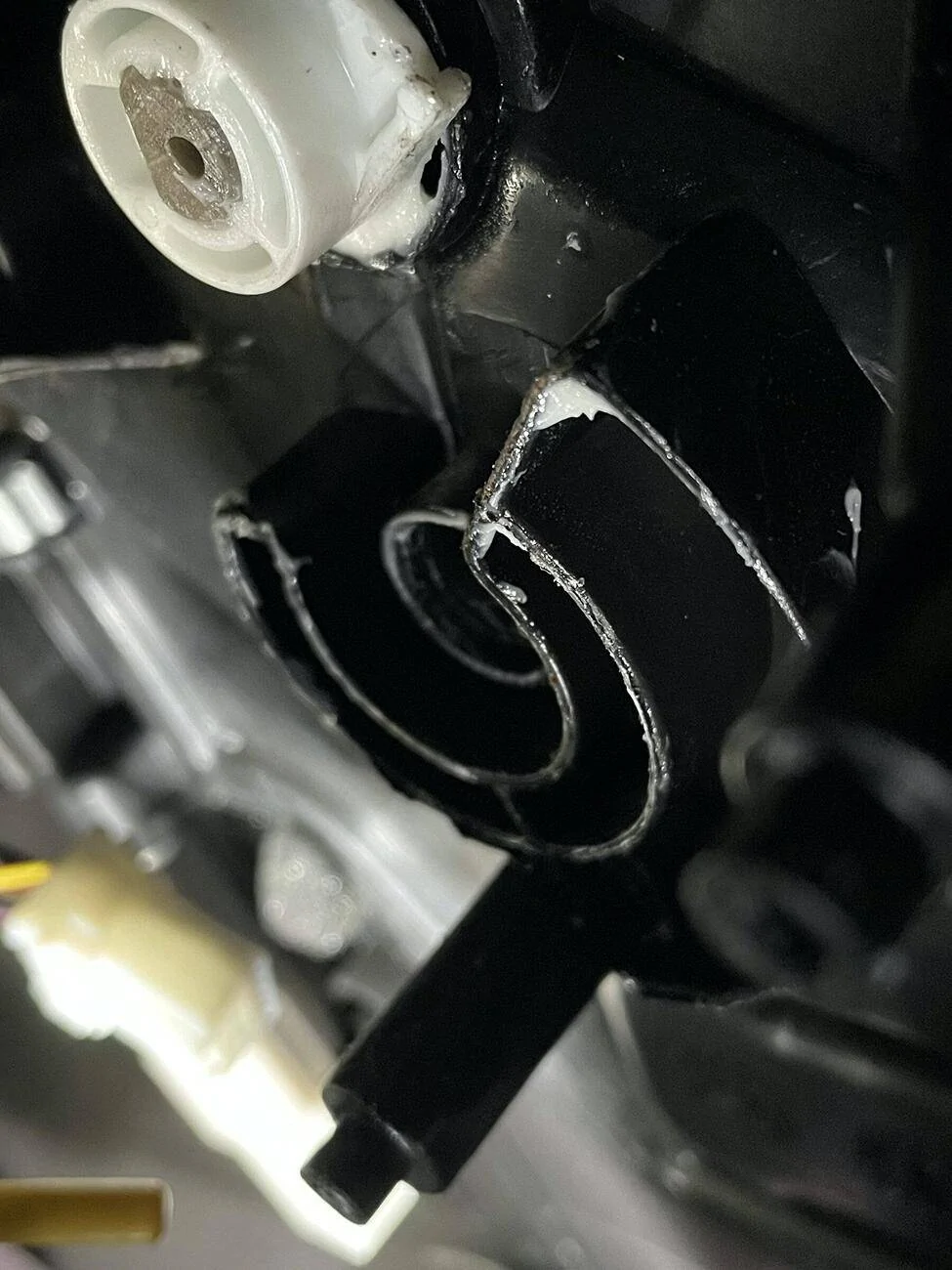

Mine is electronic but when I took it apart the actuator was broken off the arm. I would think that's what happened to yours and that's why it's moving freely and the link is now disconnected.

Mine is not broken. my diy control rod is on the same pin that the actuator moves. Here is a painted pic. No panel in place because I do not have a spare & don't want to drill thru the one I have.

I see....I think you re right in that the box warps enough to move the actuator.

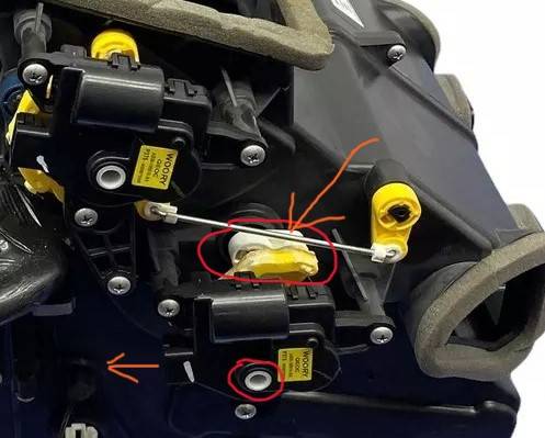

As @quangdog posted on his R&R of the assembly, there is not allot of torque required to move the doors - the actuators are plastic gears and a small dc motor, so it does not take very much extra resistance to cause the actuators to jump gears and become out of sync and lost.
In this pic - the WHITE arm is part of the HVAC assembly, there is a small guide pin that sticks out of the end of it.
The YELLOW piece in between is a bellcrank that guides (moves) the white arm and the actuator drives the bellcrank.
If the actuator just jumps a gear or gets lost on the (feedback) position track - it is possible to remove and clean & lube and reinstall - and it MAY be a fix.
But I am the type of mechanic - if it is difficult to access, just REPLACE it, why go through the time and effort just to redo the work again if it does not fix the issue, (actuator failure only)
But if the internal door is causing this actuator assembly to bind up, it may break, or bend the WHITE lever enough that the guide pin pops out of the yellow bellcrank track
Since it is unknown what specific spot, the door is binding at (internally) but I think it has to do with the shaft that the white lever connects to and allows it to rock side to side, this tweaks (bends) the white lever off to the side and then the guide pin gets jammed into the yellow bellcrank when moving (Cold - Hot)
So, with that said - the recent post of can this be moved without tearing apart the dash.
I am going to back track some here, and say yes, it is possible BUT you may do more damage and get into a situation where the white arm must be replaced (which there are no aftermarket parts for just this piece) as trying to force past the internal resistance of the dc Motor and gears when it is installed and the limited access you may unknowingly bend or break it.
Option: Find a Pick N Pull - Type salvage yard and pull one from that if it breaks off.
So, one could try - Manual Movement
Disconnect the connector - Arrow (pulling away)
Get a plastic (trim tool) - long and thin and attempt to push the YELLOW bellcrank, I think some are BLUE at the bottom end of it towards the firewall.
If stuck on (HEAT)
or
Get a Stubby Phillips Screwdriver wrap the end with some electrical tape and try to wedge it into the white (circled) spot and attempt to rotate the actuator by hand.
If I remember correctly:
Rotate CW - to Open (Heat)
Rotate CCW - to Close (Cold)
This pic shows the door fully closed (note the white arm - position), when that lever rotates (down-C/W) the temp door opens
Do not use too much pressure when doing this, if you can get it to move, leave the connector disconnected or it will just drive back into open position again (stuck on heat)

I never had any problems with the arm moving when I took mine off. I've been off road with it many times even up in Moab and it never moved once. In my post above (530) you can see where it broke off and I pulled off the broken (white) piece of the actuator. Now you can just flip the metal arm that's in the middle of the actuator up for AC and down for heat with your finger. You don't have to take everything apart just the lower panel then reach up there and it moves easily. I got to the point where I could do it in 10-15 minutes twice a year.
Here's my original post and where to drill the middle screw out.

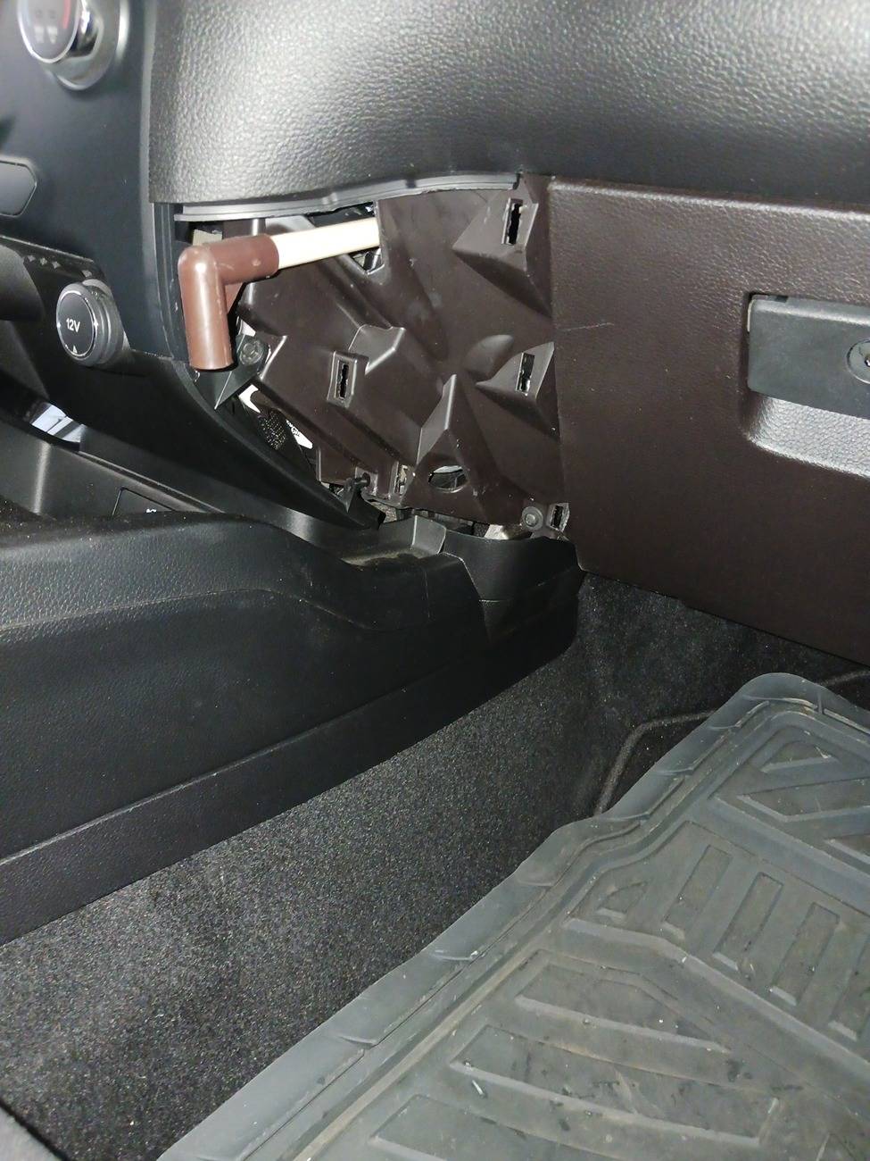

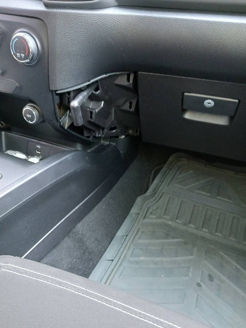

Well, I undertook this yesterday. Here are my comments on this process for the next newbie that has this issue:.
  1. Pulling off the panel just takes some courage. Pull from the top since it hinges on the bottom. its all snaps except the hinging piece which has annoying screws. Its quite hard to get off.
  2. The panel next to center console has even more snaps, no screws. Pull it off with a lot of force.
  3. You need to take out the floor duct and move the duct around to get access. There are two support fasteners to remove. You need to disconnect a sensor wire.
  4. The hole you need to drill in the brace needs to by a little higher than the pictures show to get to the hidden screw.
  5. Its not really accessible so take your time to get it out.
  6. I pulled the actuator out from the front gap and it came right out.
  7. Once I took it out it was so easy to move the door, and the actuator was moving when I changed the ventilation so I am completely lost why it wasn't working.
  8. I left the actuator connected to the wires and zip tied it to another brace that has a hole right there.
  9. If I need to change it all it need to do is pull the panel off, stick my hand up there and move it to the other position
