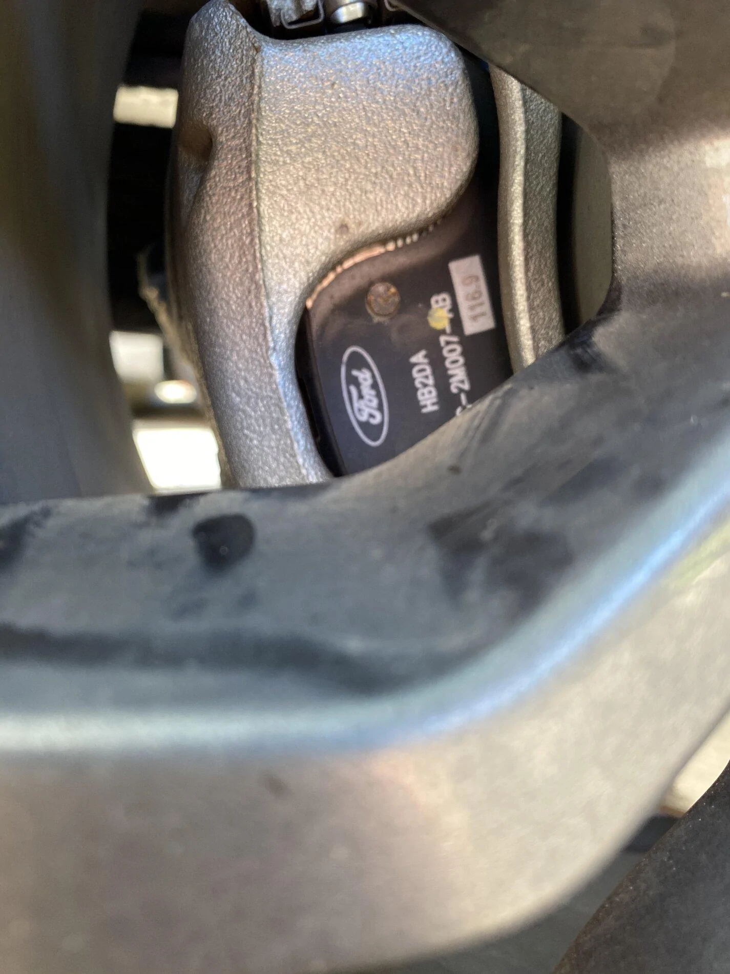

I have been thinking it was the brakes causing the squeak since it seems to go away while any amount of braking is applied. There is a shiny area on the outside of the pad. Do you all think this is the culprit or normal wear? The outside pad on the driver side doesn’t seem to have this shiny area as pronounced.
