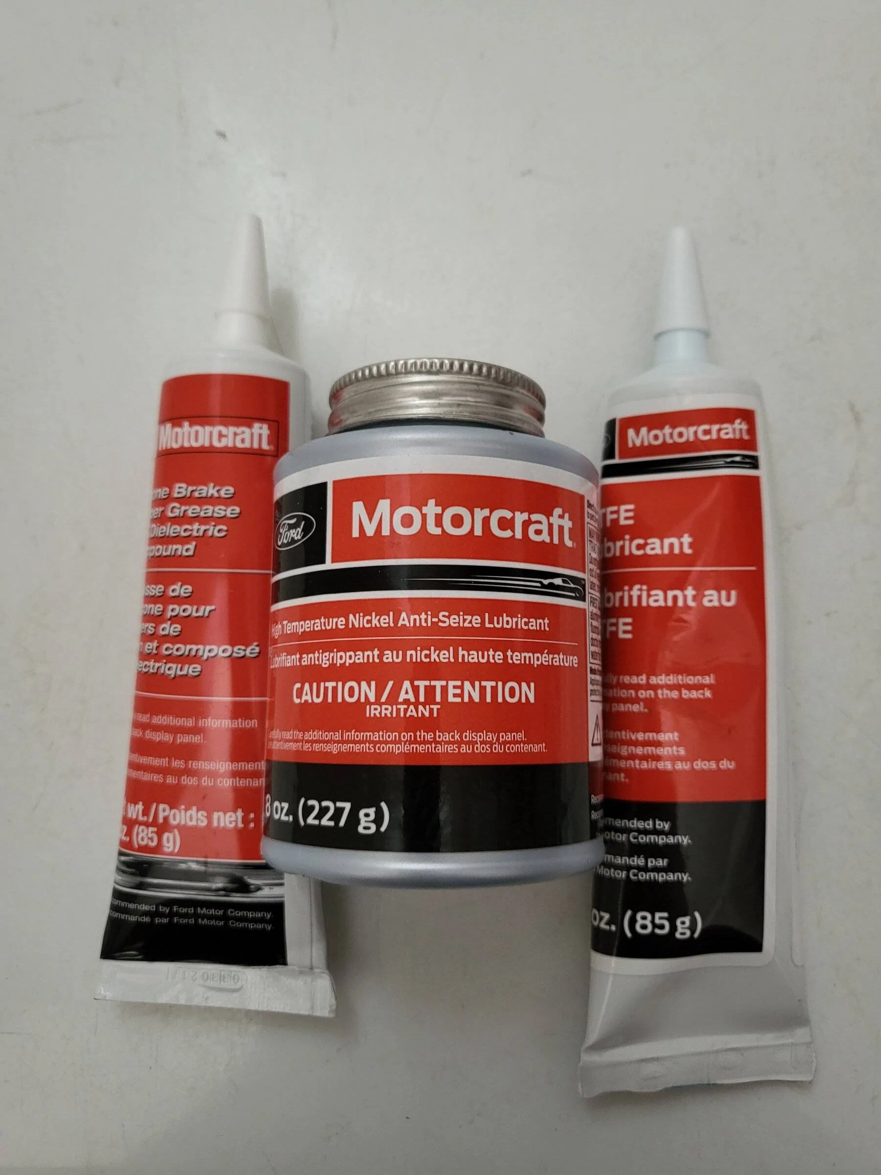

I'm using these to help the squeaking noise. Now they are gone. Thanks for the info.

I have that squeaking sounds coming from Fox 2.0, it's resonating on my tubular UCA, I used a lubricant from Ford and it gets rid of the noise.
