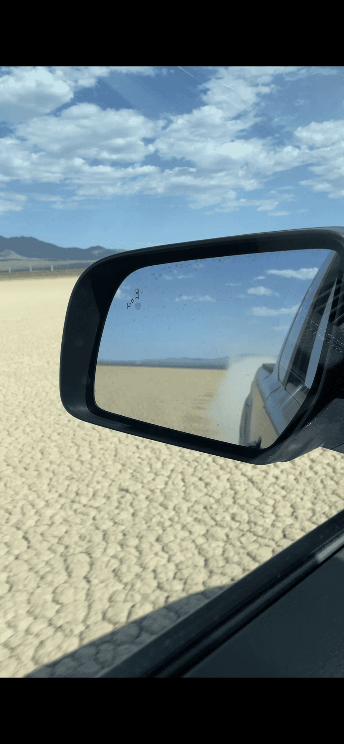

Any one have an idea of how I can diagnose this issue without paying $180 at the dealership for them to probably tell me that they cannot duplicate the problem?
Don’t drive thru the dust?
If you think it’s sensor related. Cover them with something and block the sensors. See if engine acts the same when sensors covered. My sensors always say unavailable when I drive thru the desert. Wipe them off. Restart vehicle and all warnings gone but I never got a change in Performance.
