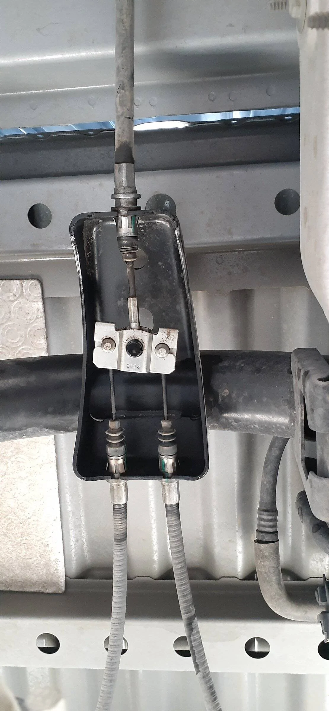

My 2019 Ranger has the exact same noise, have you had any luck ?
My '22 Ranger Tremor had exact noise too. It's the parking brake cable bracket. Gets dry or dirty and just needs a shot of wd40 or pb blast lube. No adjusting. On mine it's right where the front cable links to two rear cables via link mounted on steel bracket. It's not spare tire, leaf's or body mount. Easy.
