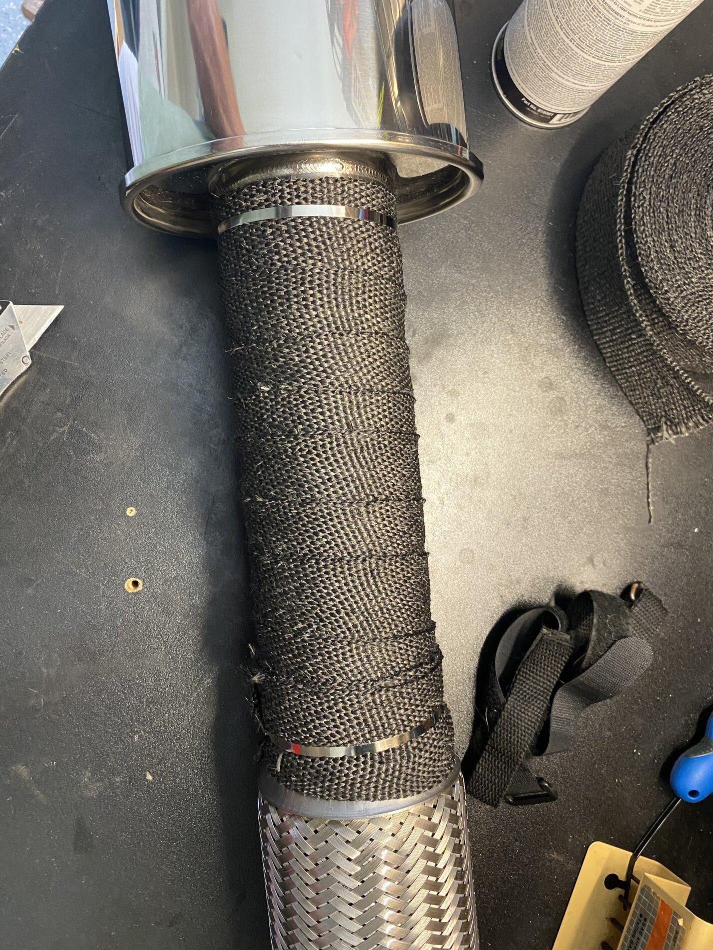

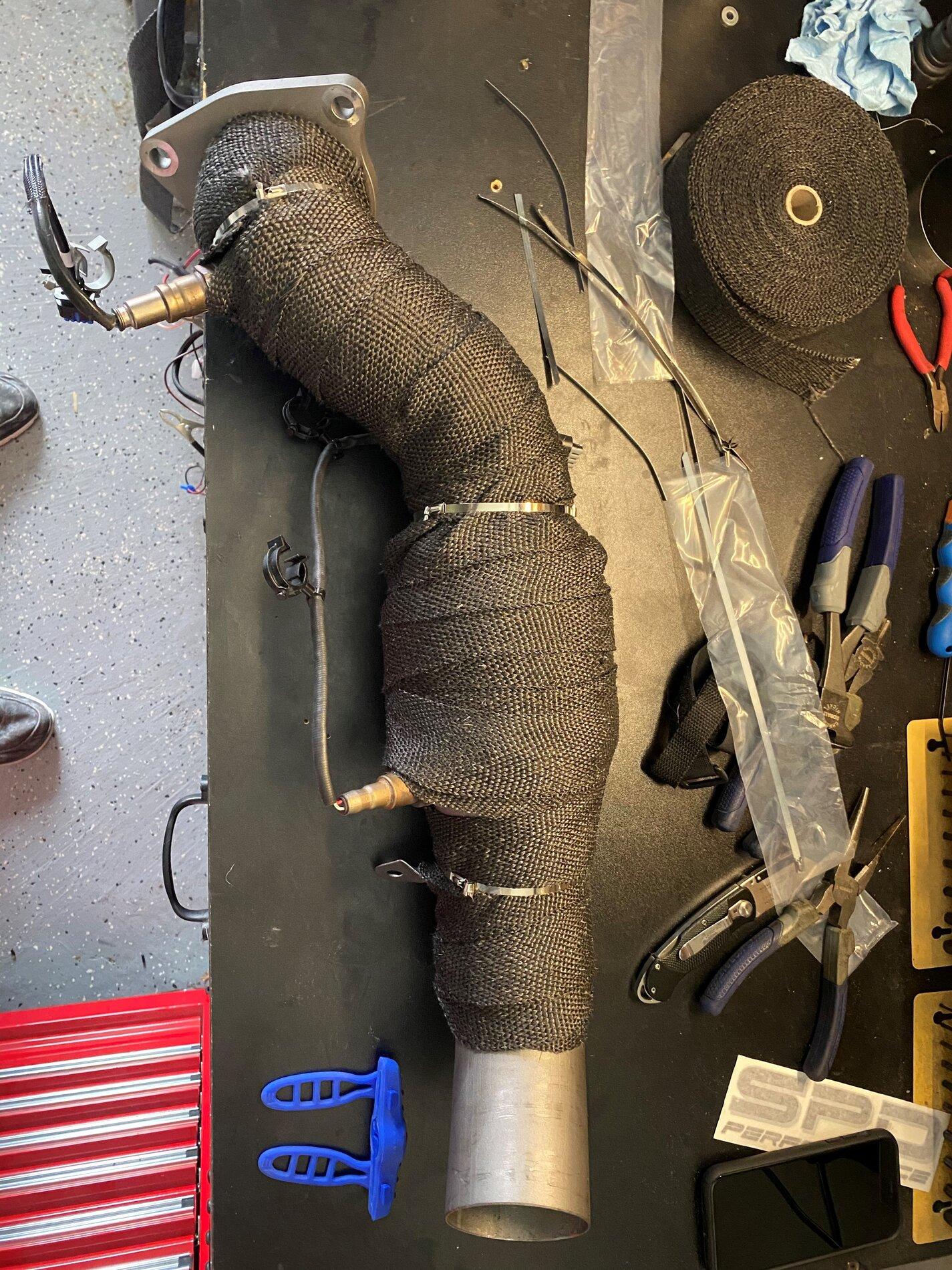

Finally got it all installed. Man, what a difference and sound. I hated it at first but it is growing on me a little.
what exhaust did you have on for the soundclip and what did you wrap the DP in?

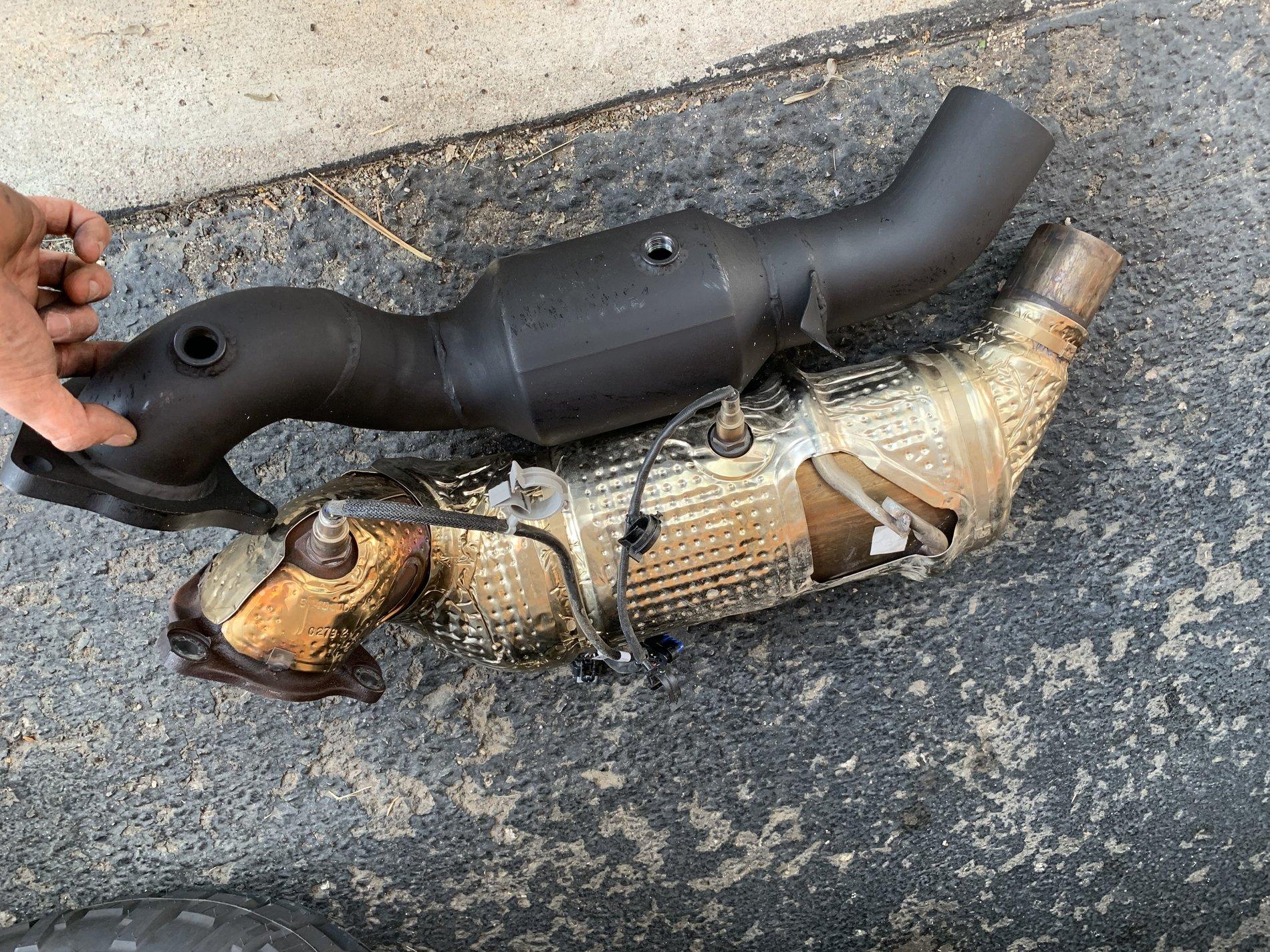

HTX1811
HC
Mar 3, 2020
658
1,439
Houston, TX
19 Ranger STX 4x4,16 Audi A7
It’s a reusable metal gasket. No need for a new one as long as you don’t destroy the original.
I don’t know the part number to answer your question. I reused the original. Zero issues.

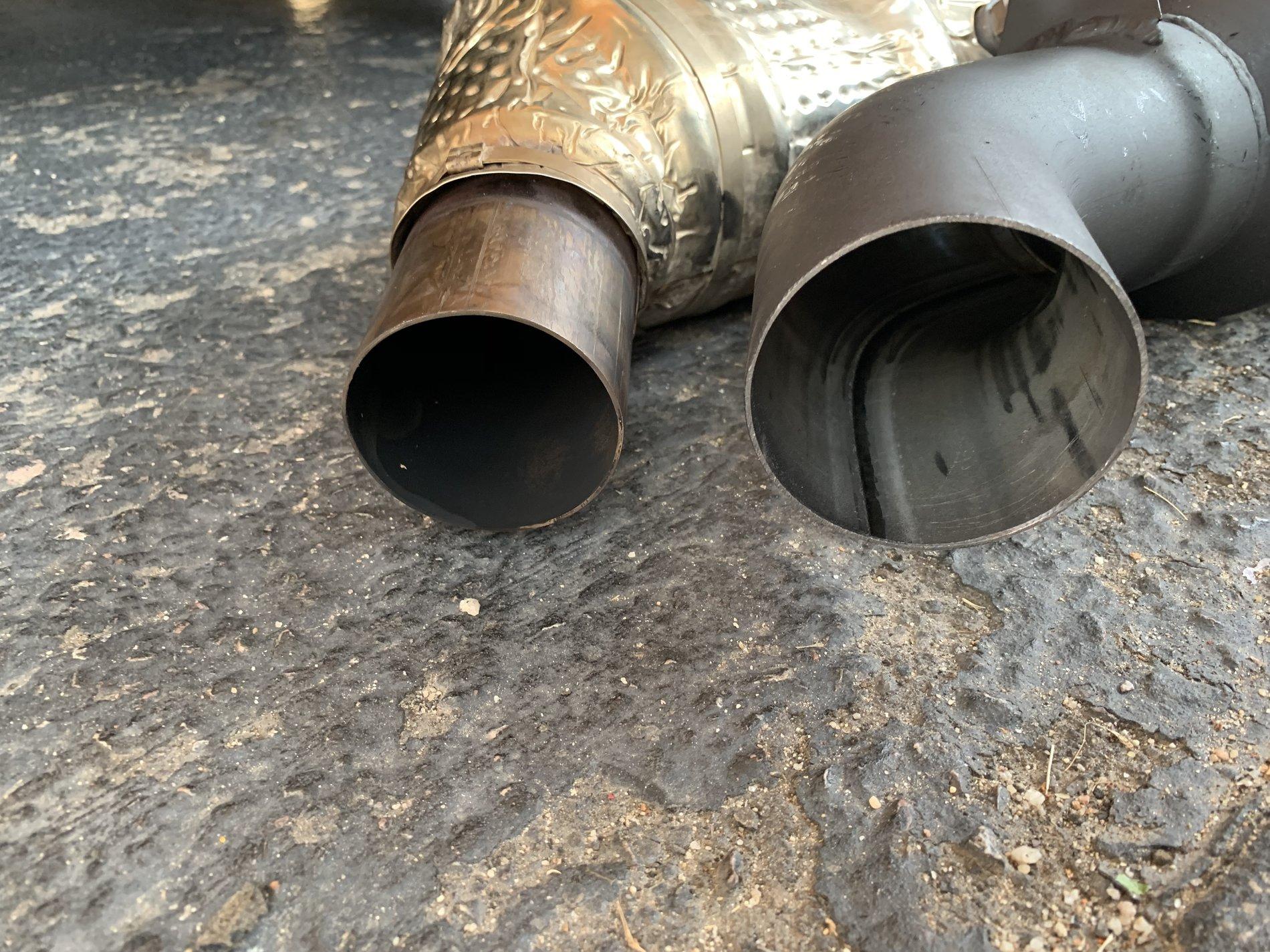

Just an FYI on new Stainless SPD downpipes. I just installed mine a few days ago and found that SPD is NO longer shipping the downpipe with adapters. It comes with the 2.5" welded end pre installed. If you choose to go 3" like I have. You must cut the end off. Not a deal breaker, but they need to update the website to reflect what your buying.
For what its worth I had a rough ride with SPD, I got the downpipe and its the revised model. They indicated that on our trucks a full 3inch exhaust isn't of benefit, but it really sucks to lose the 3inch option given if you ever want to do an upgraded turbo your hacking up a 550 dollar-ish downpipe to accommodate.

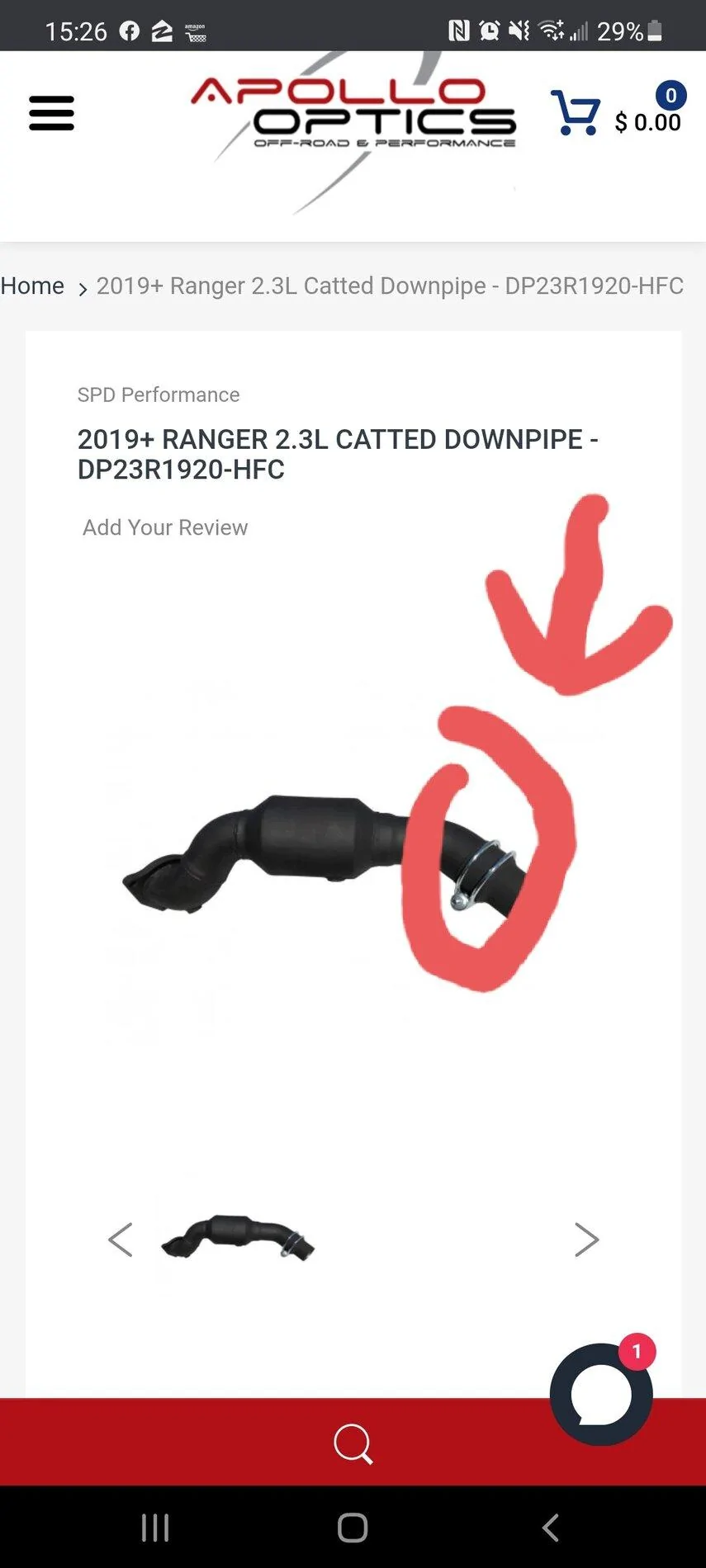

Just installed the SPD downpipe. The flow difference is apparent. Faster spool time and you can hear the turbo finally. The size difference is also significant.
I just got the downpipe delivered same as yours. I'm new to this and wanted to know if yours came packaged with any additional hardware for the install. I just got the downpipe.
