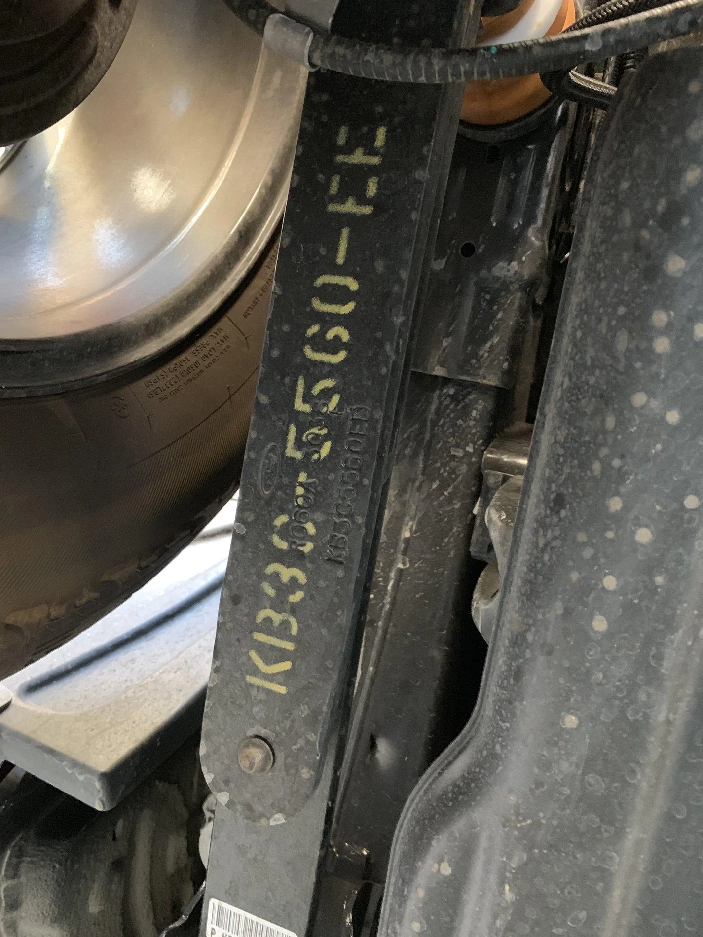

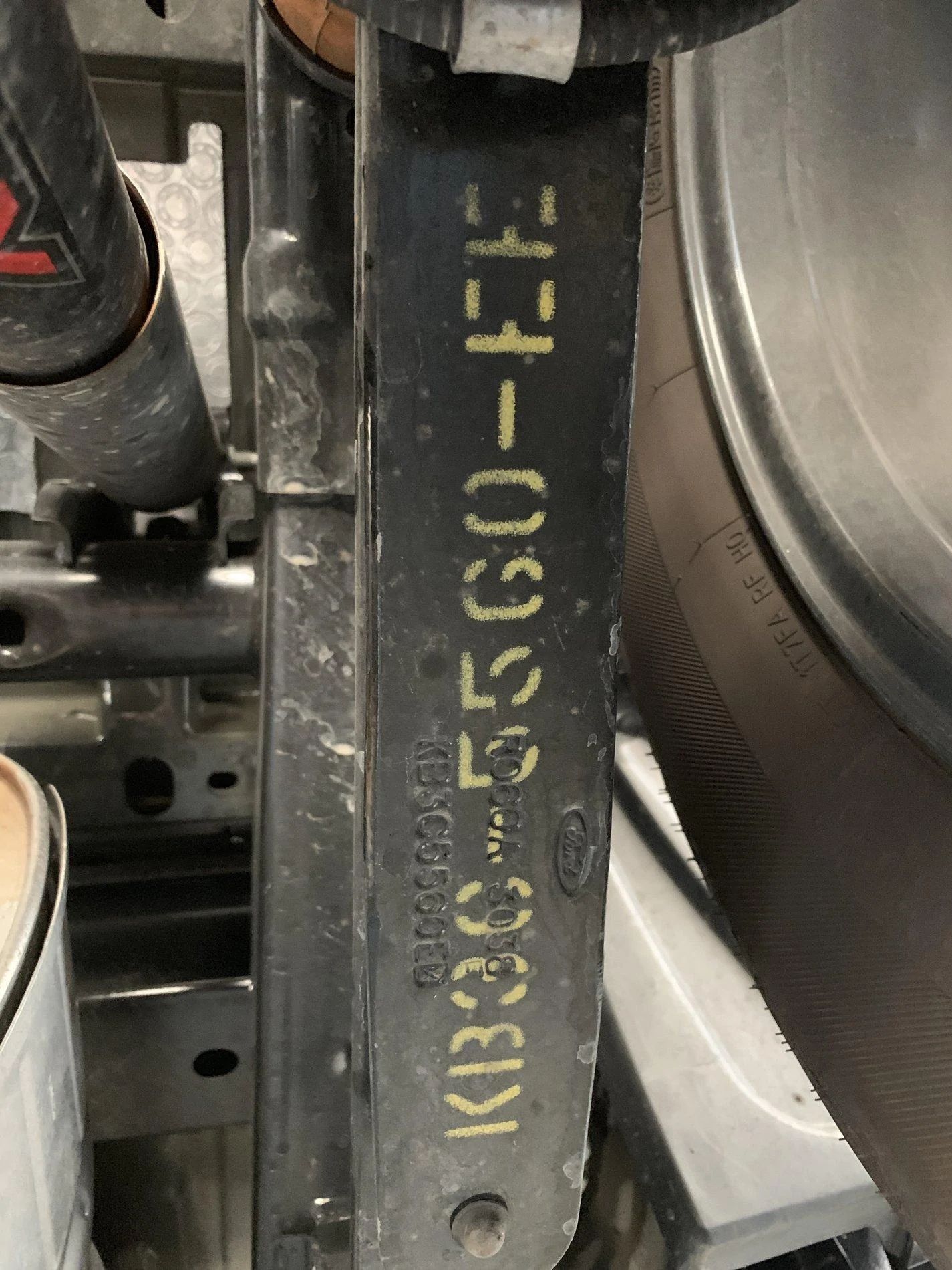

First is to get the measurements per procedures. Then I would have the dealer verify the parts for the truck are correct. It is possible you have a wrong spring for example. If parts check out, pull the springs on the front to ensure they are the same length..make sure that you keep track of right and left. if correct, is there a shimming procedure? Just a SWAG, but my guess is a wrong part is contributing to the problem.

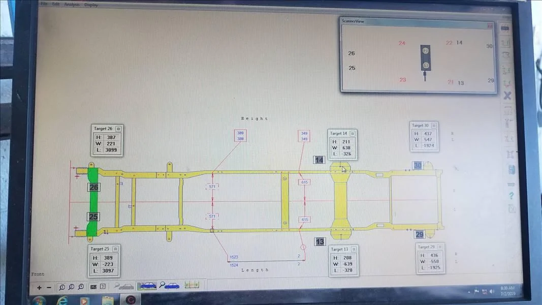

Second dealership had the truck for 10 days.. they measured the frame in the body shop.
They said the frame is fine, so there is nothing to fix.. they won’t fix the lean.

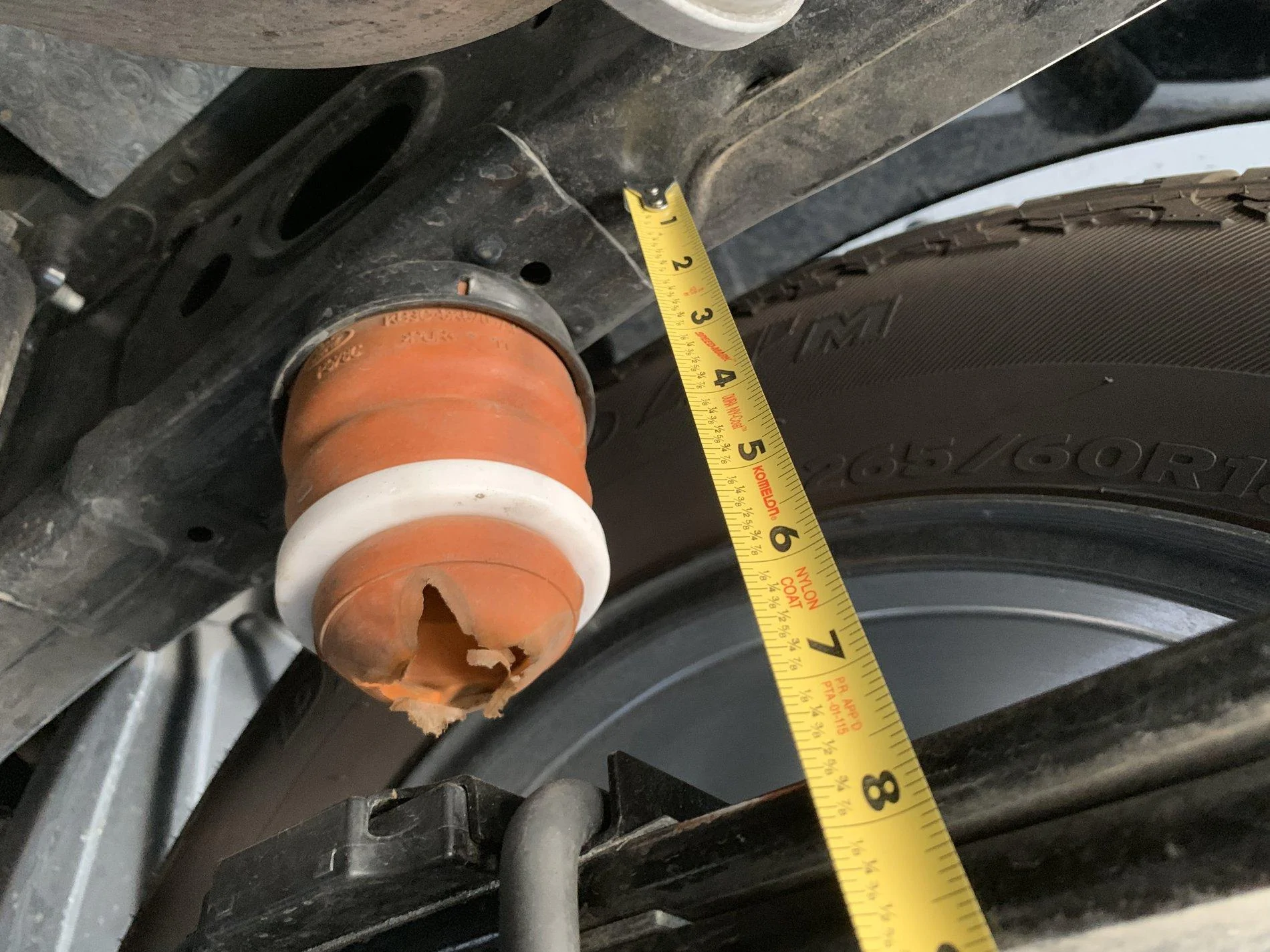

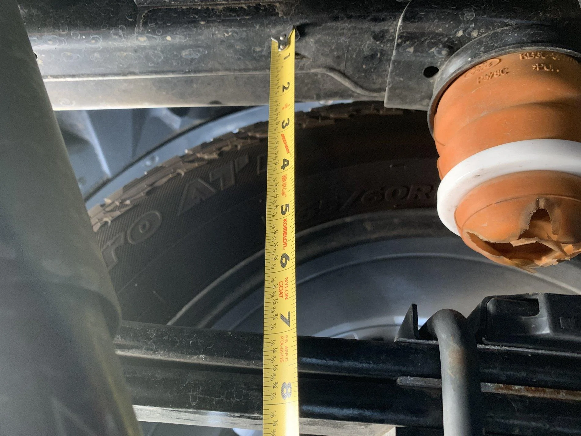

I measured the distance from the leaf spring to the frame. Seems that’s the culprit..
Maybe they could replace or even swap the leaf springs?

You should be able to shim the low side between the spring and the rear

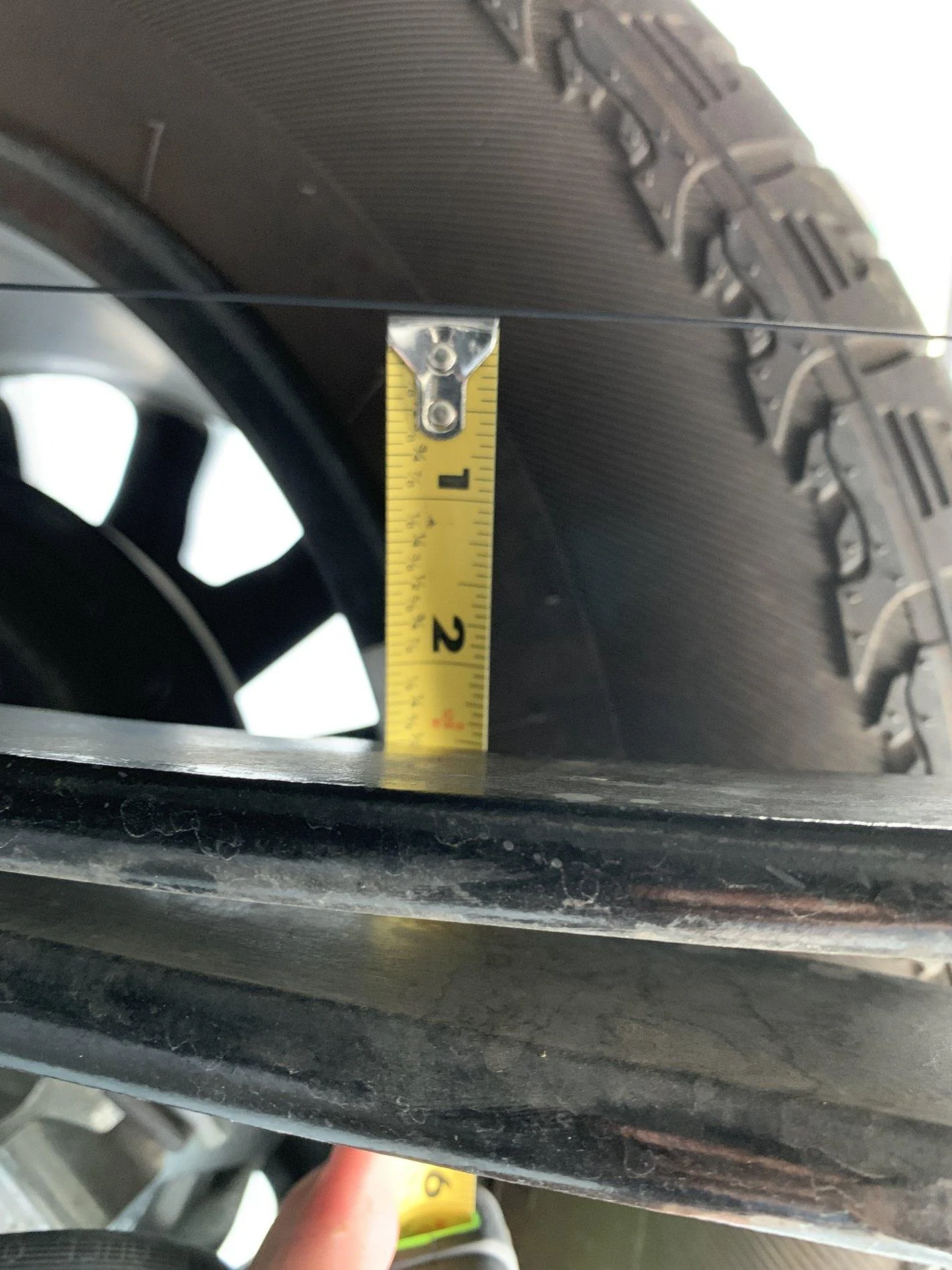

I have a suggestion you might wish to use as a start on the diagnostics of the left rear suspension...Take a piece of kite string and wrap it around the front spring eye bolt at the front of both rear springs....Stretch the string taught around the rear shackle where the spring attaches...make sure you wrap each side the same....do not worry if the string is in the center of the bolt and do this with the vehicle on its wheels. Now measure from the top of the axle to the string on both sides. If the same, then the springs are both good...if there is a difference the one of the springs is likely at fault. Now if the measurement is the same, then you have to look at the front spring eye pivot brackets and the rear shackle brackets to see if there is a difference. This is really weird and I wish I could be there to help try to determine what is amiss.

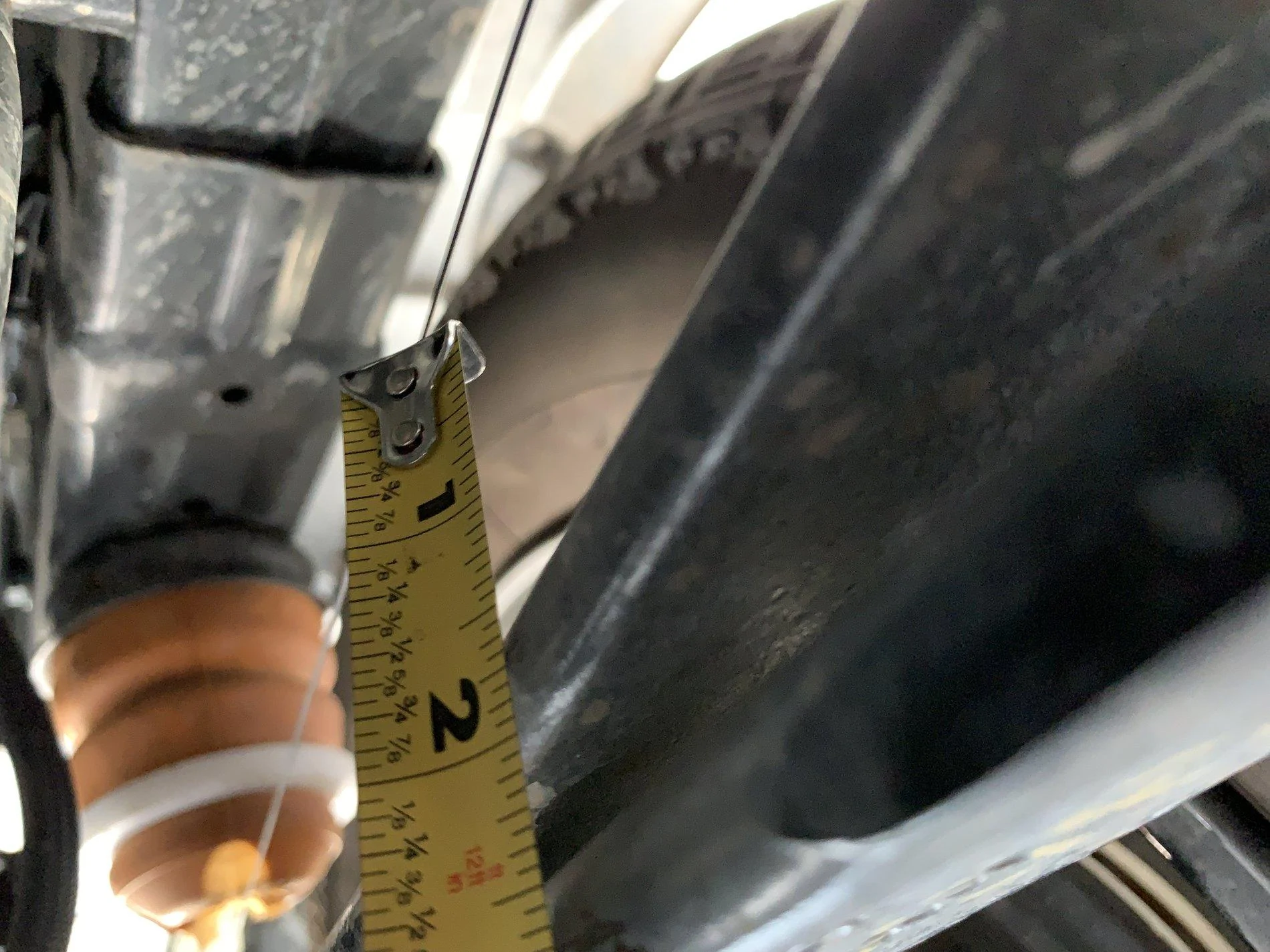

I did the string test from the tops of the leaf bolts on both sides
7,084
37,221
Hi Gavin,
This points to the spring being the problem as there is almost a Âľ" difference and your measurement takes the frame, brackets and tries out of the equation, assuming the pickup box is empty. .My guess is the left spring is the problem for some reason. It has to deflect more to handle the load .Hopefully you can convince the dealer to order and replace this left spring. It could be the right spring is incorrectly arched, but to me that is a stretch.. Do you agree with my conclusion?
