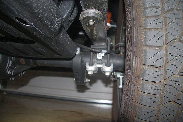

Hi.
Okay...maybe because you have an XL....however I doubt it. Look at the spring from the front to the back and take a picture. maybe the XL is different. Not from the rear but from the front looking back.
best,
Phil Schilke
Ranger Vehicle Engineering
Ford Motor Co. Retired
pboggini
Pete
Nov 30, 2018
235
253
San Jose, CA
2019 Lightning Blue XL Ranger 4x2 Supercrew.

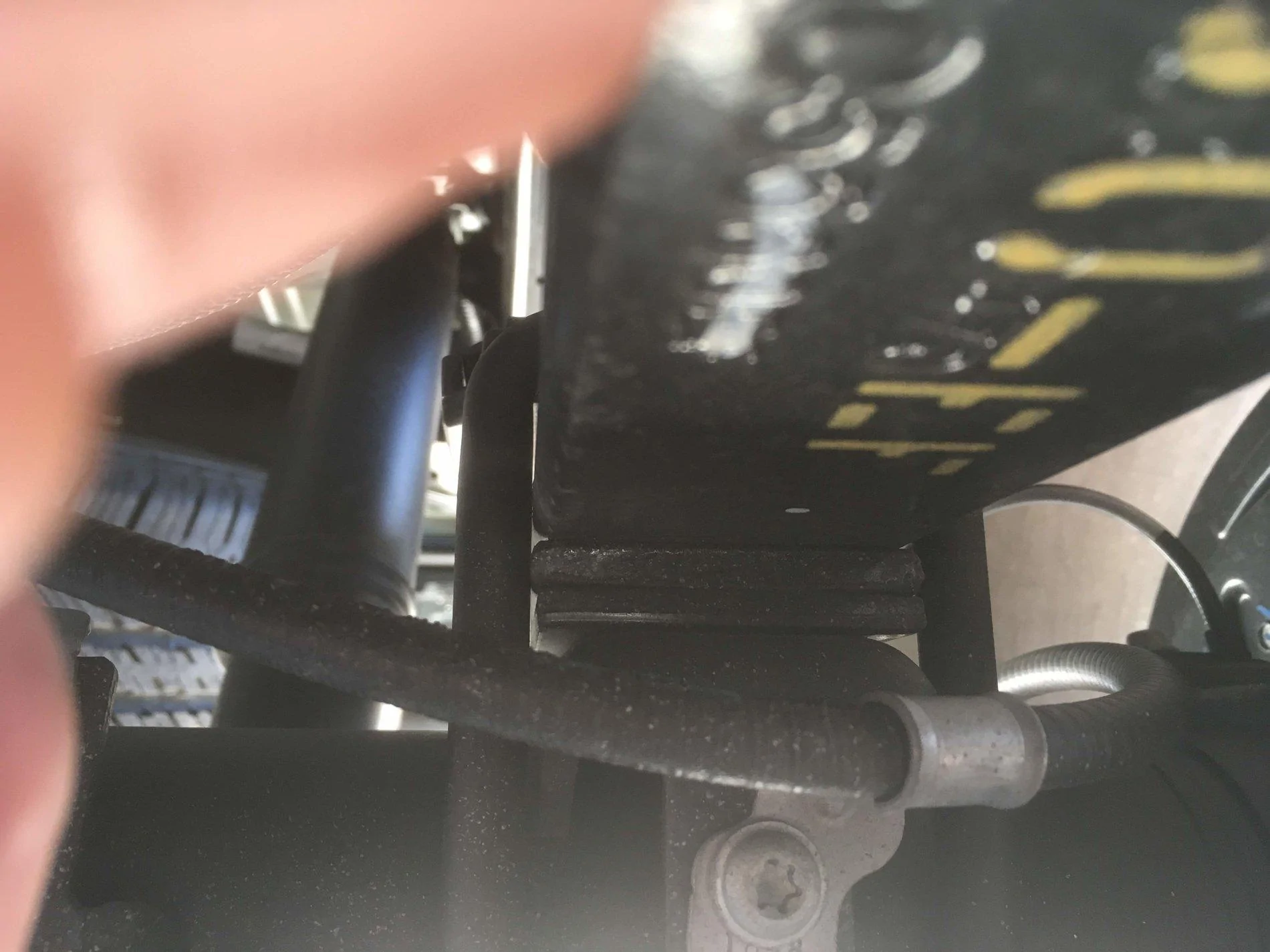

Hi.
best,
Phil Schilke
Attaching a pic. It indeed has two spacers on the left and one on the right.
Do those of you who have 4x4, XLT and/or Lariats have this half spring? I have the single spring with the load spring which was what all the reviews said the Ranger would have.
7,083
37,193
Hi Pete,
Yep...It looks like they indeed put two spacers on your 4x2... Here is a pix of the half "slapper" spring. So you have a mono spring, eh?
Interesting!
Phil Schilke
pboggini
Pete
Nov 30, 2018
235
253
San Jose, CA
Hi Pete,
Interesting!
Phil Schilke
I have that slapper spring too it's what I referred to as the helper. So, I have the mono and the helper but the helper/slapper spring goes just as far in the back as it does in the front.
