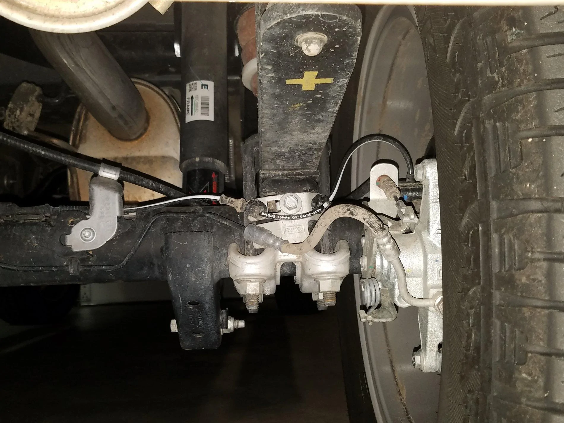

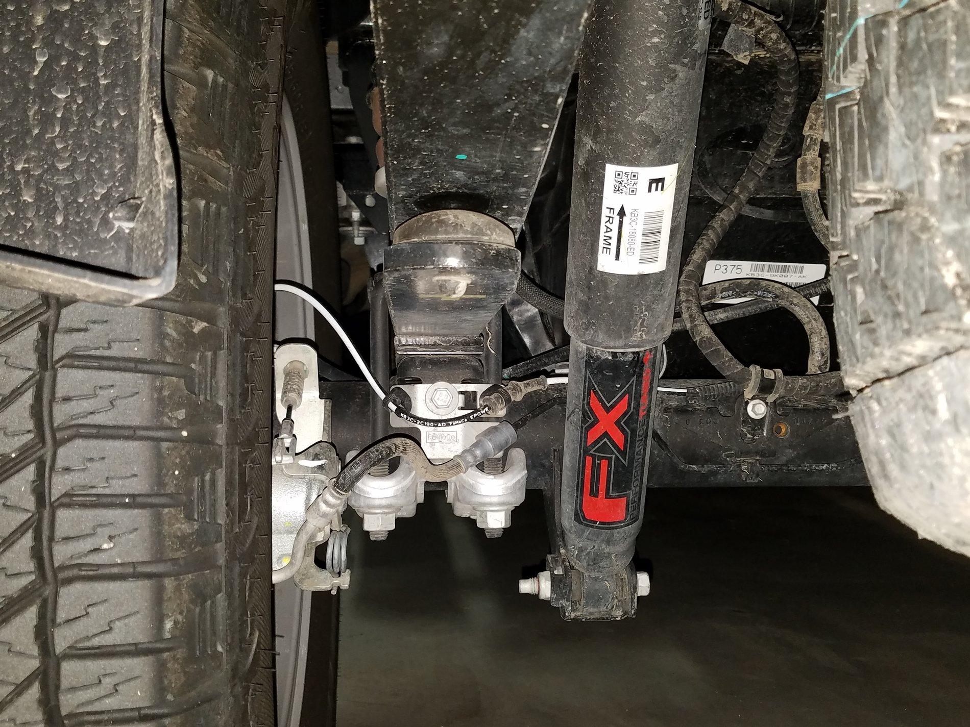

Mine is the same...I didn't count but noticed the thread below the assembly was shorter on driver side meaning there's more shims on that side...

My truck also has the nice shiny shim on the drivers side.. but none on the passenger side.

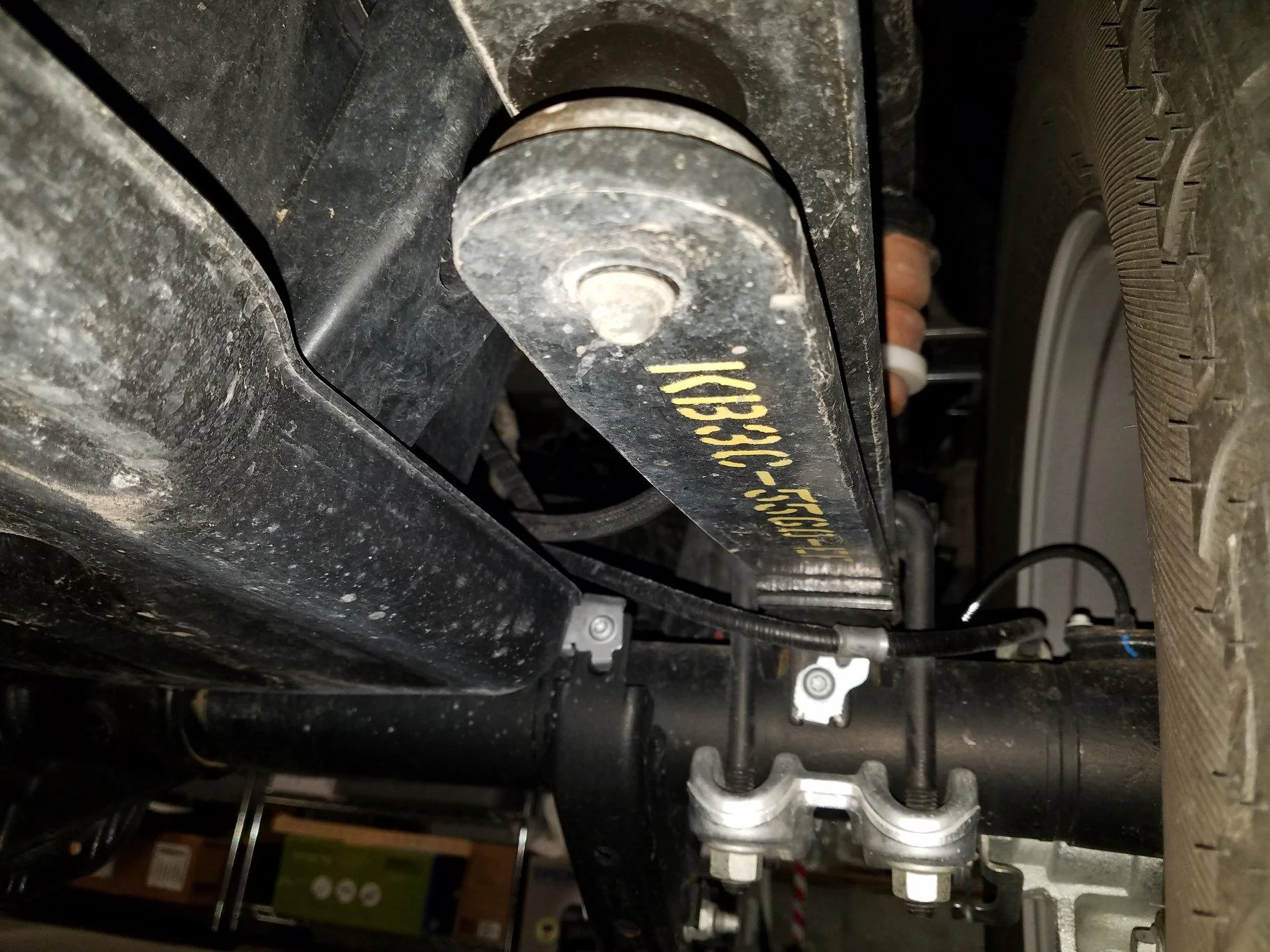

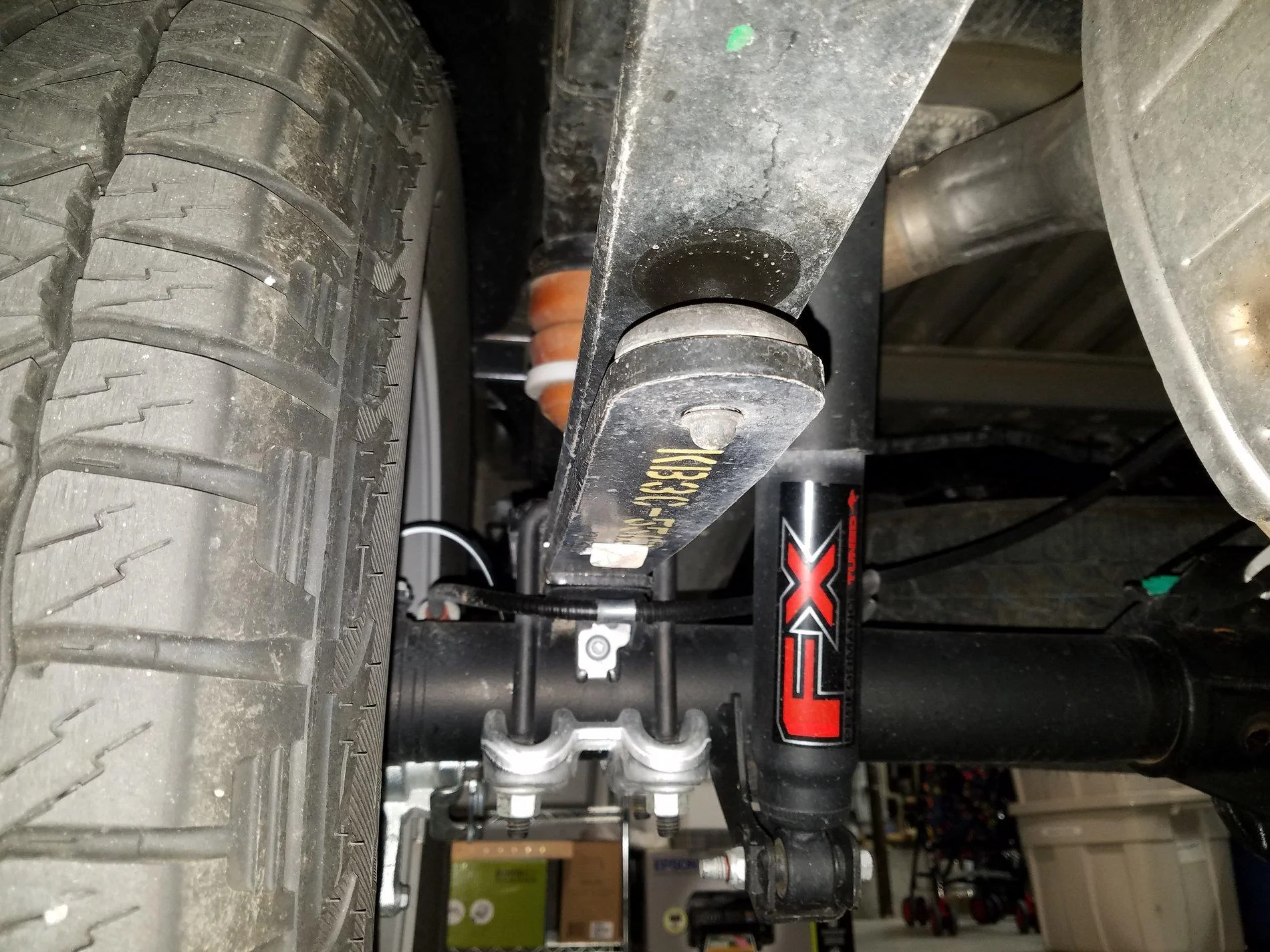

I know this is a pretty late post, but I finally got rid of my "Ranger lean".... It came from the factory with a 1/4" shim under the drivers side and it still leaned towards the driver's side by 3/4" of an inch on a completely flat surface. Didn't matter if I had a full tank or not. This drove me nuts (I have about 3000 miles on the truck right now) so I bought an Eibach 1" rear lift kit with 2 blocks from the Eibach web site. Cost 100 bucks, but well worth it for me.
Took me less than 30 minutes to follow the instructions to take out the driver's side shim (1/4") and install the block. I have kept the shim just in case I raised the driver's side a bit too high. Then I'll just put it under the passenger leaf springs.

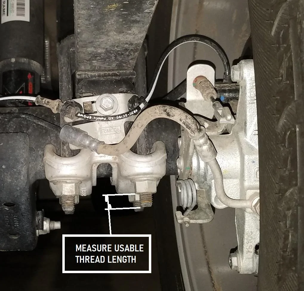

It depends. The 3-1/2" Rough Country Kit already has shims and u-bolts for the rear.
Go out and measure your truck (Check out the photo below). If there isn't more than 1-1/4" of threads hanging out you're going to need longer u-bolts.
Note: Ford specifies the U-bolts and nuts be discarded and replaced, and not re-used after removal.
Might be worth your while to contact Rough Country and see if they already a have a fix for this.
