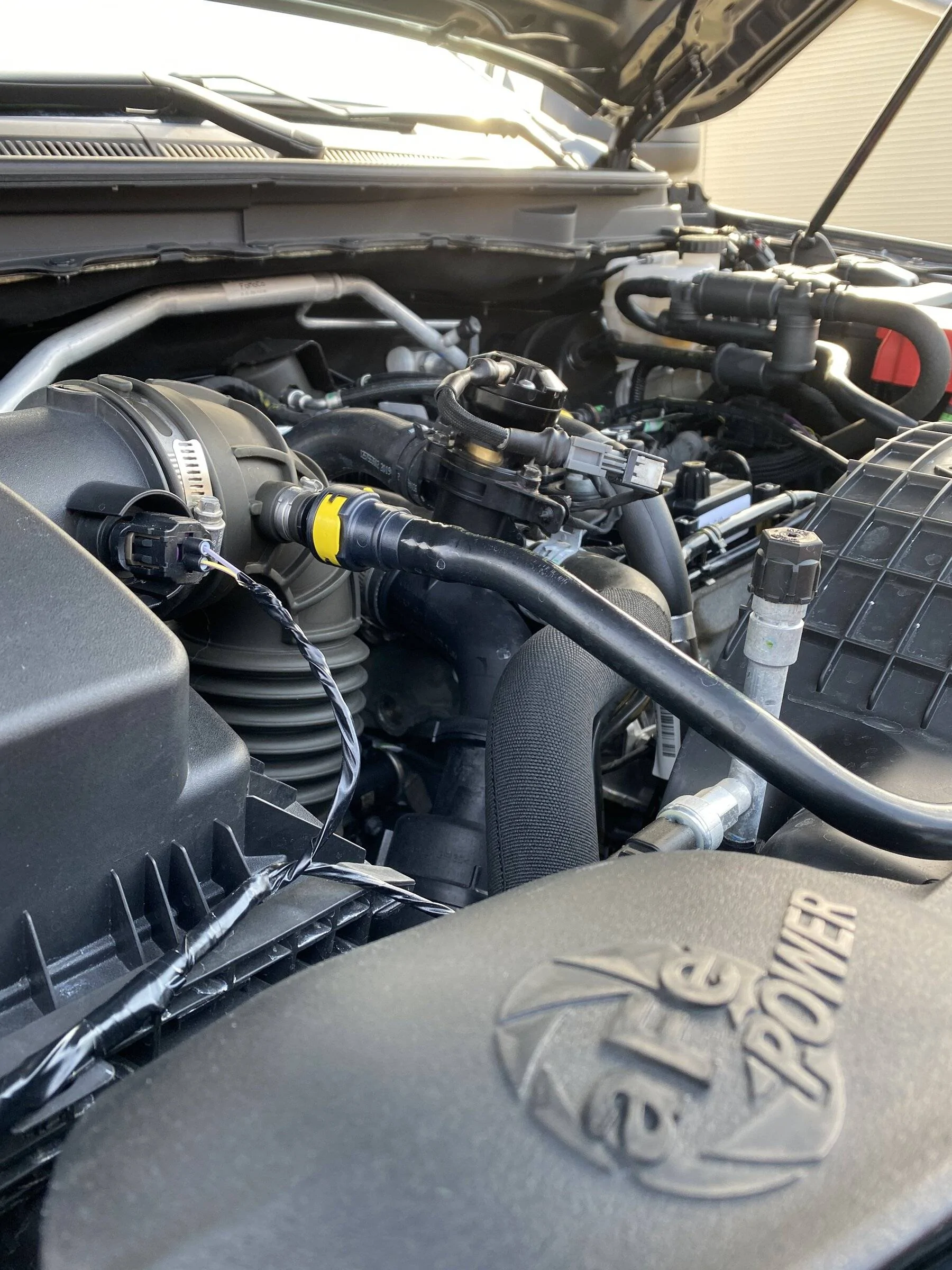

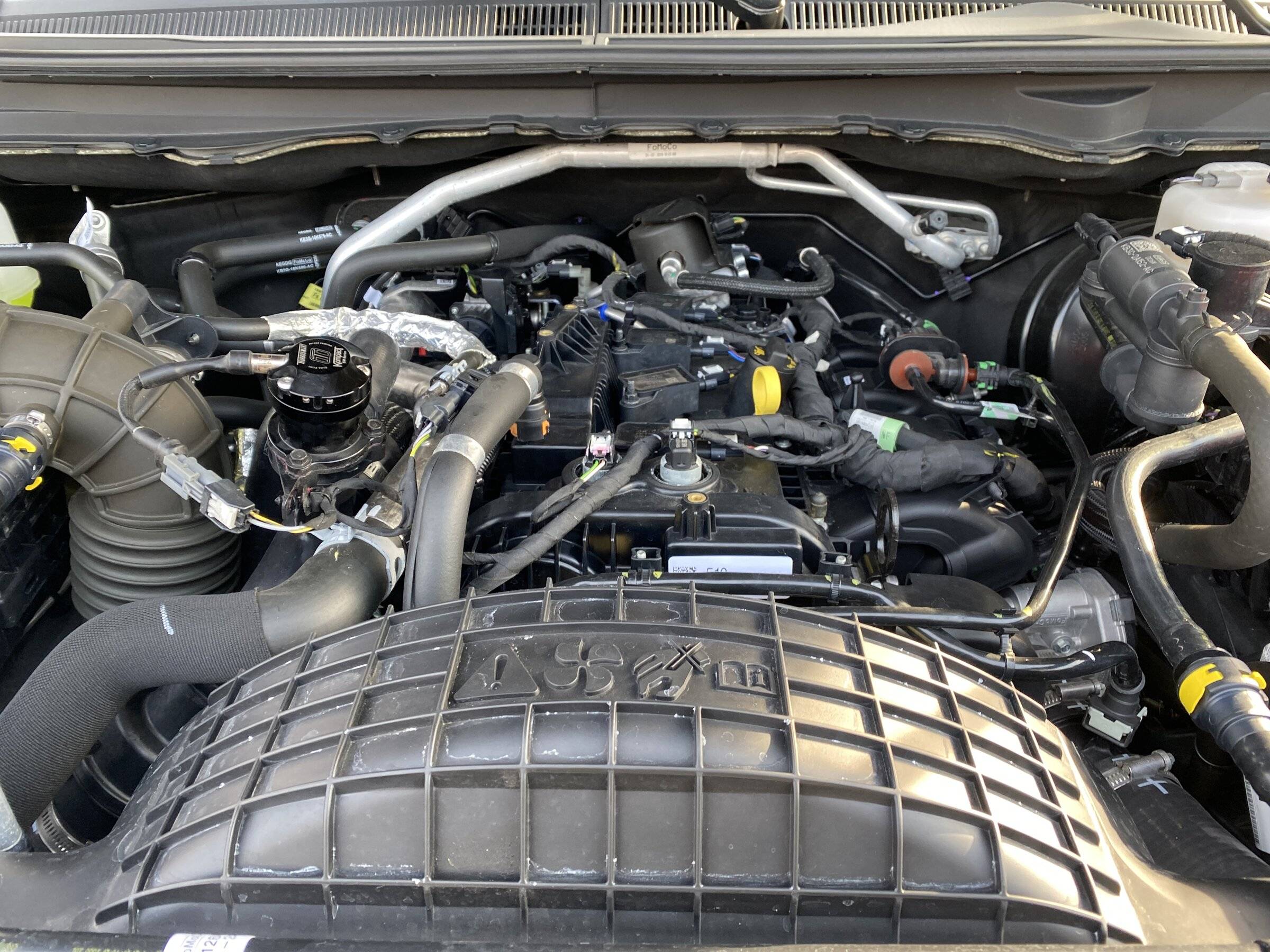

Take a look at my install...
I only found one or two pics of actual installs and I don't think mine is installed right.
I tried rotating to see if it's possible to be in a different positon but found the hole-spacing is offset.
So the Turbosmart BOV install only in one position on my truck
Just came across your post. I got one on mine and my power wire off the BOV is in the direction of the fan. It’s really the same direction as the factory one was.
I know their instillation instructions suck. But like you mentioned, the hole spacing is not equal. Been running mine now for 10 montha without any issues. Definitely can hear it
