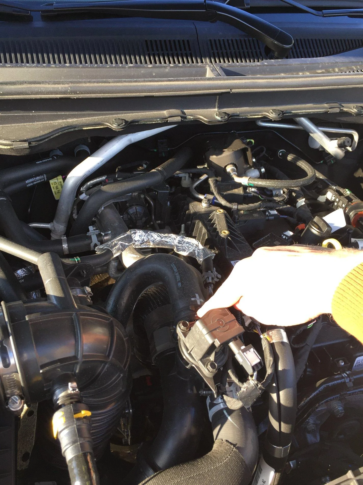

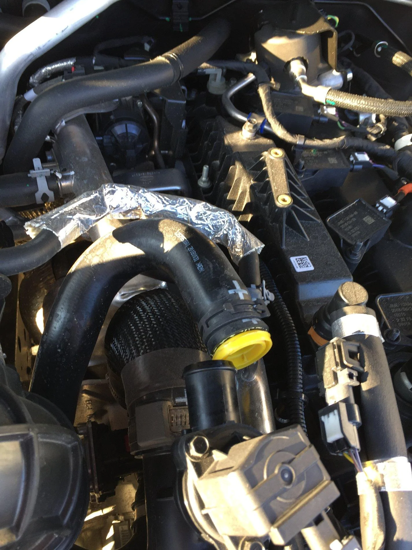

So you can disconnect the recirculation tube and vent the OEM blow off valve to atmosphere making the PSSSHSSSHJHHHHH noise. I have a video currently uploading to youtube of my ranger, you just need what looks like a 1" brass plug to cap the existing line. The "chair leg" comes from the piece the Mustang guys use which is literally the rubber replacement foot for a chair, walker or cane.
