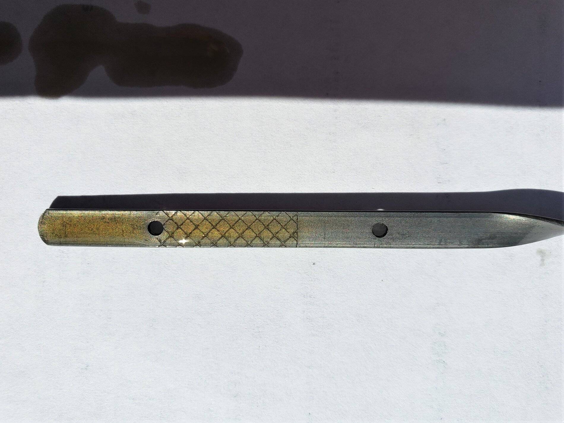

I have problems getting an accurate reading when checking the oil level after the truck sets on level ground for 15 minutes or even up to several hours after getting it up to operating temperature...probably oil splashed inside the dipstick tube. I get a good reading when the truck sets overnight (see pic.) but also realize that the level will probably be higher when checked after getting it up to operating temperature. This reading was taken after about 25-30 miles after the 1st oil change. Maybe a comparison will help to guide you toward a solution. My 2011 Ranger was easy to check either hot or cold without any problems. Hope you get this issue solved :)

I was starting to worry about mine, 2020 purchased new late March and now with less than 2k miles on it. The oil was always way high, but I was always checking at the gas station so it never sit for 15 minutes.
I finally let it sit in the driveway while I unload groceries, pulled the stick and wiped it off then let it sit 15 minutes. When I checked it the oil level was around or a little below the high level hole/mark.
I'm not going to stress about it. I don't drive much so I know it's due to short trips, but not much I can do about that. I do try to take it out for a 45 drive every few weeks, but it is what it is.

The only way I found to get an accurate oil check was to park it in the garage after the last trip at night, pull the dipstick and leave it out all night and check it the next morning. My guess is the path the dipstick takes is the problem. When I pull it out warm there are too many things that are still wet with oil. I even used a file to put a little knick on the dipstick after an oil change where I knew the exact right amount of oil was added. That is now my full line.
