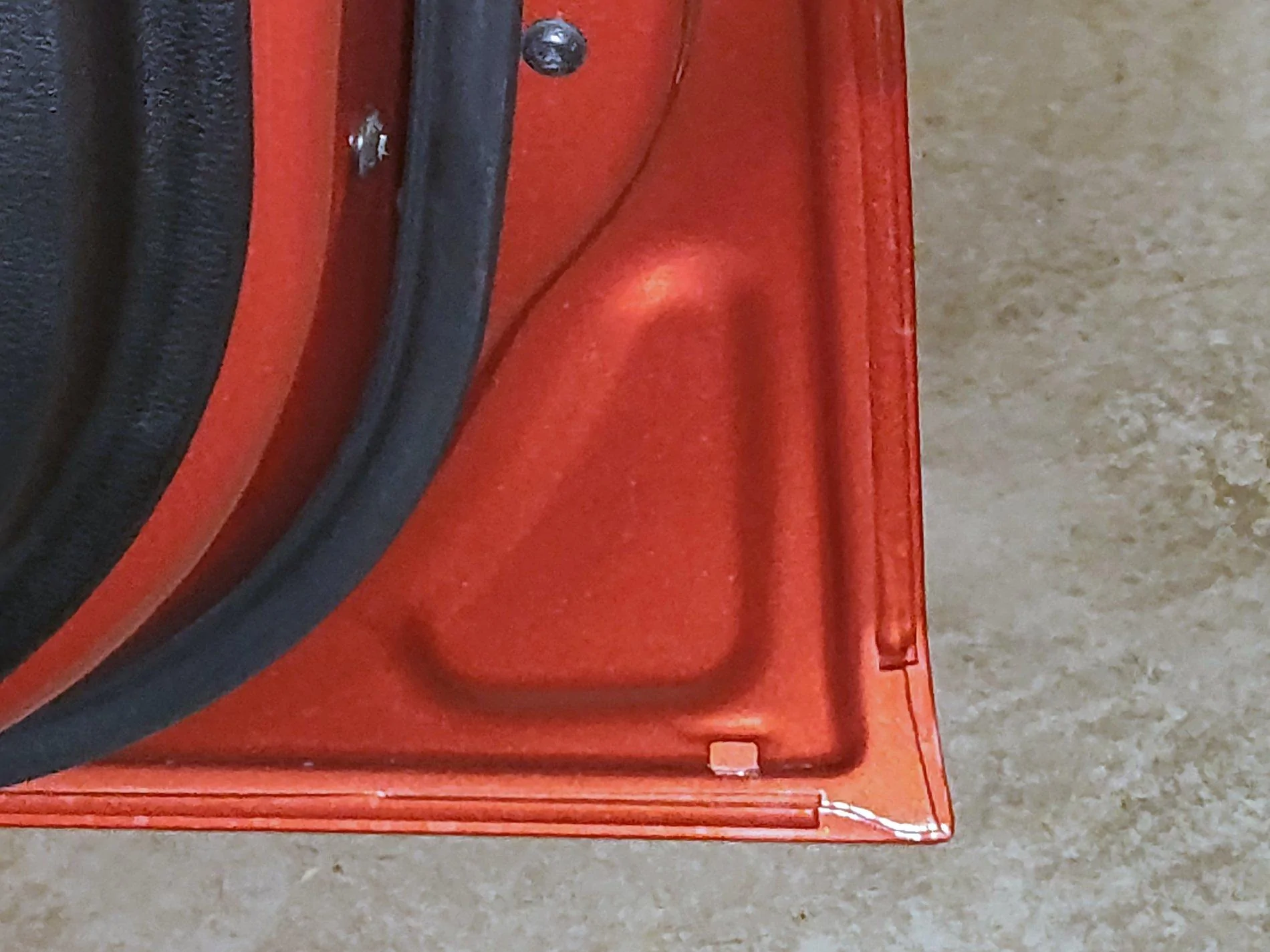

Build date 2/2019 and it has the seam seal. Do you think it has anything to do what part of the country you are in or maybe where it was built?
I'm in Ontario, Canada and we get lots of road salt hitting our vehicles. If this were true I would think mine would have sealer and it doesn't. I think what others have said is true, there was a problem with the sealer and they pushed ahead with production anyway.

Makes sense but it just seemed odd that some in February have it while others do not...have you asked the dealer about fixing yours?

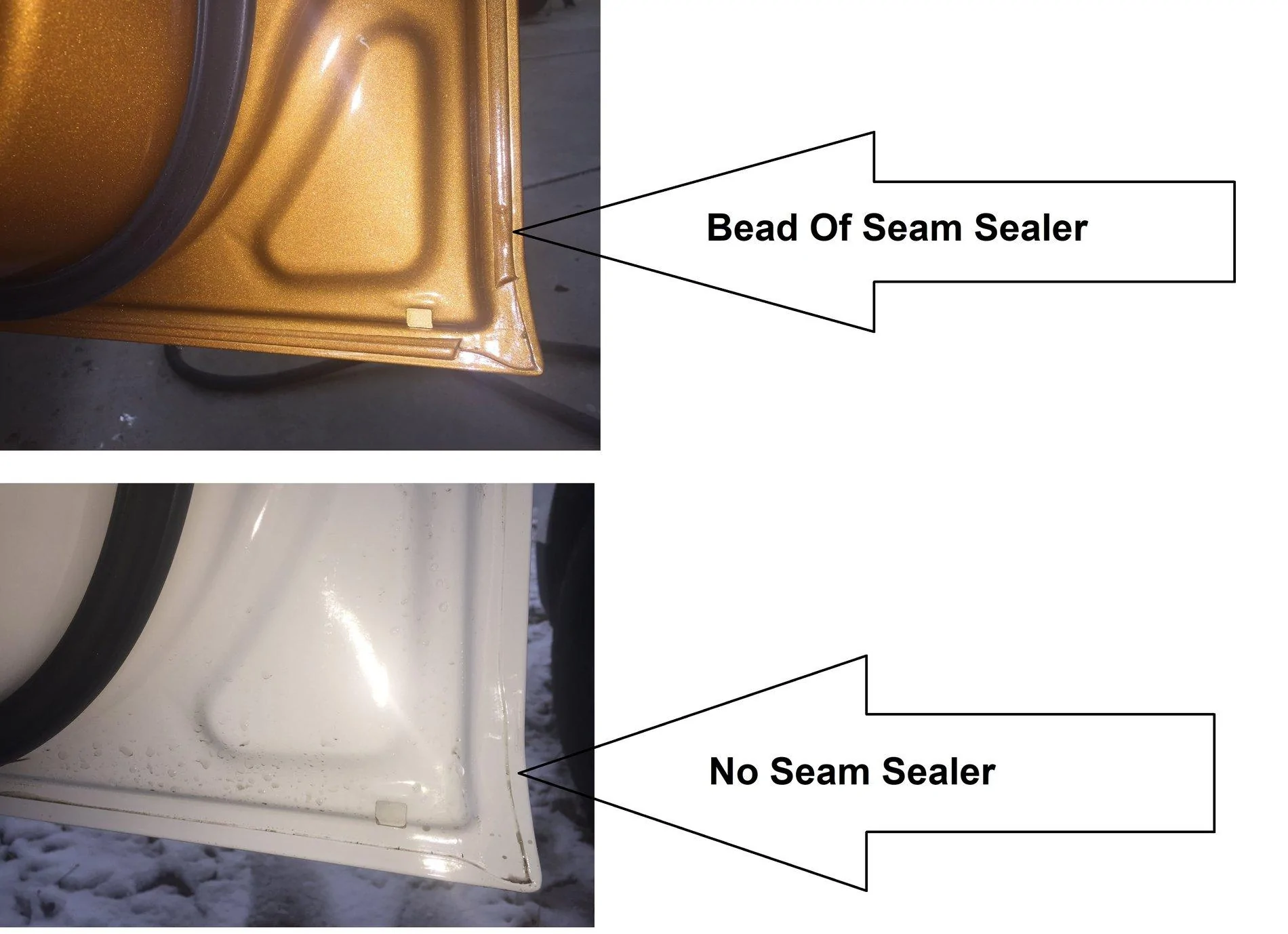

My 3/12 build has on all 4 doors. Drivers rear is a bit sloppy

Mine, built 04/06/19 has it on all four. I wouldn't be overly concerned if it didn't. There is normally sealer applied on the parts before the door is hemmed. ( That's when the outer skin is wrapped around the Inner). So the joint is sealed from the inside. There are also sealer daubs applied near the lower skin that melts in the paint oven and runs down to seal the lower seam. After all, the lower edge is the most likely to rust.
