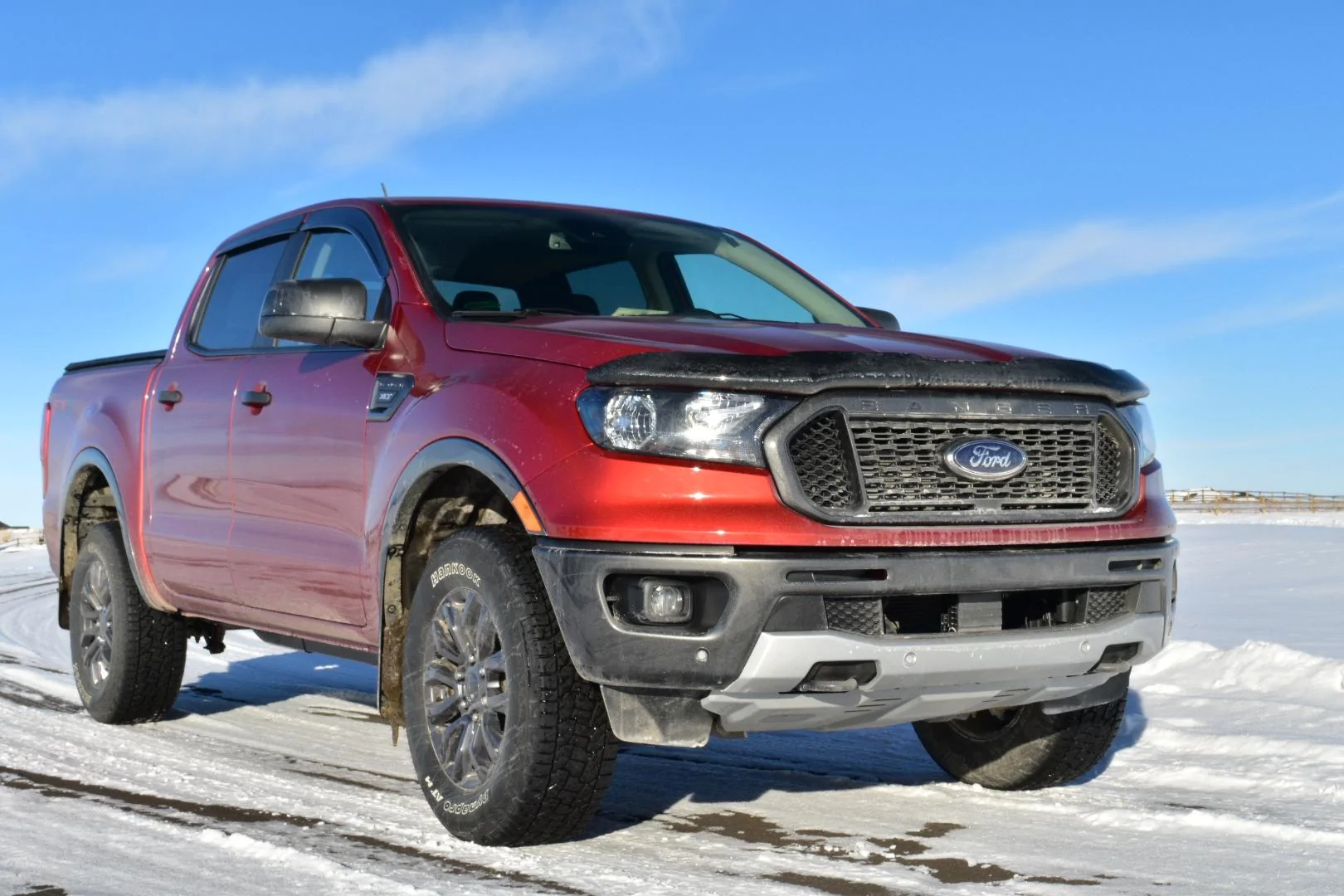

Hey all, I'm new to this forum. I've got a 2019 Ranger XLT. Today it was extremely cold in Calgary (like -40°c) and both my passenger and drivers doors refused to latch, took about 5 minutes to get the doors to latch? Anybody know what could cause this and has anybody else experienced this? Thanks in advance!
