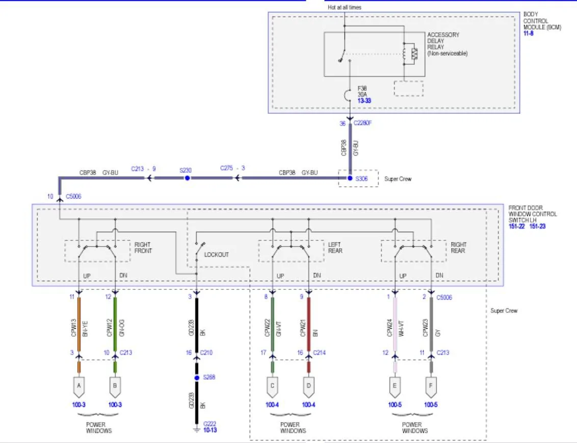

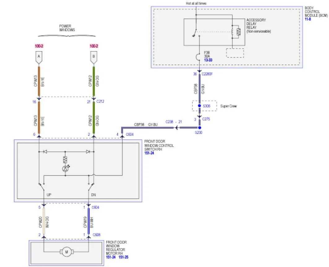

It could be a bad driver's side switch for the passenger front window or the front passenger side switch is bad, or the wiring in between. It could also be the motor for the front passenger window. You will need to use a multimeter to make measurements to determine what the problem is.

I was leaning towards an intermittent driver's side window switch or the passenger side window switch, since the right front window motor current has to flow through both switches to operate. When the OP played with both switches, the window raised.
