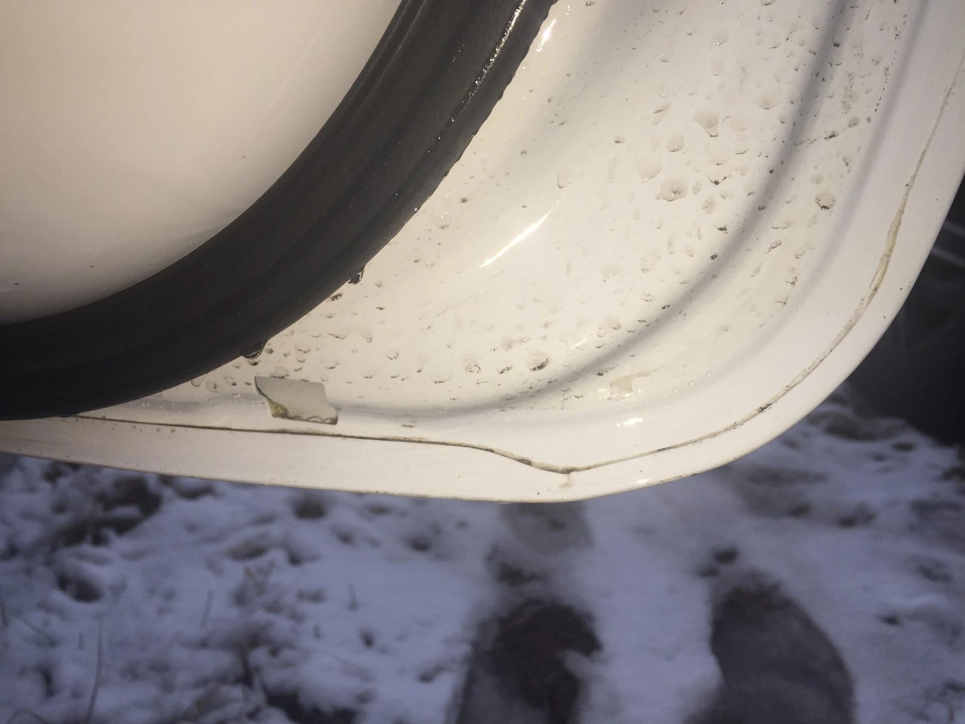

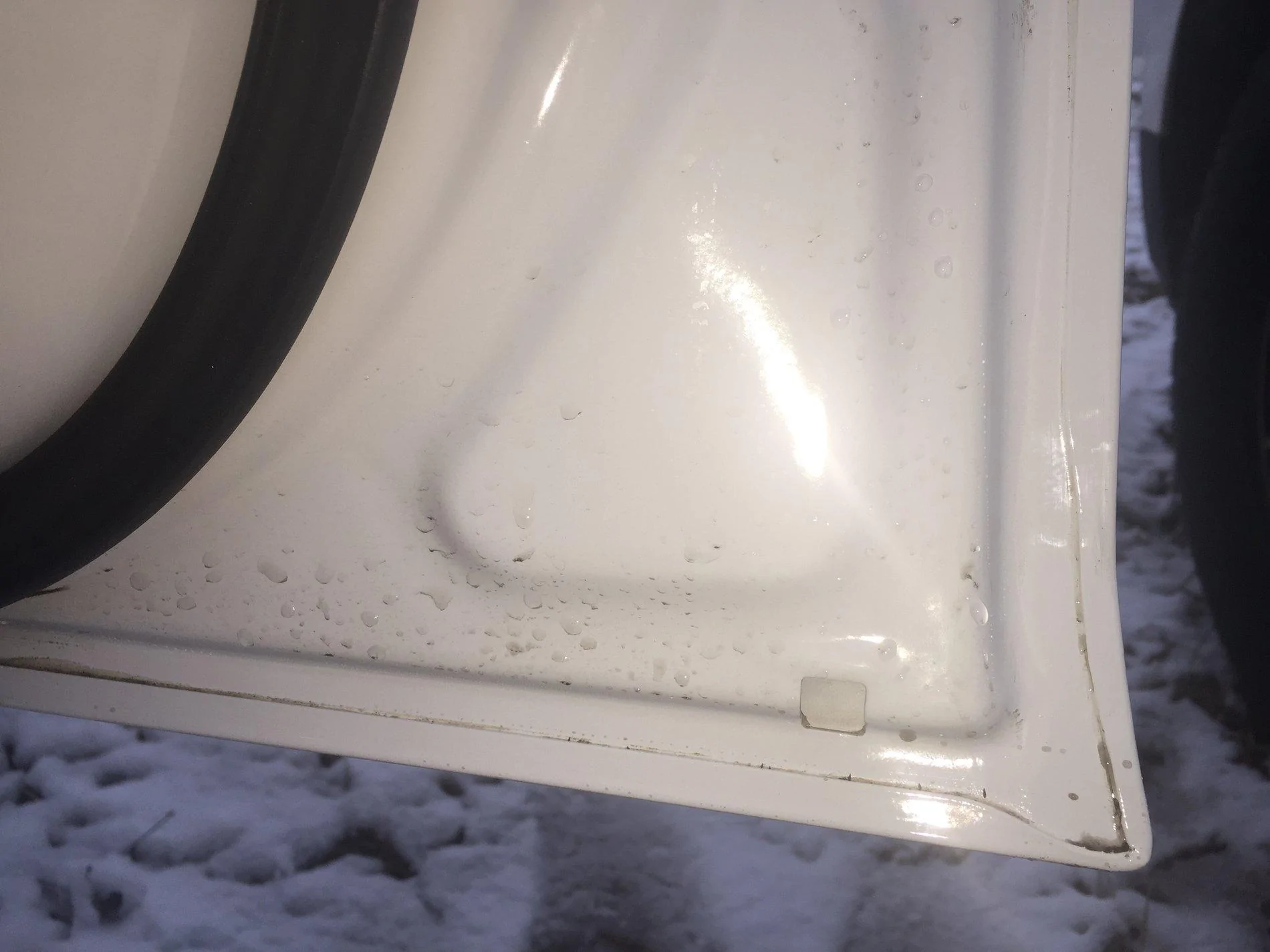

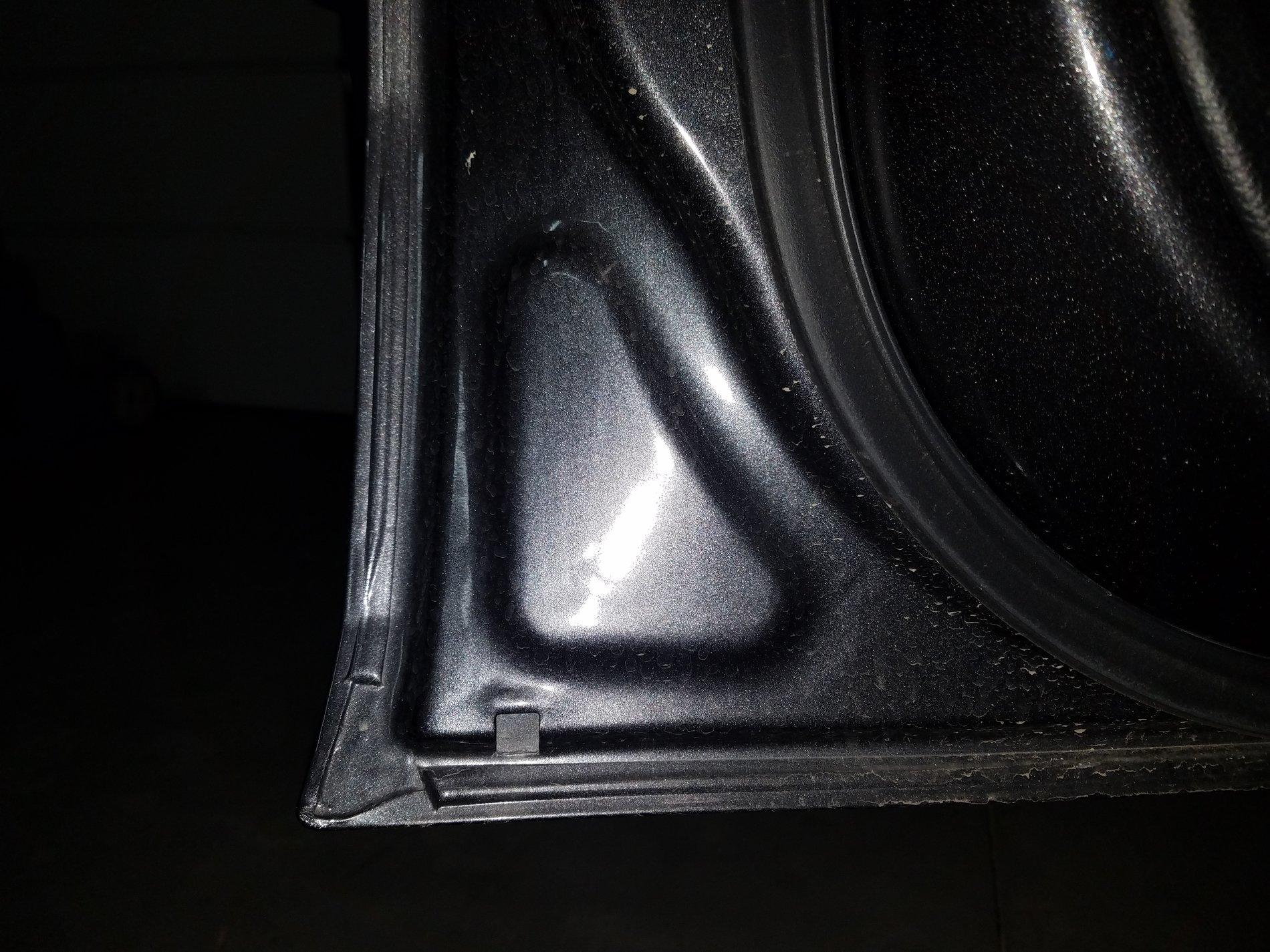

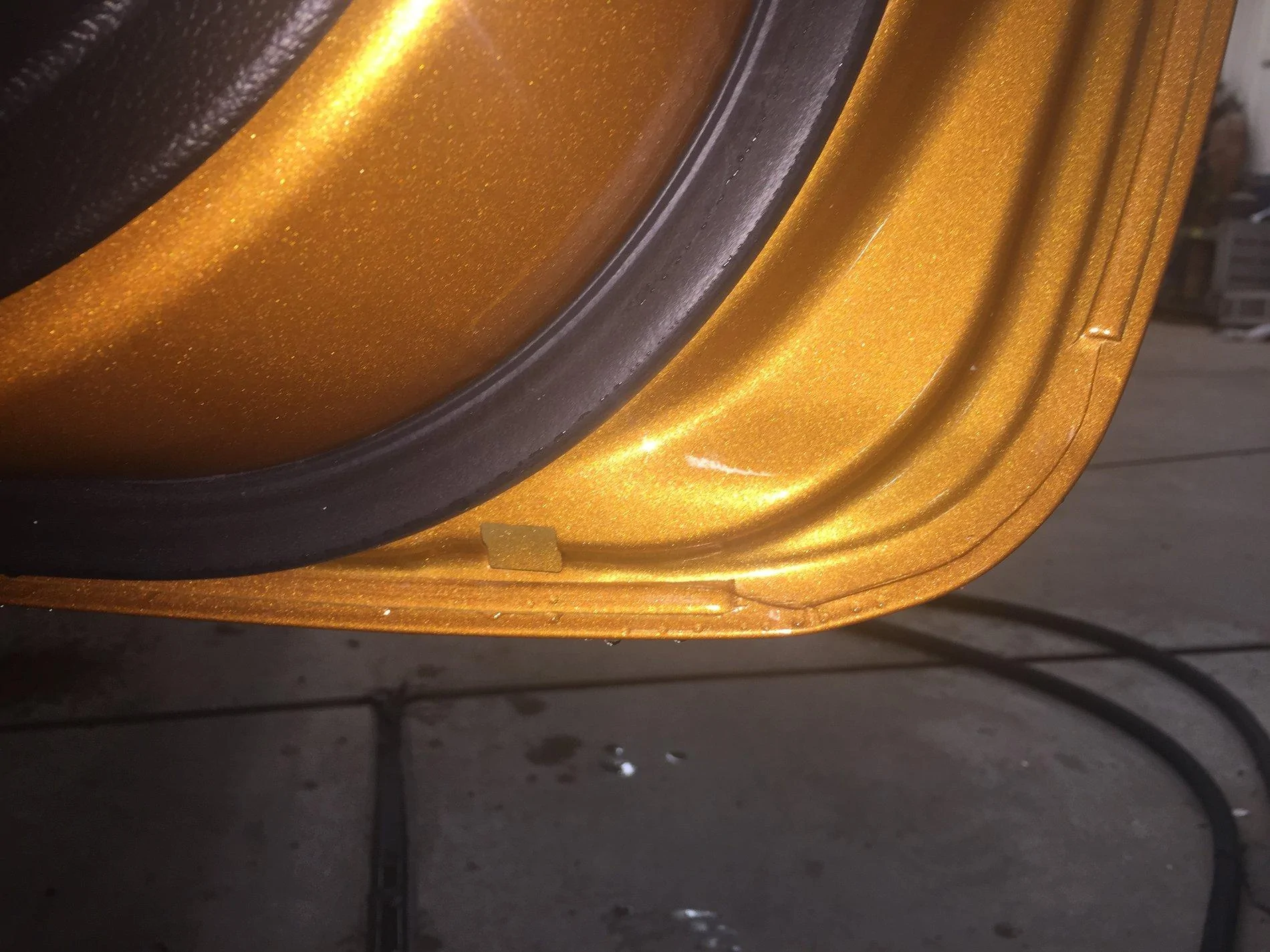

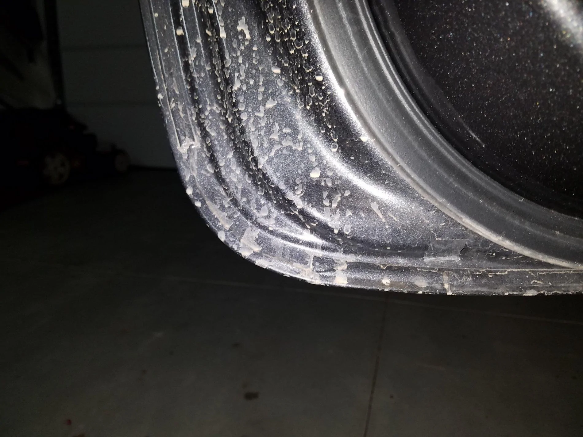

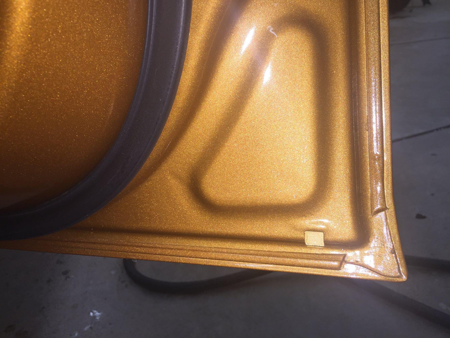

As an auto body tech I was pretty dissapointed when I got my ranger (build date 2/19) with no seam sealer on any doors. The seam sealer protects against moisture/unwanted gunk getting inbetween the skin and door frame. I figured that's just how ford was building the rangers. I just checked out a later build ranger (9/19) and all of its doors have seam sealer! Pretty frustrating to see that was skipped on my ranger, especially living in the salt belt. Attached pictures. Does your ranger have seam sealer?

I do and I see you also have a Lariat. Didn't even look until you posted this.

I just checked and I have seam sealer on my 2/19 build.

Correct, Lariat here as well. I'm jealous of your doors! The orange truck in the photos is an XLT also by the way.

Thanks for the reply. I just can't believe they would send trucks (maybe just mine) out of the factory missing something that's been standard practice for most auto makers for years now

That's very interesting. I can't be the only one out there missing it...I hope.
I'm thinking ford is going to be getting a customer service call from me one of these days.

Would love to know what becomes of this, my XLT doesn’t have any seam sealer either
