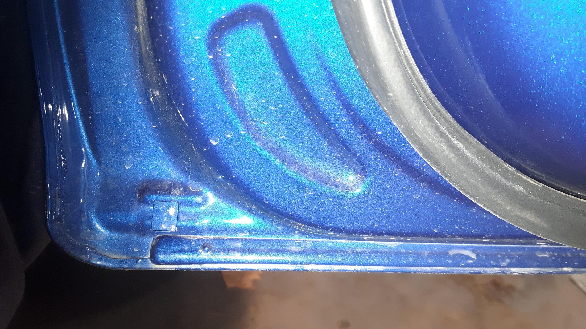

As an auto body tech I was pretty dissapointed when I got my ranger (build date 2/19) with no seam sealer on any doors. The seam sealer protects against moisture/unwanted gunk getting inbetween the skin and door frame. I figured that's just how ford was building the rangers. I just checked out a later build ranger (9/19) and all of its doors have seam sealer! Pretty frustrating to see that was skipped on my ranger, especially living in the salt belt. Attached pictures. Does your ranger have seam sealer?
OK, maybe a newbie question but I cannot tell how to know if it has seam sealer or not? Can you use arrows to show one with and one without?

Update: Ford called my dealer and gave a conditional approval for refinishing the door jams and adding the missing seam sealer. We had to provide pictures and references of other Rangers with the sealer to compare. Ford said they are having issues with Sean sealer consistency between trucks. So all is good :thumbsup:

What does "refinishing the door jams" mean? Will the retrofit be as good or better than what should have been done at the factory?
Thinking this through.. why is seam sealer needed? To prevent moisture from wicking into the open seam. If it isn't applied at the factory, applying it after the fact won't yield the same result..... since the truck has been exposed to moisture.
I'd be asking for a lifetime rust warranty on the doors.... or a truck buy back...
Ford having issues with seam sealer is no excuse for you to have a truck that is more suspect to have rust issues.
