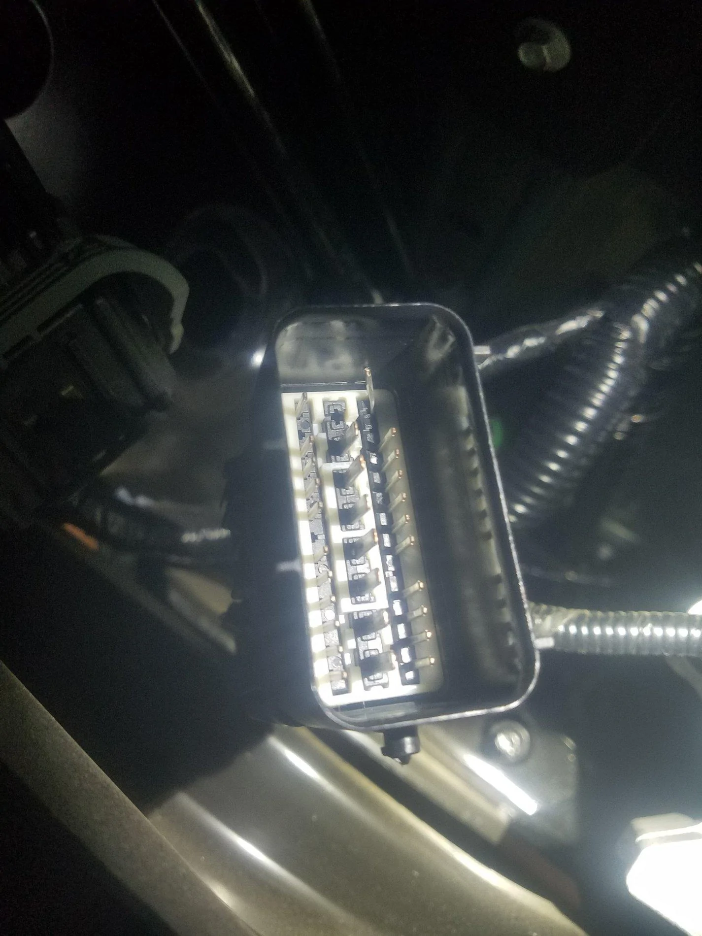

Here is one that i diagnosed today. It did not have the recall but was in the same connector. Pin 1 is folded over.

@Willcuts93 do you have any idea how this is happening during assembly? Are there robots that plug these connectors in, or humans? Just curious as to how pins get completely bent like that when most connectors mate very nicely, and if a pin is misaligned, it is usually very difficult to get the connectors to mate properly and click together.
I have no way to know for sure. My best guess is a machine that was out of alignment, either during manufacturing of the harnes or when the connectors are joined together.

I looked through the dealer bulletin again and it appears that it was pin misalignment during manufacturing of the harness. Whether that means they were installed incorrectly or assembled with bad pins I'm not sure. Here is that section copy and pasted.
REASON FOR THIS SAFETY RECALL
In some of the affected vehicles, terminals in connector C422 may be misaligned and may have been
damaged during assembly. If a misalignment occurs and terminals are pushed out, there may be a loss
of functionality of both the left and right rear tail lamps. While the center high-mounted stop lamp
(CHMSL) will continue to function ensuring some level of stop lamp indication, all rear tail lamp features
will not function. This includes the stop, turn, rear position, and reverse lamp features. This condition
may be intermittent.
The C422 connector is a 34-pin inline connector and is located on the 14290 to 14405 harness mounted
to the left frame rail around mid-vehicle.
